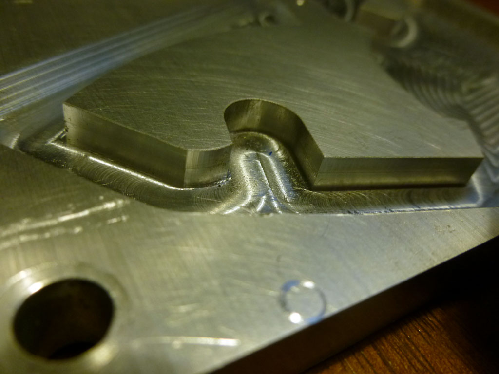

    Hi all. I was machining a bit of 6082 T6 over the weekend and I thought I'd try a new 5mm, 3-flute carbide roughing cutter. I've read a lot about how you shouldn't shy away from using more of the cutting area of the tool and how it actually prolongs tool life by working the tool etc. - I can understand why this ought to be true but somehow I can't see myself getting anywhere near these setting recommendations from FSWizard:
    http://zero-divide.net/index.php?pag...ool_id=2680705
    ..so that works out at a feed of 16mm/sec for slotting. Here's a vid using the above parameters but feeding at 10mm/sec:

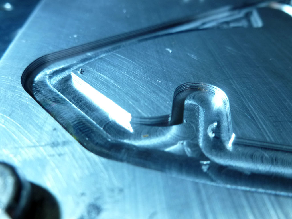

    It was doing alright for a while, but shortly after I finished recording it got a bit melty when plunging into a small pocket... I reverted back to conservative settings that work for me - here's an example at 7mm/sec - DOC 1.5 - AIR & WD40 to cool:
    Less than half the recommended speed - if you turn off the 'slot/pocket' option in FSW and use a 40% stepover, then the feed jumps to 30-odd mm/sec which just seems mental to me.
    So a couple of general questions - are these quick speeds really intended for bigger (pro-level) machines running flood cooling etc (not just the odd squirt of WD40)? Secondly - what about the rule of thumb that you really don't want a depth of cut more than a third of the tool diameter - how true is that in the context of going deep and keeping the tool happy by giving it some work to do?
    I like the idea that there's a formula for every eventuality, but much (if not all) of what I cut is by feel. is it unrealistic to expect to be able to use the numbers from tools such as FSW on home-built machines?
    Wal.
    So many variables with cuttter quality, material etc and Each machine is different so much of it is trial and error so I don't put much stall in FSW.
    I find to get gauge of the tooling and machines capabilty's it's worth sacrificing a cutter or two and some material by running tests at different DOC and Feeds. Your ear and senses along with machine will soon tell you if not happy. Bit of trial error and you'll find the sweet spot for your machine.
    Don't be afraid to use larger tooling either I find 8mm works best in ali. Can cut deeper and make bigger chip which lowers chance melting. Reason you got melting with 5mm was chip thinning because didn't cut deep enough. Thin chips heats up melts then sticks to cutter. Thicker chip doesn't melt so easy and heat leaves with chip. Problem with smaller tooling is it's fine line between cutting right and wrong resulting in much easier breakage or gumming. It's also more critical you clear chips but at same time harder to clear chips when cutting deep due to narrow slot so loads of air/lube is needed.
    Clearing chips and Lube/Cooling make big difference and looking at your Video you didn't have enough Air/lube to run those higher feeds with narrow tool, could probably gone bit deeper has well for thicker chip.! . . . Keep playing and you'll find the limit.? . . . . It's often much more or deeper than you think.!!
    Rightly or wrongly I also cut by experience and feel. If I go past my trusted F&S or DOC I can usually hear the tool loading up and melting is often only a few seconds away. This can happen quite quickly if it goes around a corner or radius.
    Pockets especially need a bit of thought - the first ramp into the new material is at full WOC, whereas once a small bit of the pocket has been cut and the current DOC value is reached then the WOC is generally 20-50% (50% is max in Vectric Cut 2D). This means that feeds and speeds are different for the getting started vs the rest of the clearance.
    I can backoff F&S so that both situations are OK and you don't get melting, but then the whole job takes much longer. Or what I do is set the feed and speed for the general pocket clearance but manually override (using Mach3 slider bar) the initial ramp and first few passes of the cut to say 30-50% feedrate until it is into the pocket properly when I slide it back up to 100%. Maybe more advanced CAM software can give you options here but Vectric Cut2D does not.
    I'm also stuck with 1.5kW spindle on ER11 (so 6.35mm max) which limits tool stiffness. I'm sure 8mm would be much better as Dean says.
    When I cut slots (or outline profiles to cut something out) these are most likely to clog up when I'm about 8mm into the part, which is a problem when the part is 20mm thick. WD40 plus clearing the chips helps, along with a lower DOC than the first 8mm.
