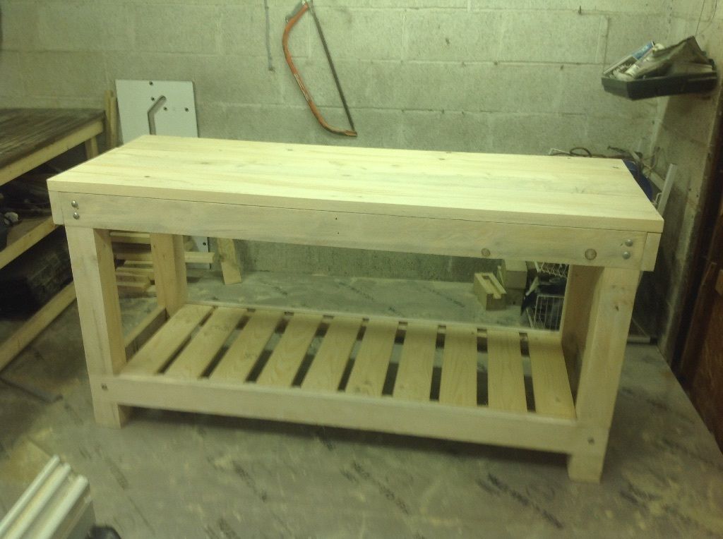

    As per my previous posts, I'm new to CNC, moving from pillar drill/etc.
    So I have a CNC router lined up, exact dimensions to follow, but it weighs in at about 110kg and has a work area of 450x875mm. It's a desktop router, so I will need a suitable workbench - right now I use the basic benches you find at BigDug/Machine Mart. Something like this one: https://www.machinemart.co.uk/p/clar...nch-with-shel/
    JazzCNC advised that this type of bench isn't strong enough. Any advice on something that's going to be sturdy enough to cope?

    I'd be inclined to make my own workbench using some suitable wood. Basic legs/frame from something like 4x2, then top it of with something equally sturdy, like 6 or 8x1.5. You could use plywood, but without lots of bracing underneath it'll sag.
    I've got a couple workbenches made from building site leftovers following the above construction, and they've handled a lot more than a 100kg!
    Off course, depending on how enthusiastically Jazz has tuned the router, you may need to add a couple diagonal braces to stop the whole lot wobbling around.
    MC I tune them to Rock whole Sheds so whimpy bench aint much challenge. .

    As have been said 4x2 frame (2x4) for the folks over the pond, with diagonal brace and 40mm kitchen worktop.

    Thanks chaps. I was famous at school for making the class' worse ever birdbox (not a solitary tit ever bothered with it when it was hung in the garden). So I won't be embarassing myself by trying to make a workbench. ;-) Sure, it looks so easy in the videos, but...
    Had a look on ebay and most don't have such sturdy legs as 4x2", but this type seems better than most: http://www.ebay.co.uk/itm/281942662716 - and I sould certainly be able to add some additional diagonals for bracing, if necessary. I could also replace the relatively thin top with a kitchen worktop, as suggested above.

    Forgot to say that the bench and machine will sit in a corner so I could bolt the bench to two sides of the unit (typical breeze-block walls), if that would help with rigidity or help to manage the machine's movements?
    That will be fine , as you say if it starts moving just but an L bracket to the wall.
    Have you priced it up at 6' x 30" wide?

    Sod cnc, i'm gonna start building work benches and nock them out on eBay, mine is 7x3 and a very similar design, material came to about £45 !!!
    Inspired by Jazz, I'll put a sign on the door; "When this shed's a-rockin, don't come knockin".
    Haven't priced it up yet, just rounded up some Ebayers who have what look like suitable benches.
    Lee - I hear you, and I'm more than happy to offer you £90 for your bench. :D
