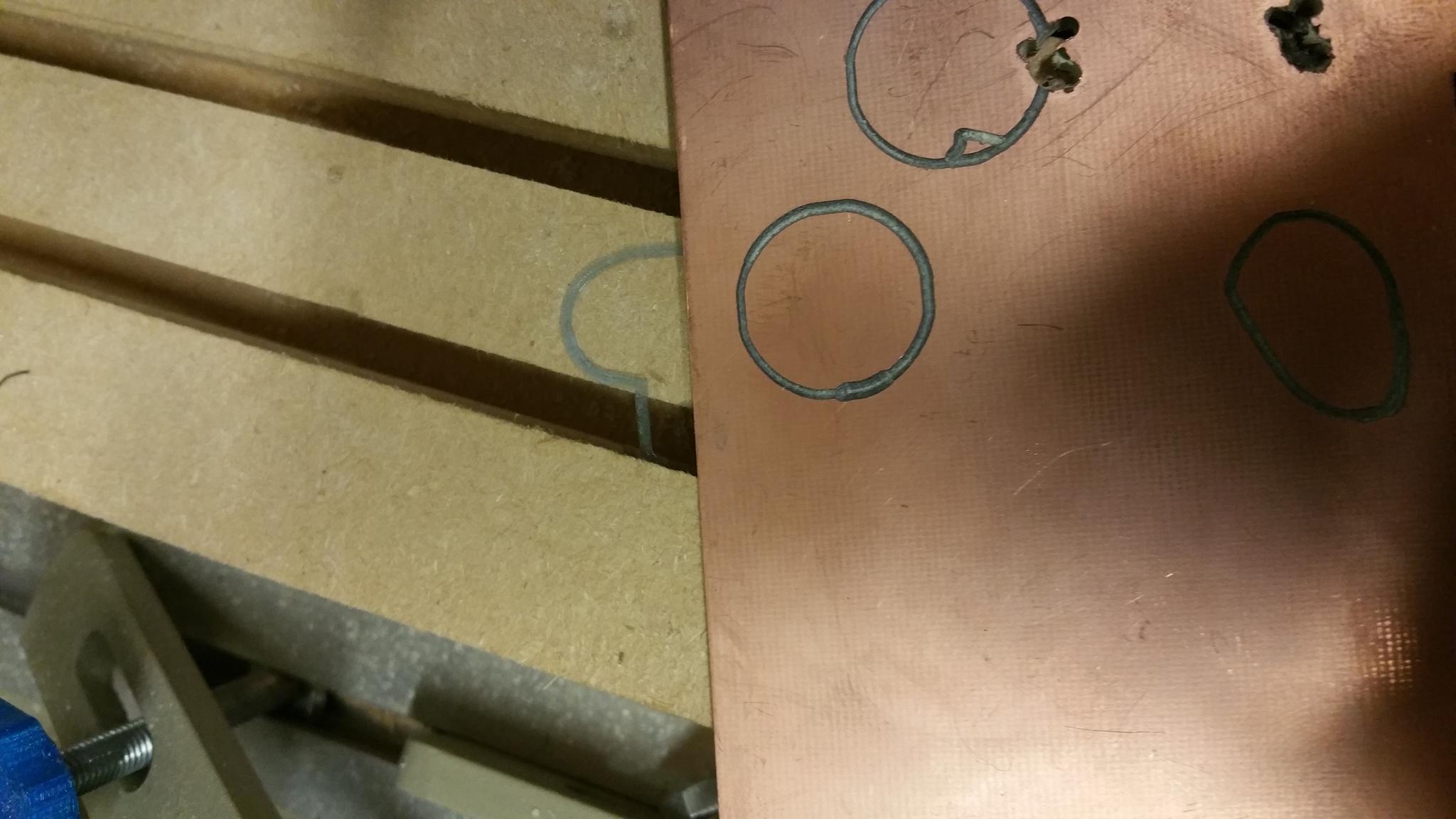

    My china 3040 does not want to cut out circles.
    I used aspire to generate the gcode and the circles come out as shown in the pic. The cnc doesnt seem to follow the line back to the start.
    Any ideas or suggestions to troubleshoot this would be appreciated.

    Others will have more experience here, but have you tried a simple square?
    Things I'm thinking - superficially, at least, it looks like you might be losing steps in the x-axis, but I don't know/can't rule out if aspire has a mach3 post-processor and/or if arcs could be causing an issue?, If you repeat the test with a simple 40x40mm square then at least you can start to understand if you're losing steps due to acceleration or max feed rate. When calibrating my machine I usually run a 40mm square with diagonals routed as well (a X in a box) just to get a visual on linearity, etc.

    Hi
    The project itself does have a rectangle section that it did cut out fine it's just not in the shot.
    I also recently ran staight grid cuts that appeared to work ok.
    If you have some gcode I could try in mach3 that's not dine in aspire that would be helpful. The circle is suppose to be 8mm in diameter.

    Something like this (below)
    40mm square containing a circle.
    Spindle speed 12000rpm, tool dia 2.5mm (not critical). DOC 0.4mm, feed rate 800mm/m, plunge rate 300mm/m

    Improvement with your mach3 settings. Not perfect but that may be the cutter i am using.

    How am i not helping myself. I ran his code but i still had issues so that.
    Once i changed the acceleration the circle cut improved. it was set to 2000 but reducing it to 1500 improved the circle.
    I'm going to run the cut again with the appropriate end mill.
