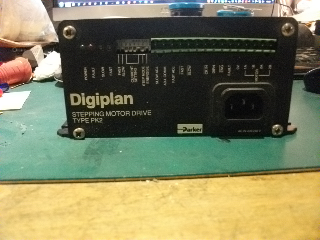

    Hey guys, I'm looking at building a rotary welding table, the mig gun will be mounted in one place while the workpiece is spinning.
    My question is, is there a way to have a stepper motor controlled by a dial so I am able to speed the rotation and also slow it down?
    Possibly a silly question but would I need to still use the driver?
    Any info on exactly what I need would be very much appreciated or some sort of schematic
    Easy with the right stepper driver.
    http://www.zappautomation.co.uk/inde...d-control.html
    Cheers pal, I have drivers just wasn't sure how to go about it.
    So do I just get one of those and a dial to control the speed?
    you just attach a pot to them. to change the speed, very simple.
    Oh right, awesome!! So all I need to do is find a decent pot, hook it up to a power supply and crack on?
    If you have drive then one of these will work for you.
    http://www.ebay.co.uk/itm/Stepper-mo...YAAOSwqu9VOTST
  8. #7
    If you have one of these, you don't need a power supply, driver or pulse generator. It is all in the box. Just add stepper and a couple of switches.
