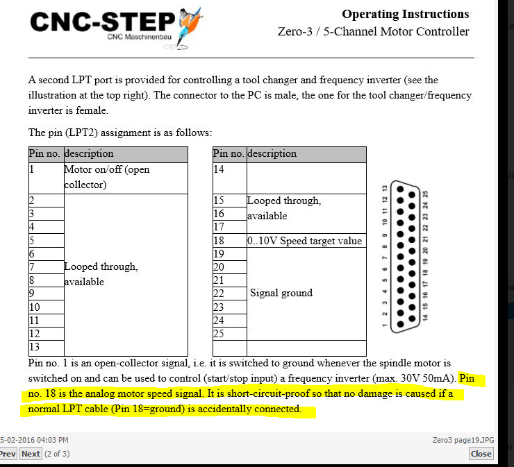

    Hi Guys,
    In advance of receiving a new Zero3 controller to replace my damaged Zero2 on my S1000-T, I have been trying to figure out how to connect my new Huanyung VFD spindle to it. According to the literature it is compatible and I have spoken to Heiz, but I just don't understand what they mean and I'm feeling rather stupid .

    I know I need to connect FOR to DCM on the VFD and also that I need to feed 0-10V between VI and ACM, but I'm unsure which ports & pins these are and what common grounds to use. It's the LPT2 & 0-10V ports that are doing it for me. Heiz tell me that I connect the VFD to both?

    The controller is a complete unit so it incorporates the breakout board as such, LPT1 input. I know that they have added an analogue 0-10V output for the VFD somewhere in the other 2 ports (LPT2 & 0-10V) but I don't understand what to connect. To me it looked like LPT2 is for a second command cable from the PC, but then there are no pin diagrams for the 0-10V port. Heiz have told me to 'connect the Inverter to the Port 0-10V and to the LPT2 port'. Am I just being stupid?
    The VI is a +ve voltage okay and I have the VFD running on it's own by jumping FOR & DCM and a 10k pot on ACM, VI & +10V. It's just the control from the controller that's causing me a headache.

    I read again what they say. So it seems from LPT2 pin 18 is the +10VDC, but you have to ask them again , where to take the - from.
    That can not be right the breakout board and spindle control to have same common ground and power supply. But maybe they made it like that.

    The Heiz controller has been configured for a Mechatron VFD. The manual is not very clear as to the 25pin port functions. The Heiz Zero3 port 'LPT2' connects to a second port on the PC (I am just using the standard printer port for LPT2 and a PCI parallel card for the more important LPT1). The port '0-10V' does then serve to supply the voltage & switching functions.
    To avoid joining the ACM & DCM grounds of the VFD, I have configured for the Huanyung as follows:
    Port 0-10V, pin 14 (constant 3.25V) connected to the 5V coil of a reed relay which is operated through switching (to ground) pin1. The switched terminals of the relay open & close FOR & DCM of the VFD
    Port 0-10V, pin 18 (+ve 0-10V) and pin 25 (ground) then supply the variable voltage to control the spindle speed between VI & ACM of the VFD.
    Configure port input I222 hood - query ready signal cabinet HF spindle LPT2 PIN 12 (for WINPC-NC)
    The Huanyung is then good to go. The only thing wrong at the moment is the spindle speed is running at +30% across the speed range but I will add a trimmer to adjust this.
