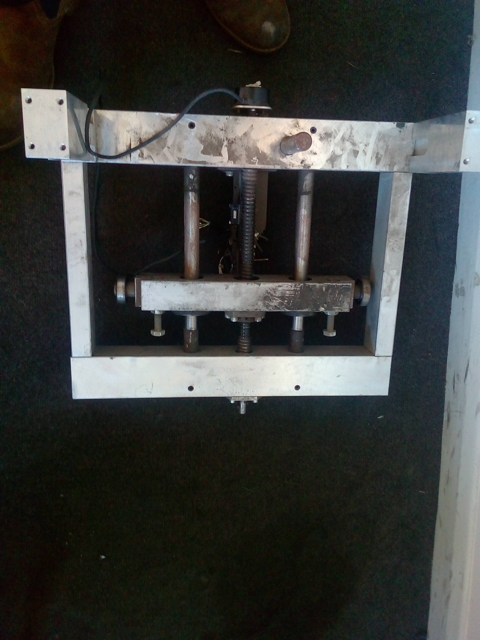

    I have to google the ones I've got because I recovered them from this thing (I have an almost identical one with no surface rust and a mint ballscrew to cannibalise for my Z axis.)
    But you cannot go wrong with Cherry or Happ microswitches, high repeat-ability and guaranteed for 10 million clicks which should be good for a few weeks lol. Should cost ~£1 to £1.50 a switch which for cnc is refreshing lol.

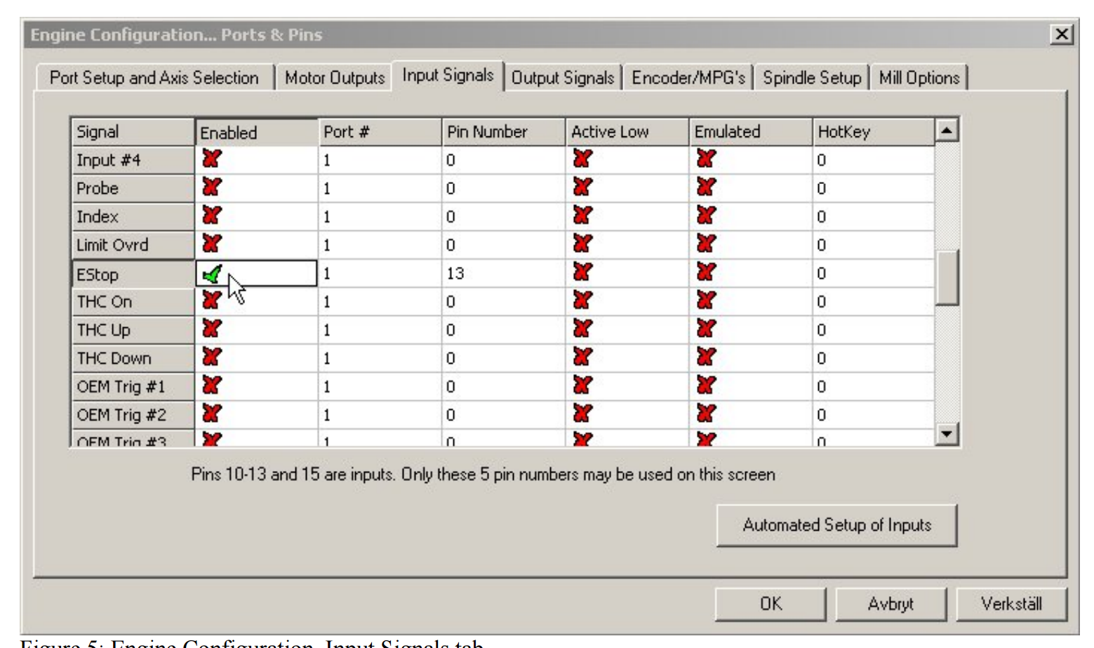

    This is the limitation (for limit switches).
    'Only 5 of these inputs blah blah' ....
    Ive actually crashed Mach 3 before by trying to use other inputs than those (for limit switches, I must stress). No problem using them for ATC switches etc.

    Getting them to work as single NC switches is fairly easy on the CS Labs / Mach 3 setup.
    Im trying to work out how to wire them in series and how to mix between limit / home options.
    Another way is to wire something via the E Stop circuit for limit switches and not actually use the 'limit switch' pins available to Mach 3.
