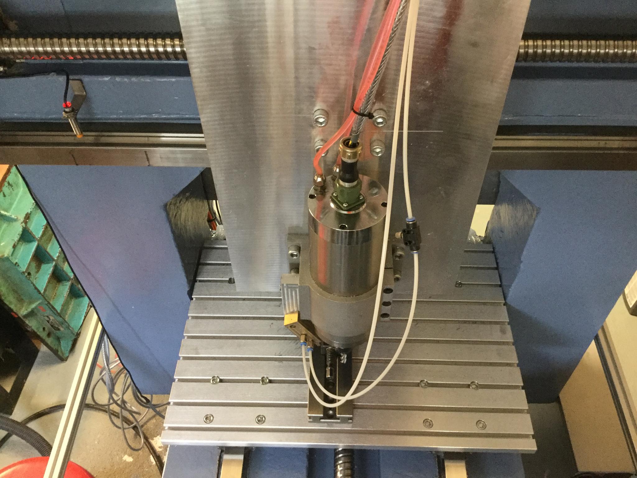

Does anyone know how to deal with dual probes, on NC and one NO, going into the same probe input?
Can I run two probe inputs?
This is the issue, how else to wire this (goes into CS Labs) input 3.

I've been thinking about exactly this problem for my own machine (also using CSMIO). I haven't built the touch probe yet but I was intending to use a simple bit of circuitry to invert one of the signals and then combine them. I'm not sure that you can solve the problem without adding something outside the CSMIO as it only has one input that is suitable for the job.

You need to invert the NC signal to NO, otherwise the probes will interfere with each other if run in parallel.
My preference is to run probes NC, as then any circuit failure triggers a stop, but then you'd either need a switch to swap between probes, or wire them in series.
Either would be possible with a transistor or two, and a couple resistors.Avoiding the rubbish customer service from AluminiumWarehouse since July '13.
