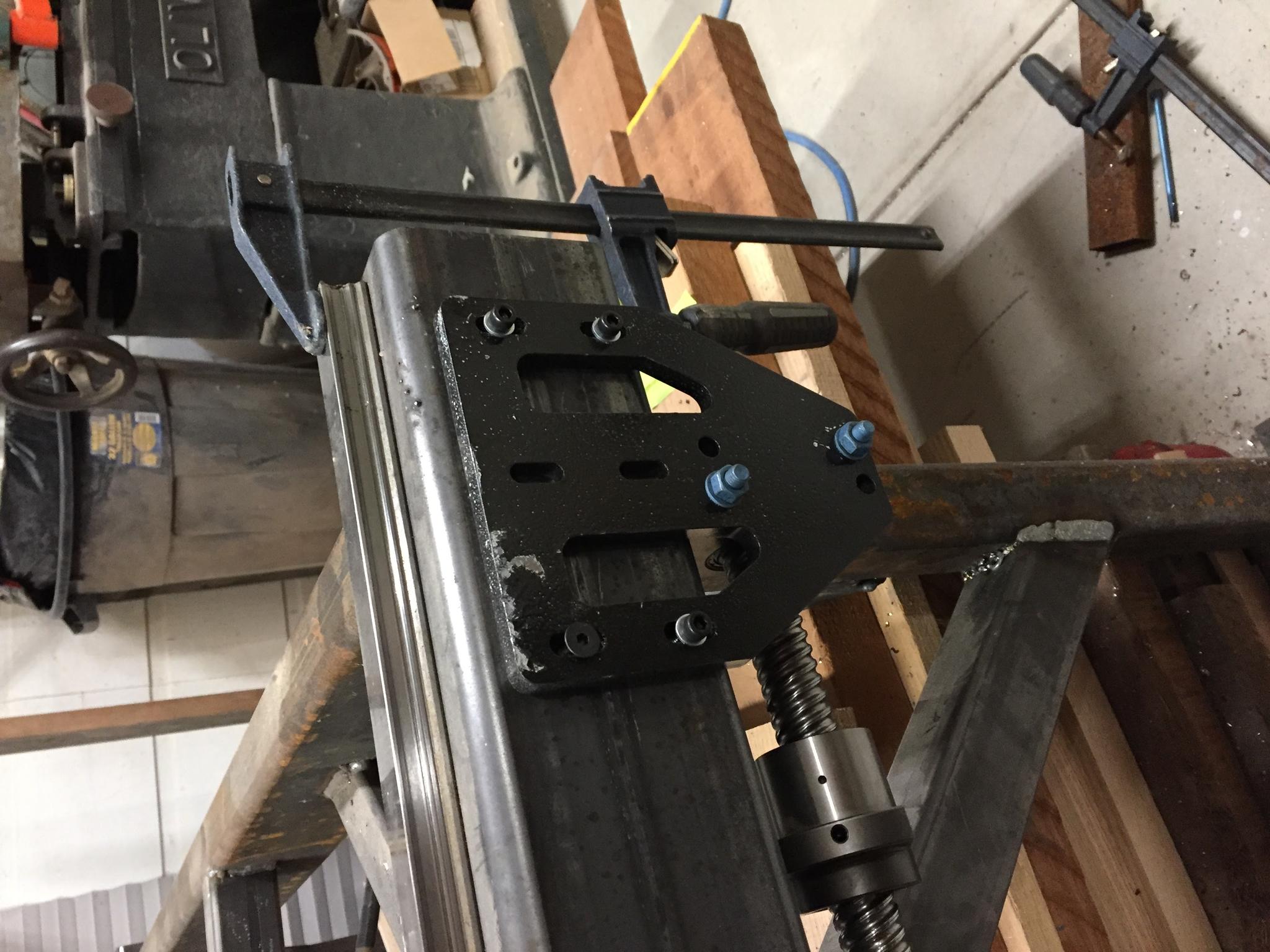

    Made a bit more progress over the weekend,
    Got one of the X axis screws mocked up
    Here I am machining the spring loaded brackets that will act as X ballscrew mid supports. These will support the screw and when the gantry goes by will move out of the way on the pivot. I need to get some shoulder bolts still for these and do a bit more machining for clearance of the ballnut as it passes (to ensure that it cant get hung up on a change of direction).

    I also got a air valve block installed on the gantry for all the air that the Z axis needs, also put a terminal block on the gantry in order to reduce the number of wires that needs to make its way back to the control. I ordered some 20 conductor shielded communication cable to go from the control to the gantry terminal block. Gives me a few extra wires incase I need any future expansions or additions.
    Im getting excited as its closer and closer to cutting. I am waiting on new toothed pulleys for the Y and X as I made a mistake when ordering, once those are in it will be time for truing and squaring then cutting.
    More to come....
