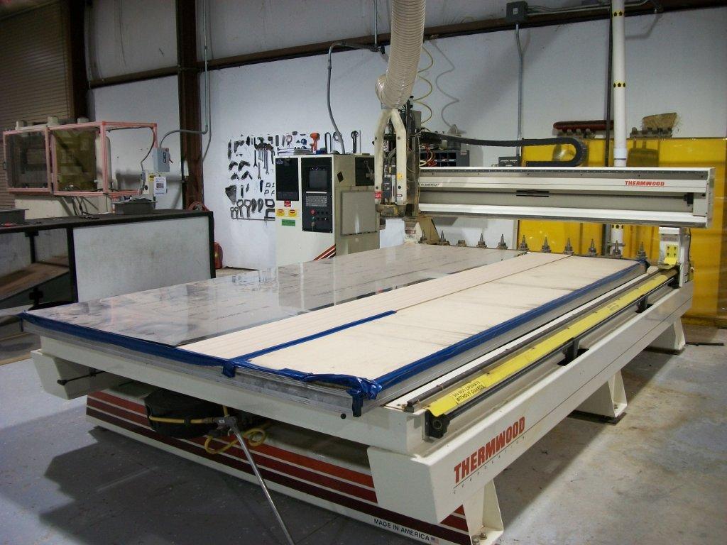

So Im looking into and learning more about long ballscrews and how to run them. Obviously spinning the ball nut is a way to go but each unit gets to be pretty costly by the time you are said and done.
Another thing I found was supports along the ballscrew which effectively push the critical speed to a higher rpm. Has anyone ever looked into this type of design?
http://www.linearmotiontips.com/achi...d-ball-screws/
Thermwood does this on the long axis of some of their CNC machines. It looks like the support flips as the ballnut passes and then supports the ballscrew again on the other side of the ballnut.
I assume these are just nylon but cant find any further details on this type of support. I wonder if it could be considerably less expensive to incorporate this, provided the same performance is achieved in the end. Thoughts?
