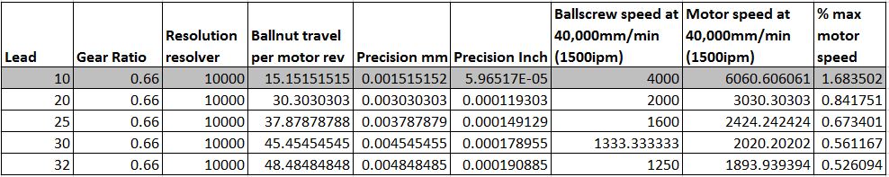

    So still learning about the CSLabs IP-A and trying to decide if the extra money is worth it. With all ballscrews, I dont know that there will ever be a time that the system could move while the drives are disabled? I.e. I would have to manually turn the ballscrew or the motor to put it out of position. However, if Mach knows absolute position does that mean that the system needs to be "homed" less often? Between cuts etc. Are there other benefits to having Mach know the absolute position from the resolver? I hope to make a decision here soon on a motion control card... If anyone has any further thoughts I greatly appreciate it.
    Thanks to Fred over at BST for working with me, I have ordered motors, 2 for X, 1 for Y, and 1 for Z. I decided to go with servo on Z as it seemed silly for the price difference to have that axis be a stepper.
    Next up is HTD timing gears/belts just need to figure out speeds and gear ratio. Thanks Boyan for posting the 20t:30t Starting point and after putting it on paper sure makes sense to me.
    So some math just to make sure I have things right
    Lets say 20000mm/min travel
    Ballnut is 5mm per revolution
    (20000mm/min ) / (5mm/rev) = Ballscrew rpm => 4000rpm
    Gear ratio 20t:30t = 0.666
    4000rpm * gear ratio => Motor Speed => 2666rpm.
    The motors I purchased from Fred are 3000rpm so this looks reasonable to me.
