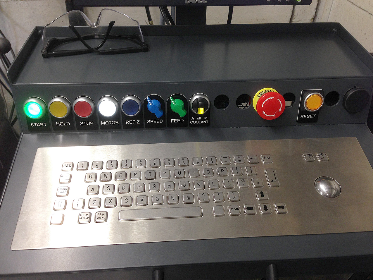

    Got the panel finished, just need to find a few blanking plugs

    Ah ah just bought 2 of those KB of flee bay.

    Very nice again Dave. How come you did not put some grad marks on the feed and speed
    I have made a few for mine but cut them out just with the 60' V cutter. Saves changing tools.
    Did you use Bold Arial

    Grad marks would be meaningless i thought as its based on the screen display not any real position so i didn't bother, i can always redo them i guess one day ;)
    Yes it was Arial Bold and a v-carve path
