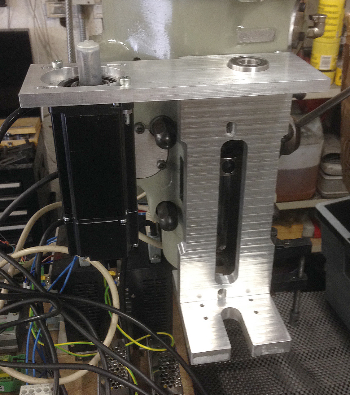

    Dave, have you get any pictures of the existing setup/quill?

    A few pics here...

    The weak spot is the joint between the coupler and the quill - there is a flat recess milled on the quill about 15mm dia and i picked up on that face, it really needs more contact above and below the bolt but then you lose more z axis travel and thats bad enough already.
    Its the little round boss on the right of this part...

  3. #263
    Lives in East Lothian, United Kingdom. Last Activity: 8 Hours Ago Forum Superstar, has done so much to help others, they deserve a medal. Has been a member for 9-10 years. Has a total post count of 2,910. Received thanks 360 times, giving thanks to others 8 times.
    How much Z travel would you lose, if you bridged between the current single bolt mounting, and the end of the quill (where you currently clamp on the second spindle bracket)?
    If you were to bridge between the two, then you should get a stable piece to then mount the ball nut to.
  4. #264
    I can see where you are coming from here, nice idea and would certain strengthen it 100%.
    But as always there is a negative - it would stop me being able to fit the aux spindle.
    By having the support on the end of the quill when running as a normal bridgeport, I would maybe lose 12-15mm of travel - not too bad. But to allow me space to fit the aux spindle as well below it, the support would have to be that much further up the quill, probably losing 40mm + of travel permanently - this would cause big issues when doing normal work.
    But it is a nice idea though.
  5. #265
    Rework the Aux spindle mount, so it attaches to the new adapter?
  6. #266
    It's possible, the main draw-back is the loss of the already limited Z travel when doing normal work - this is a big pain in the wotsit really. Not so bad on the aux spindle as all the tools are so short as is the work itself.
    To make it really work would need the knee setting up as an axis and diverting all tool-length measurements to that axis - this would mean cutting is done on the quill but the loss of travel would not be as serious.
    I still feel the quill rack is a way forwards, won't cost much to try at least.

  9. #269
    Quill drive idea mk1,
    gives a 16:1 reduction, takes up little space, mounts to existing threaded holes on left side of head.
Name:	dk untitled.jpg
    Should allow both belts to be tightened by having only one moving shaft.
