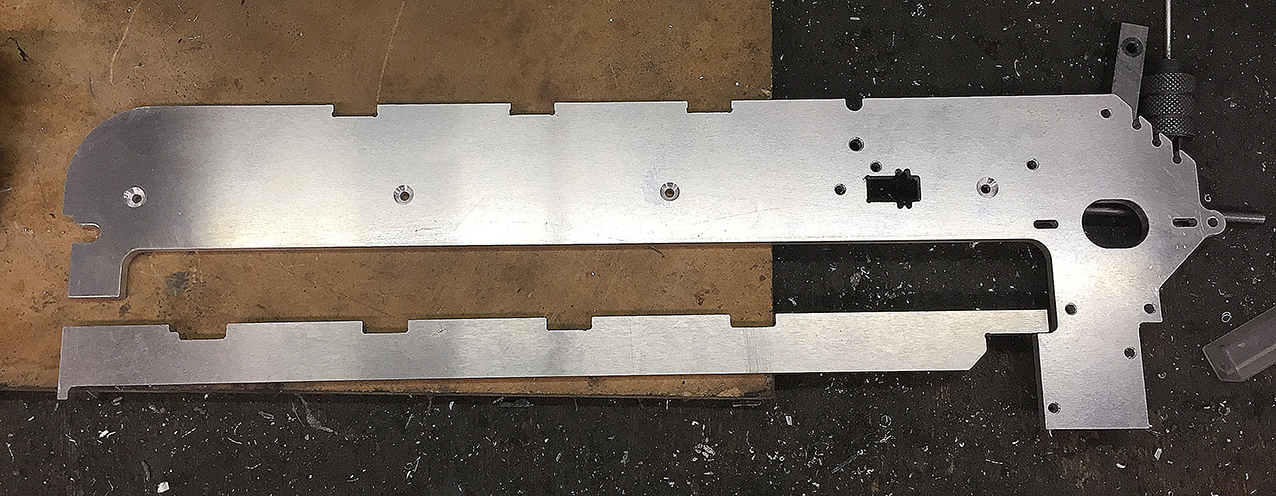

    For those who don't know, my Bridgeport was rebuilt with servos and larger motor, plus i added an auxiliary high speed spindle for aluminium work. The job in hand is shown in the pictures below, 5mm Aluminium, lots of holes and intricate features. I use 2mm single-flute and 5mm single-flute carbide tools for these.

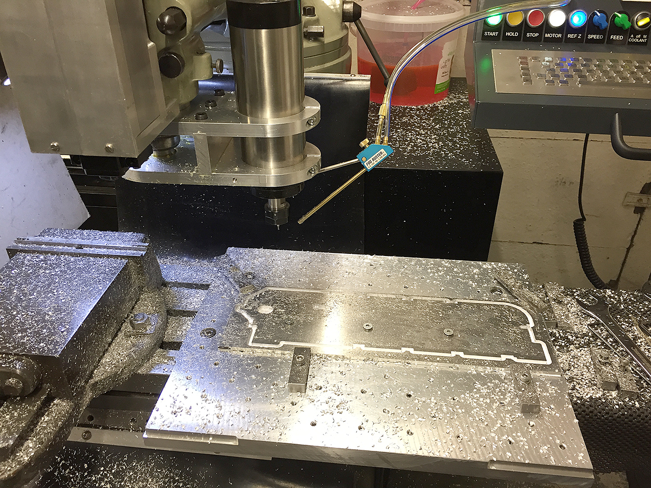

    Now, when doing these on the Bridgeport, I am seeing bad vibration or chatter on the tool, it appears to be vertical oscillation but tonight also suffered bad enough radial oscillation to break a 5mm tool ! When it goes into oscillation it makes you jump as its very noisy and you instantly know it will end badly either in poor finish or broken tooling. Tonight I was testing tool sent from my supplier as a "Better" option this was a two-flute carbide, probably the reason for the breakage as two-flute tools need a more rigid setup.
    So, something is not happy - my reservation is the spindle mount (shown below) - its canted out over to one side and although it's clamped to the quill and into an R8 collet in the main spindle, it must be allowing deflection from the cutting forces.

    The first thing that springs to mind, is how much play is in the quill?
    By bolting onto the quill the way you have, any play in the quill will be greatly magnified at the second spindle, so it's probably not taken much extra wear to go from tolerable to a problem.

    Ok, did some tests, first was to measure slack in the z axis at the adaptor in line with the high speed spindle - I have 0.02mm vertical (with reasonable force) and 0.15mm rotational around the quill - no doubt the source of my trouble.

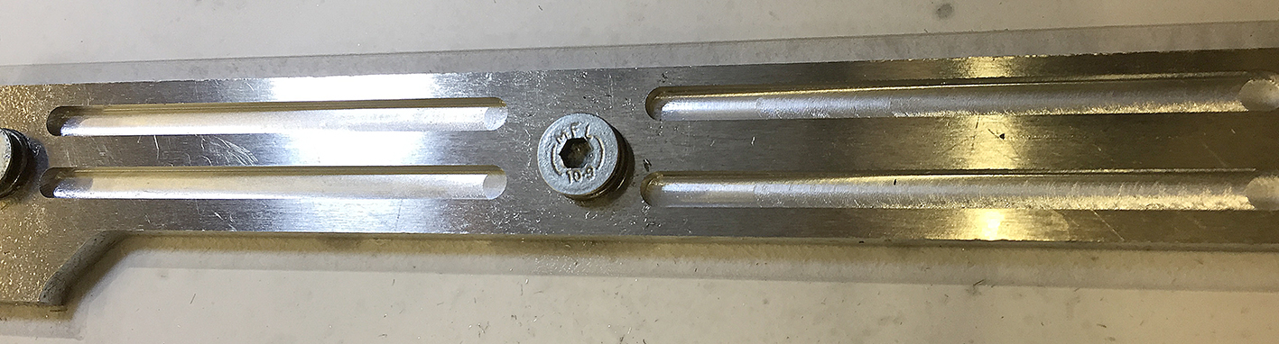

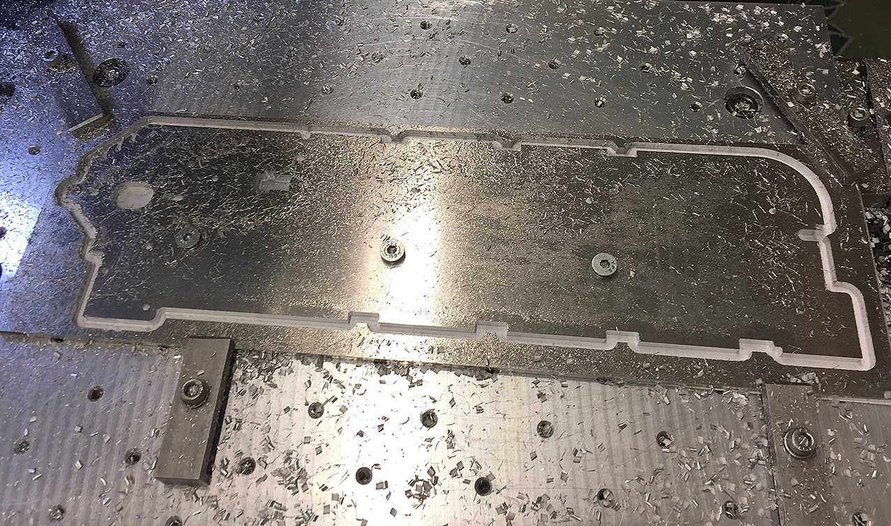

    Left cuts in the first picture below was at the feed recommended by my S&F calculator shown in the last post, 2 passes of 1.25mm ea, top cut is with me applying pressure to the motor while cutting to remove slack, the lower cut is with it running free as normal.
    Both cuts look fine, no burr on the lip and pretty much perfect.
    The right cuts in the first pic show results of a single 2.5mm DOC pass, same feed rate, again with hand pressure on the top pass and free on the lower.
    Both cuts are acceptable this time but they show signs of vibration on the bottom surface - this is not an issue here as this tool is a roughing tool and will cut right through on these parts.
    the second pic is just a closer view of the vibration on the second cuts.
    Seems I just have to back off on the fast pedal a bit and let her do her thing, plus fit a bungee cord to remove the slop.
