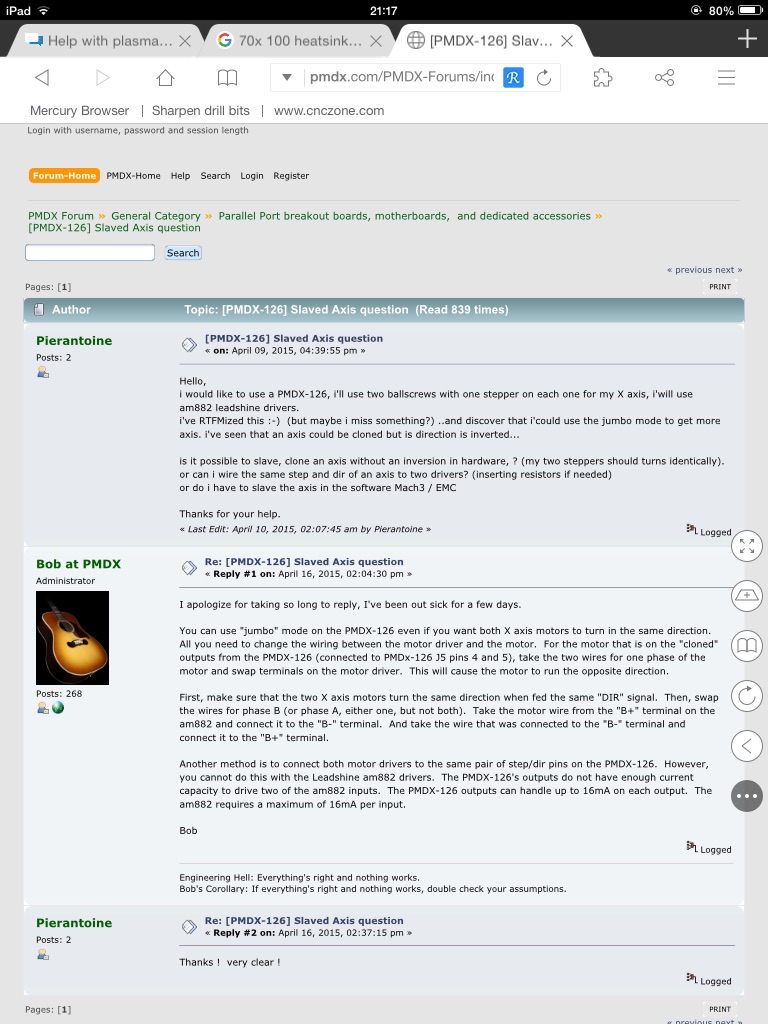

    Have you got two motors on one of the axis if so will the Pdmx board support slaving?

    yes I have two motors on 1 axis and yes I'm sure the pdmx supports slaving

    the pmdx 126 can only be slaved if used with pmdx 134 I think

    I don't see in the manual re the 134 slaving it just looks like a breakout board for the gecko.
    An axis can be cloned but the direction of the clone is the opposite directionso phases need switching Click image for larger version.

    Quote Originally Posted by Lewywri89 View Post

    Ok if you are happy BUT can you home them individually to square the gantry!!!
