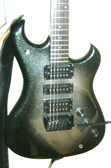

    you can also spray them yourself. If you haven't got the kit, then cans will do the job. I would recommend that a car sprayer lacquers them with 2 pack for durability, but it would probably work out cheaper to just buy the doors.
    I restored my guitar a couple of years ago and sprayed it black with a sunburst of silver flake and a candy black edge. After a coat of lacquer it polished up well. It looks a lot better than the sorry state it came back to me in (after a long term lend).
    The shapes you see in the front are reflections of the staircase it hangs in.
