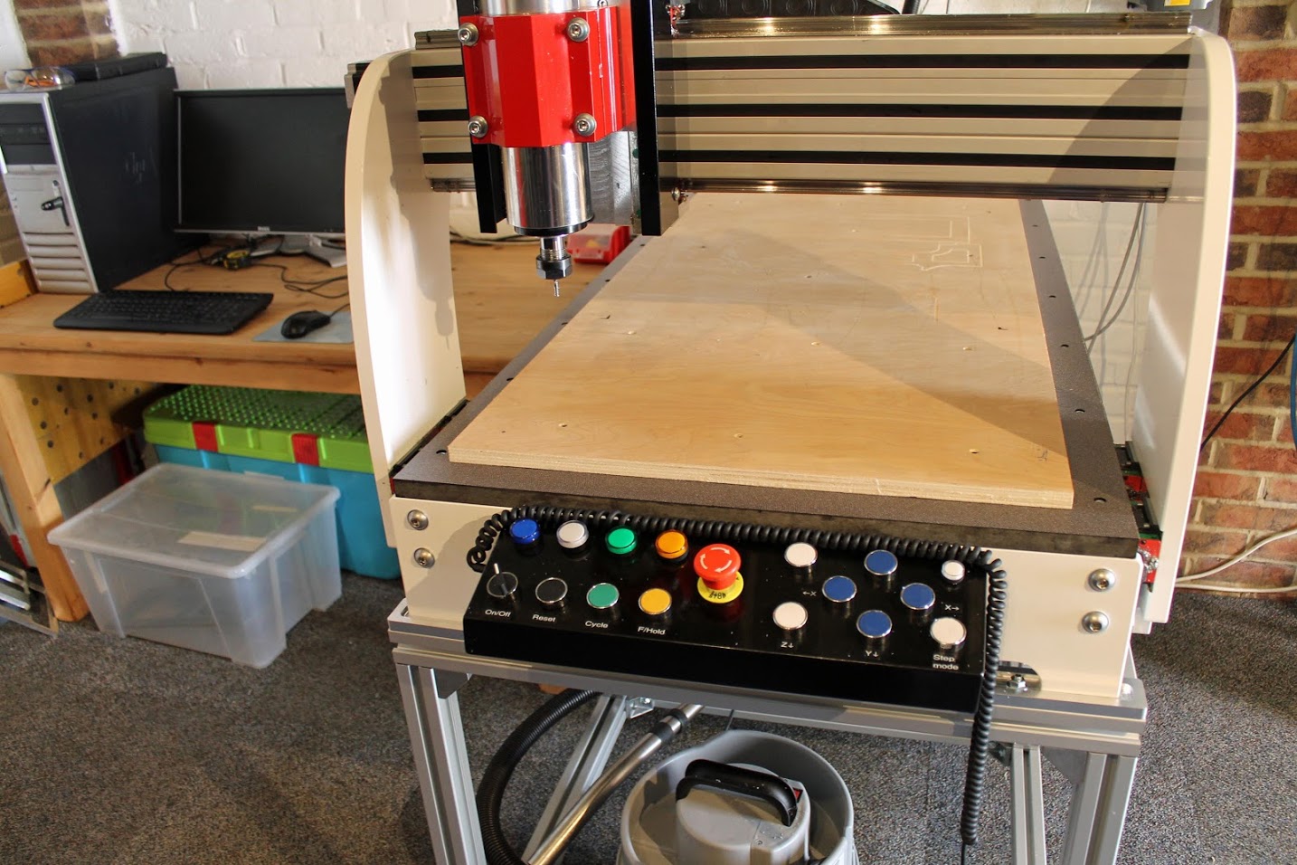

I want to add some push buttons to my operator panel. Mainly Stop, Pause and Start. I have the wiring sorted out but this is what I wanted more info on. If while running a program I press Pause do I need a Resume button as well or will the program continue with cycle start?

Cycle start is the same as resume. Only need Cycle start, Feedhold, Stop.

Thats great, thanks Dean. I couldn't find the info when trying to search for it yesterday. Now I know how many buttons to order. Joystick controls all working now though.
