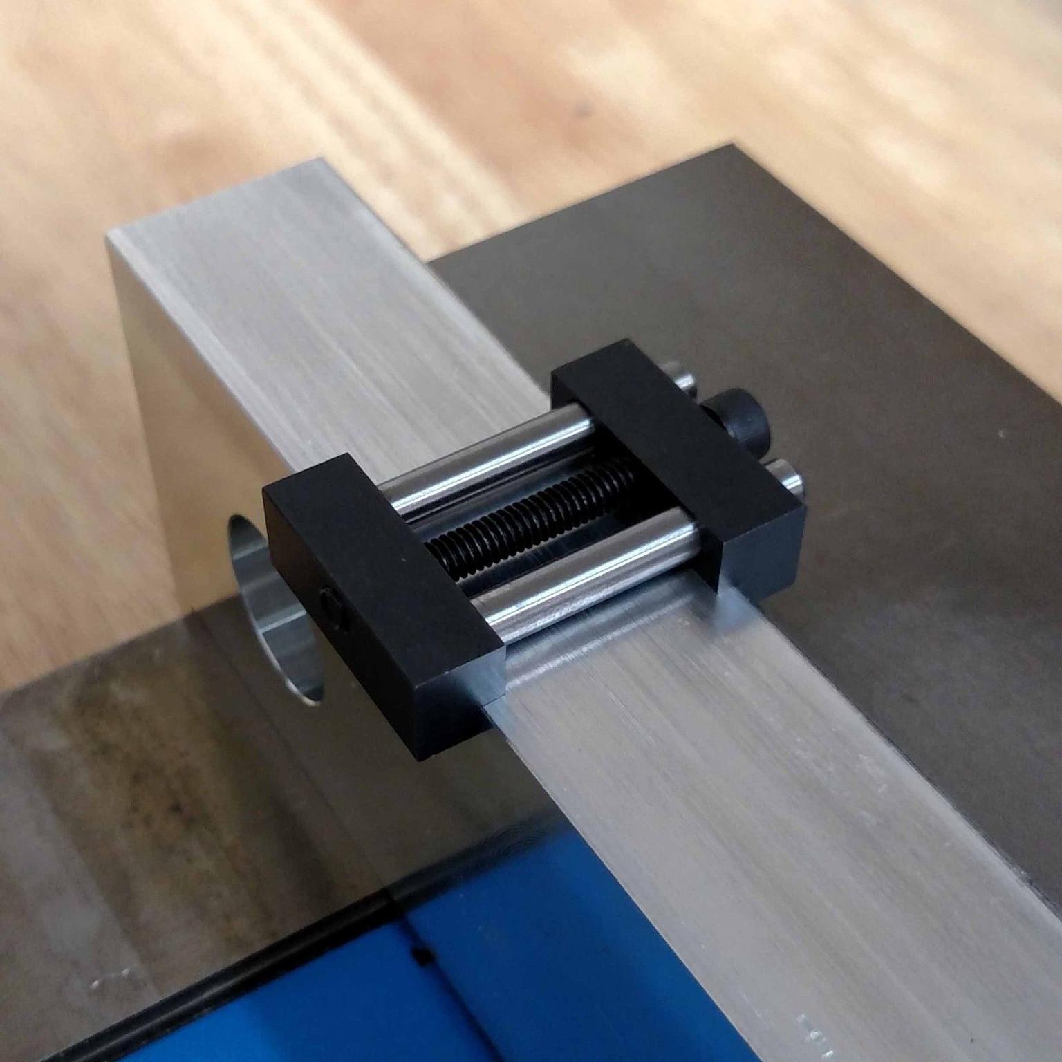

		When a machine is constructed correctly and precisely even moving with hand left screw / or nut in case of rotating nut/ moves easily gantry front back. When i say hard stop i mean a clamp or sth to be as a stop  guide at end of the rail/ if there is a place.
Vice stop locator on ebay. Imagine that is clamped at the end of the rails both one side so that when machine hits it gantry is straight square. there is a proper element in the Hiwin catalog but can not find it or remember its name. Definitely not rubber, as we are talking squaring gantry
