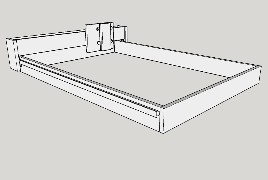

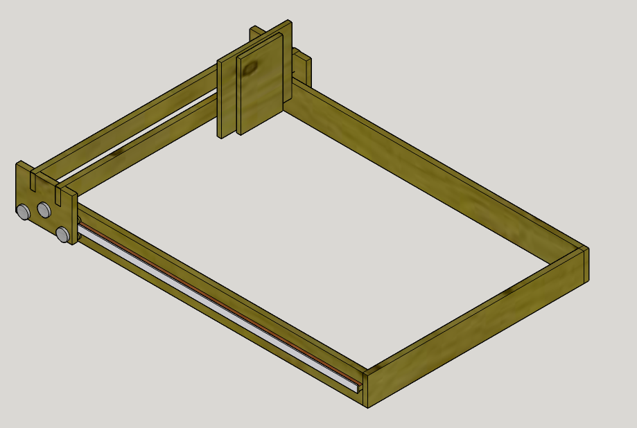

Attachment 20178
Real Crap Basic idea of what i'm looking to do.
In regards to general shape and approx motor placements, bearing guides etc.

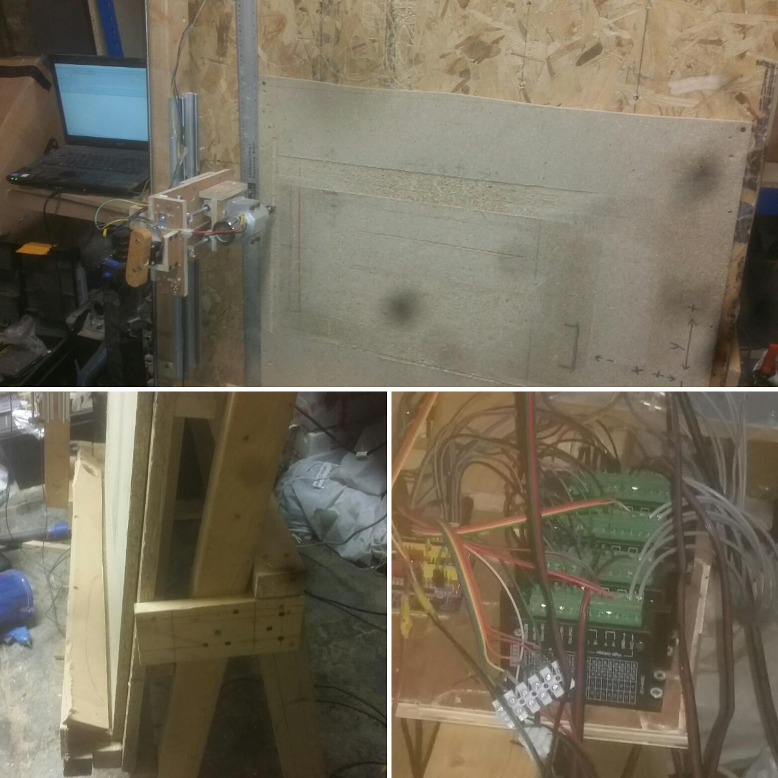

My end goal is to have a vertical sheet sized machine (not any time soon)
I'm prototyping with ply (had plenty) but have seen them seemingly made from MDF and sold?
So i'm aiming for some sort of inner repeating pattern to establish rigidity without excess weight.

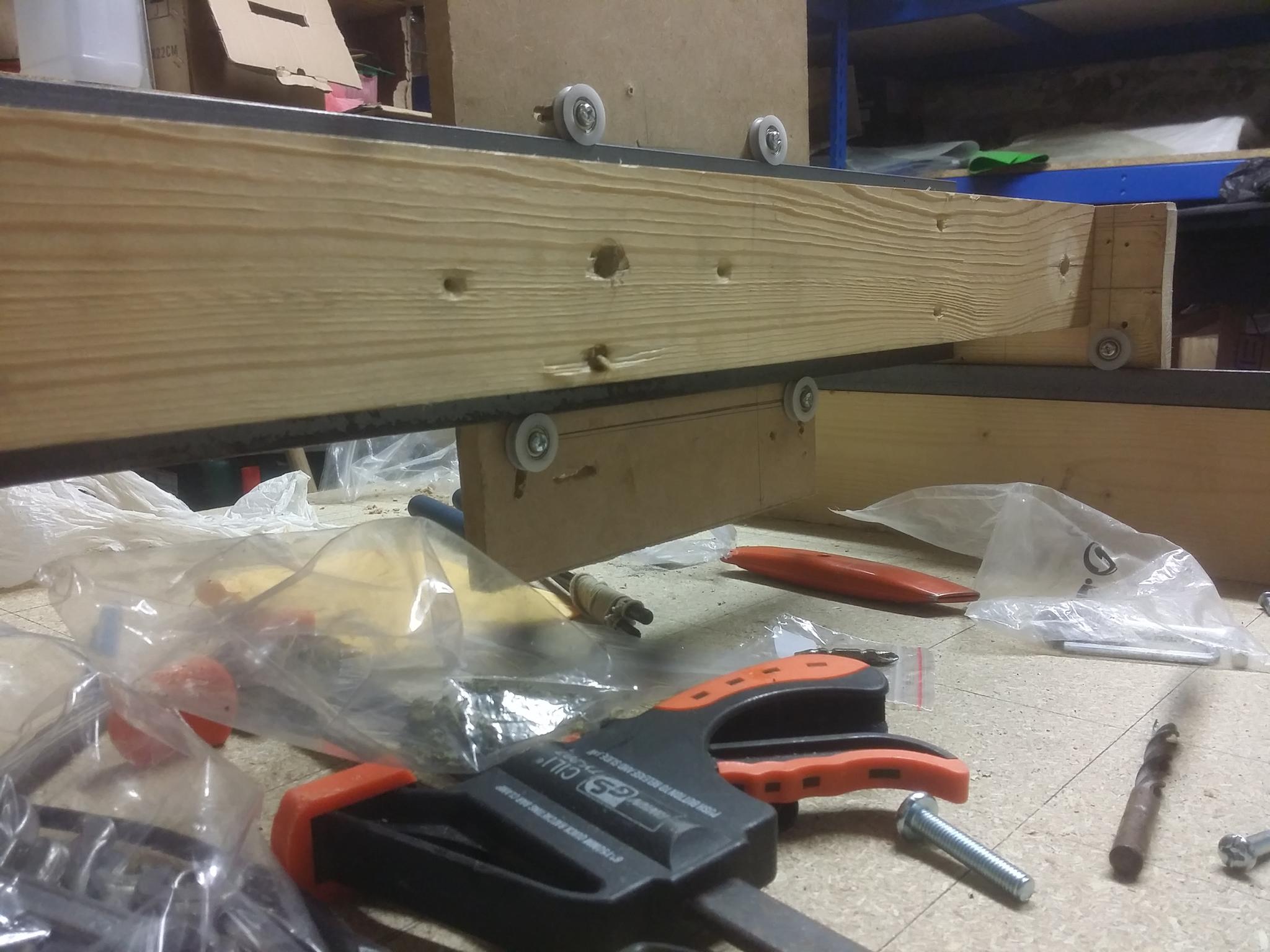

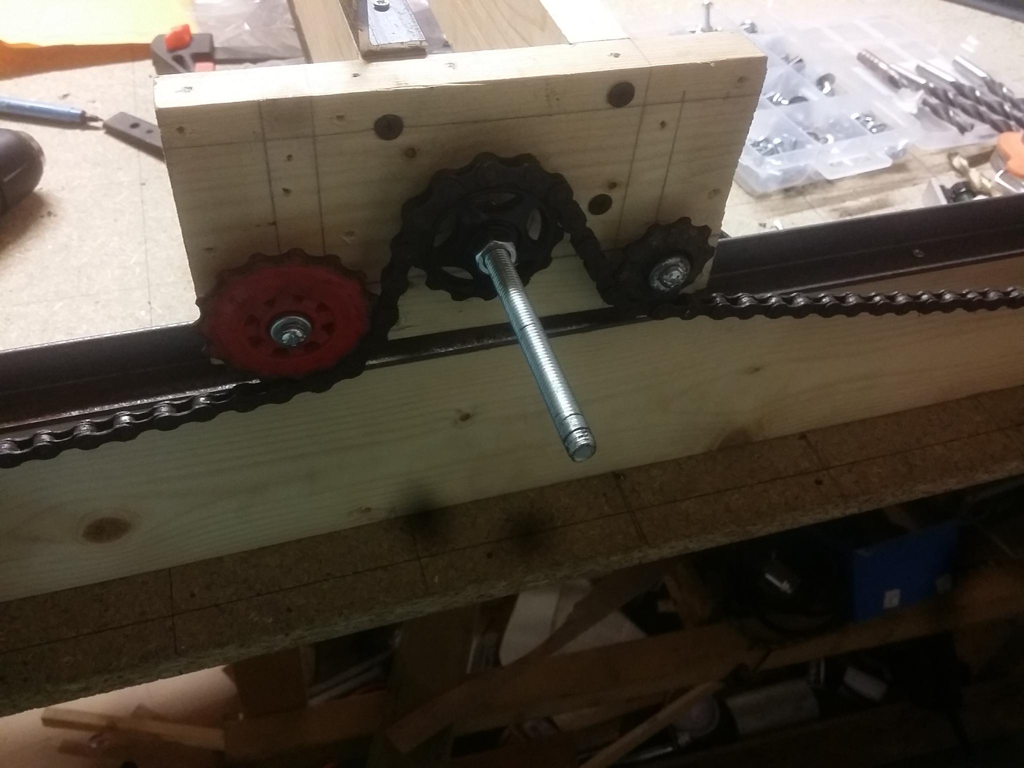

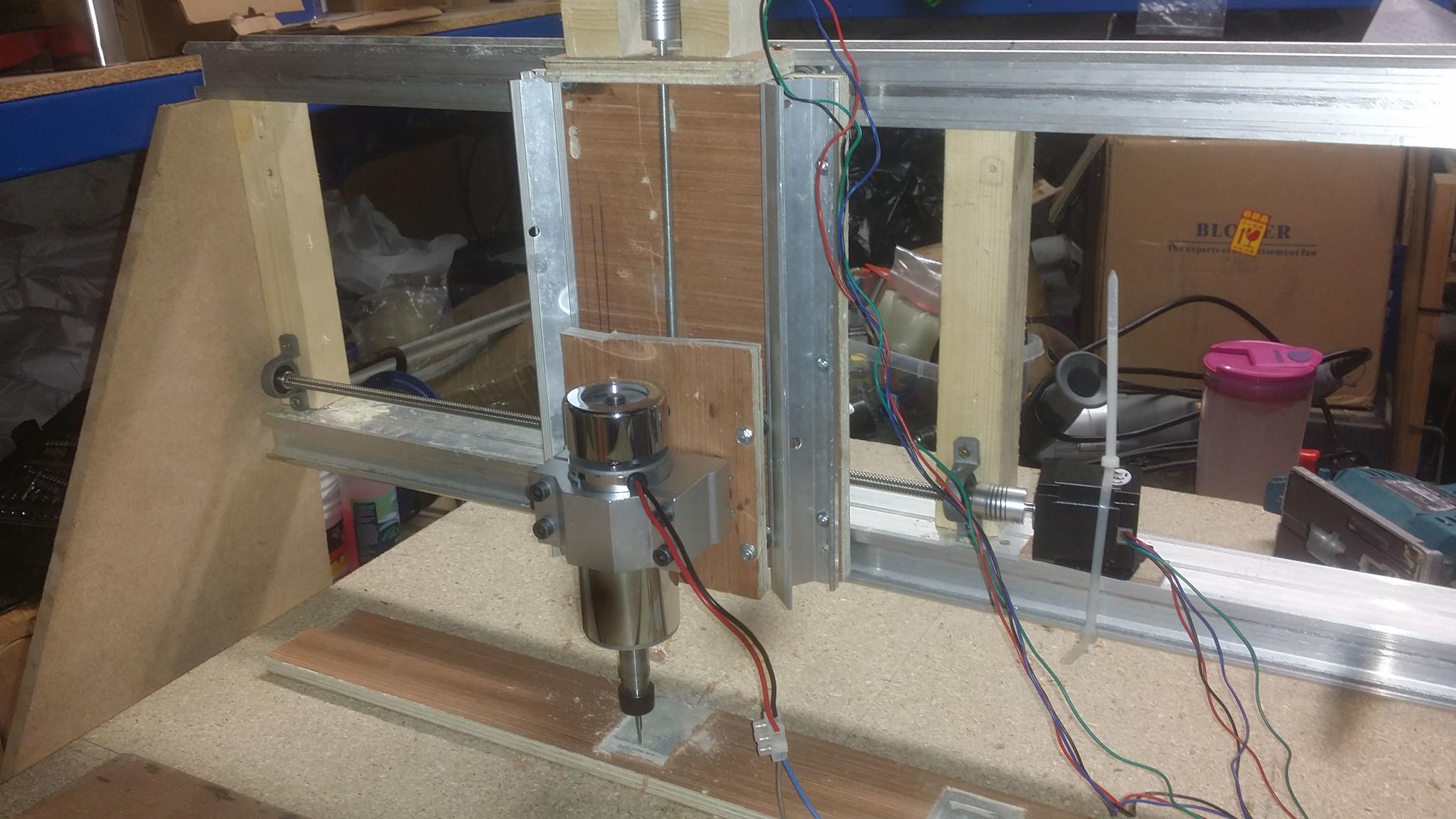

Whoopie today my first set of u groove bearing's turned up. Also by a stroke of cheeky luck I scored 4 1.2m mild steel equal angles for free. After 10mins of tinkering I'm now rolling x and y. Still wait for my couplings and sprocket's.
