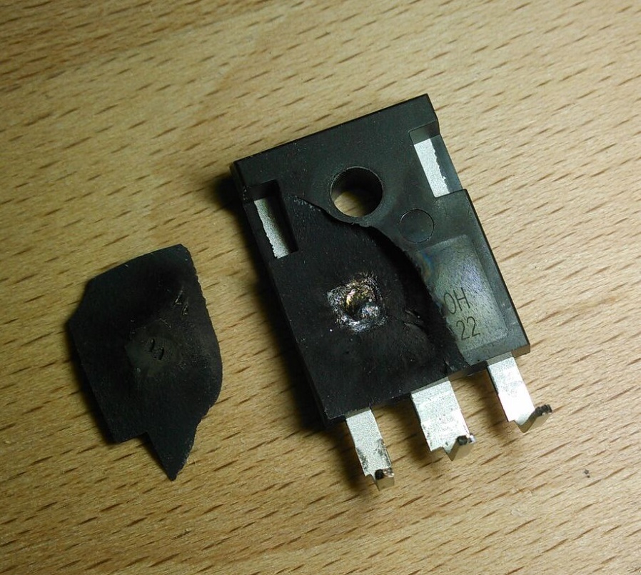

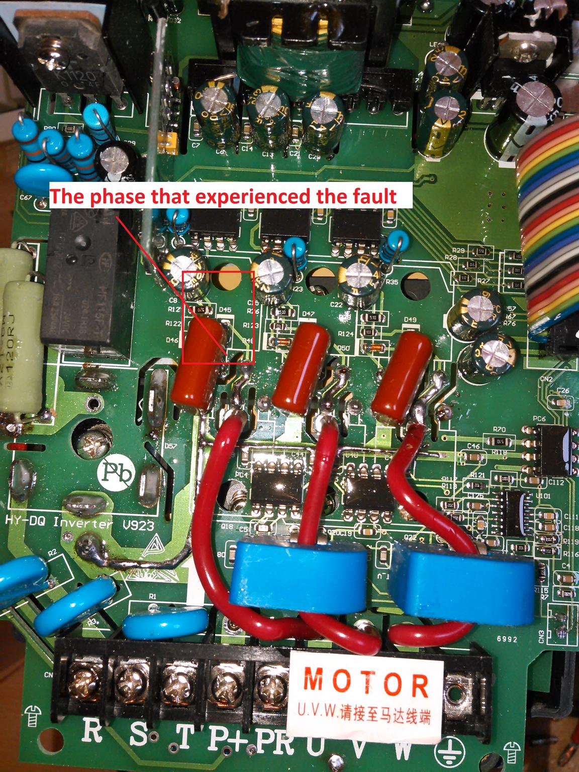

I really doubt that I can return it as the seller doesn't reply my messages. But I just checked the VFD and found a transistor exploded.
Attachment 20429
Attachment 20430
This is the model number: kdg15n120h ( documentation)
What do you think ? Is there a chance to save the VFD by replacing this transistor?
Thanks for your help. :beer:
Re: Huanyang VFD and spindle problem
You could try replacing the bit, they are cheap enough ($25 for 10 from China), but don't be surprised if the damage goes back a little deeper than that one component. For the cost of the bits, it is worth a punt. Check your circuit board tracks haven't been fried as well !

Of course you've blown it up at exactly the wrong time - about the start of the Chinese new year and the black-hole of all internet orders. I can't see a UK supplier but it might be worth looking up an equivalent.

Post some part numbers for similar ones you can get locally and I will comment on if they are likely to be suitable. You should use the multi-meter on diode and resistance test to poke around for damaged parts. Does the VFD display an error with the IGBT now removed?

I just begin to check the circuit. By now, tracks are surprisingly good, but there is some strange connections... I will continue to test the circuit.
I checked the part in china but you're right it will be difficult to replace it with the same model.
It would be awesome if you could advice me :)
A good shop in Switzerland is Distrelec. I've searched for some replacement parts (http://www.distrelec.ch/search?q=iGB...=4&pageSize=10) and I think about this one maybe: http://www.distrelec.ch/fr/igbt-to-2...=50&simi=97.47
Should I replace all IGBT or only the broken one ?
