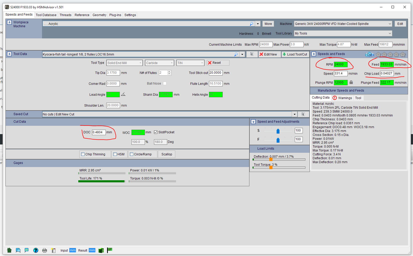

		Re: What to look for in bits?
		Acrylic needs brand new sharp cutters and sturdy machine so the cut is excellent. On small machines is best to scratch it rather than digging in it, or it will melt easily. One flute are nice but not all a center cutting, meaning not very good for drilling holes as the tend to go off center.
here bellow is a general suggestion for cutting acrylic using 3mm / 1/8"  / cutter
Attachment 21107
