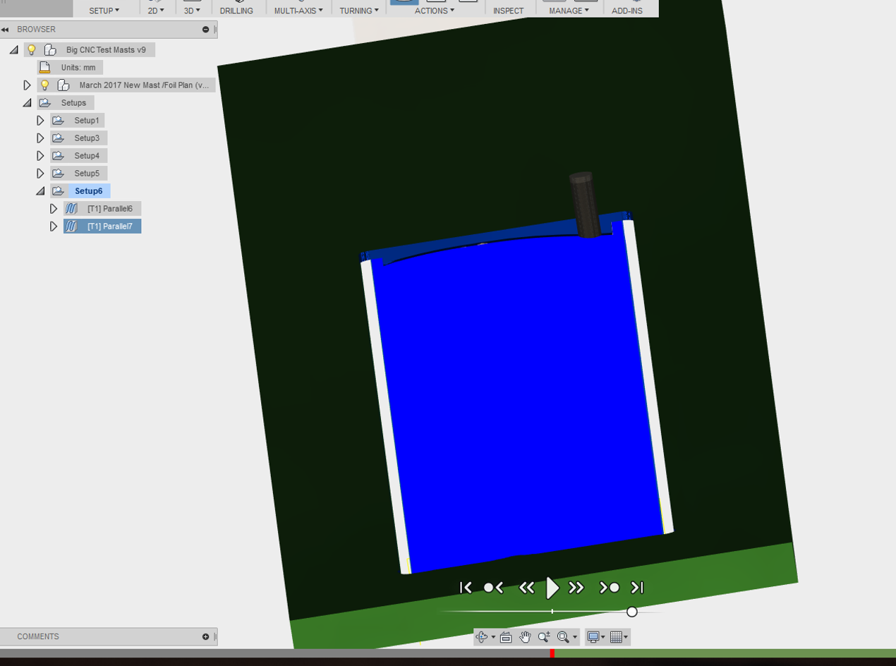

Re: Tooling, Pass Type and Production method for Composite Hydrofoil
Do we think this will work?
I did a parallel finish job without any roughing, contact point with stepover 0.5mm, full depth contact cut, and cut the entire side, then flipped the piece, and did the same again, so once cut the foil has no support ( behind the tool path ), but immediately on the cutting face ( in front of the tool path ), it is supported full length for the entire length of cut? Then once it gets to the far end, I chop both ends off and the piece is complete? No vac table, no supports and no mould required? The only gotchya is that I have to finished the part with a single pass in each direction.
