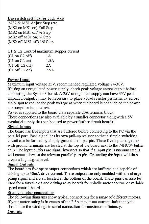

Got a machine in for repair and it's fitted with one of Roy's System 3 board so looking for the PDF booklet on it if anyone has one.
Can't ask Roy as he's retired to Spain and sold out to R-Tech, the welding people but they have discontinued all the CNC parts.

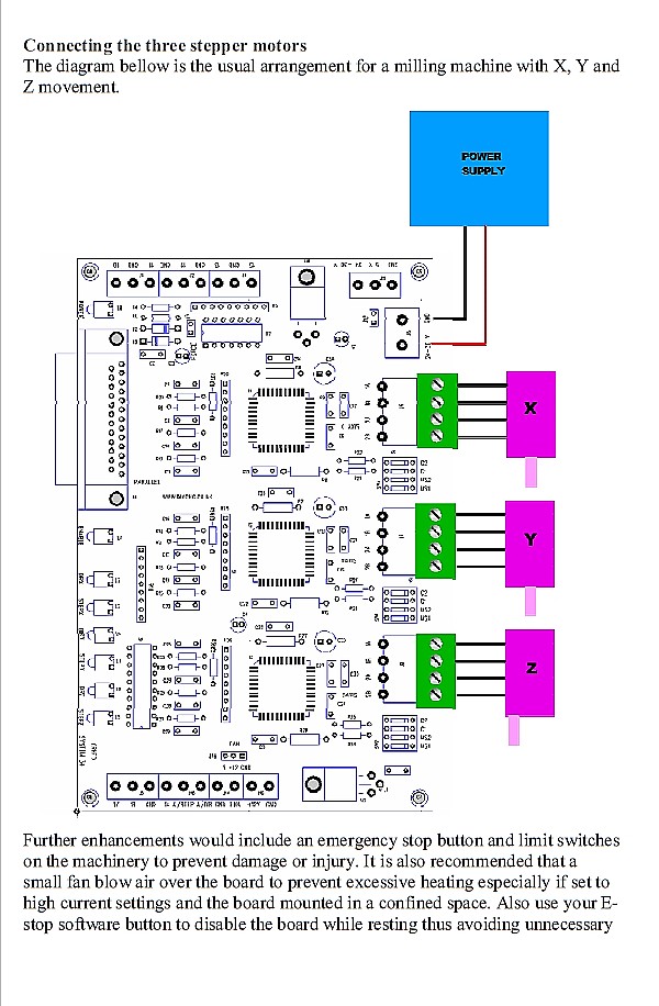

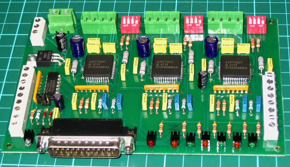

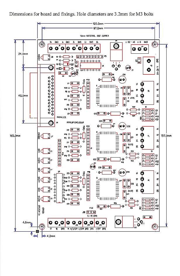

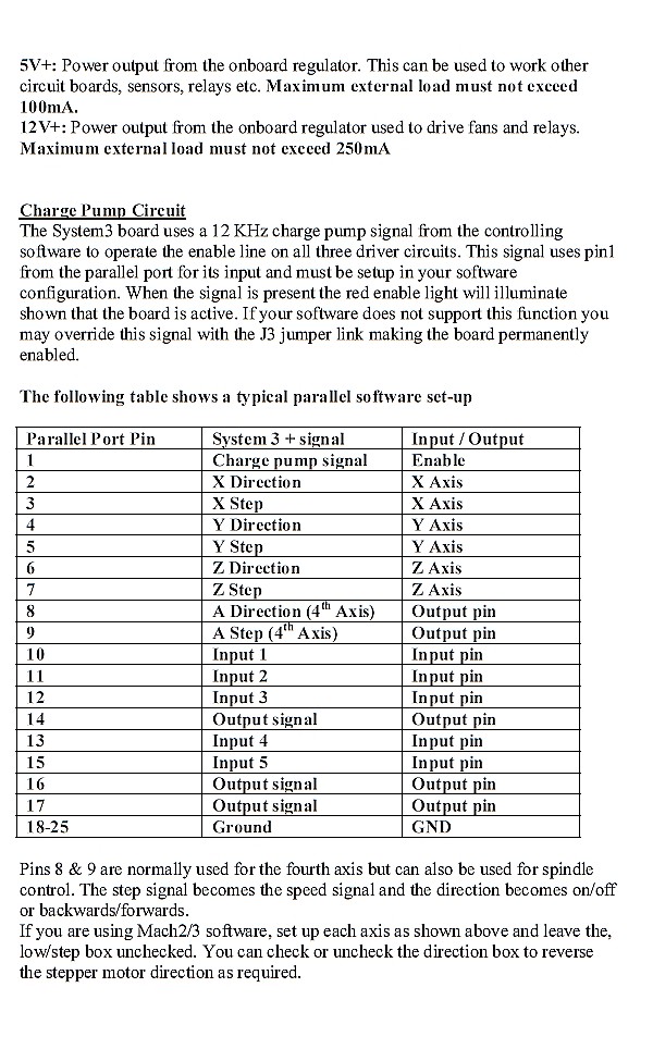

John,
Thanks for that but after doing a bit of searching earlier on the same site I determined it was a System 4 but with only three cards fitted.
I now have about 5 copies of the various iterations of that System4 book.
Many thanks anyway.
Will have some more question is a fresh thread as this machine a Boxford 160 has a toolchanger fitted and it's been roughly converted to Mach3 [ one axis moves ] but it's lacking the tool changer macro.
However I need to do some homework for myself first and then if still stuck, start a new thead.

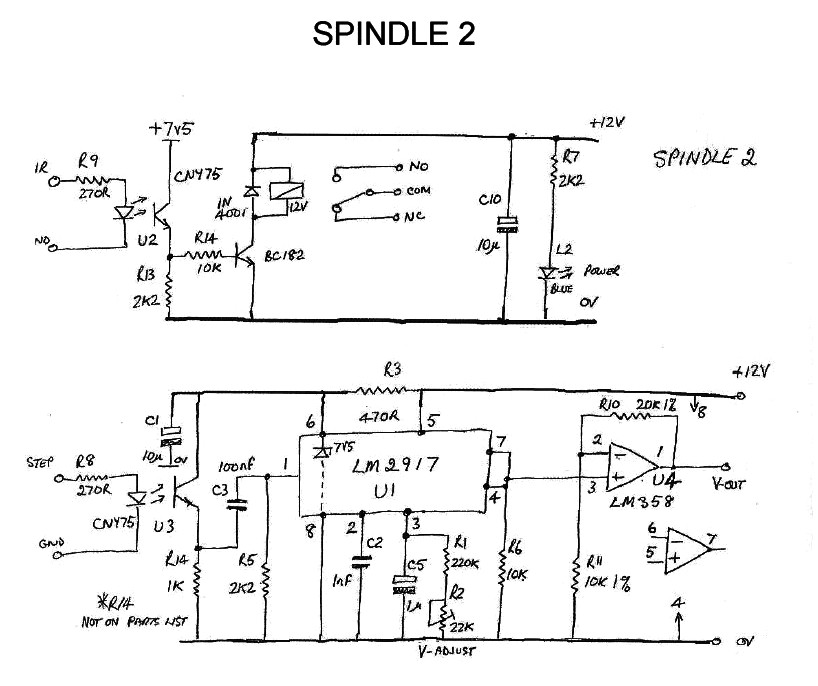

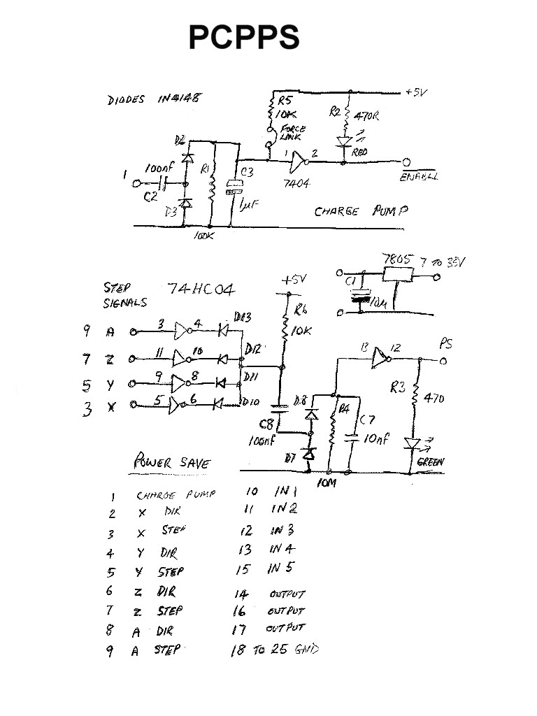

Hi John
spindle 2 & pcpps circuits to add to your CRH Design archive
Attachment 21247
Attachment 21248
