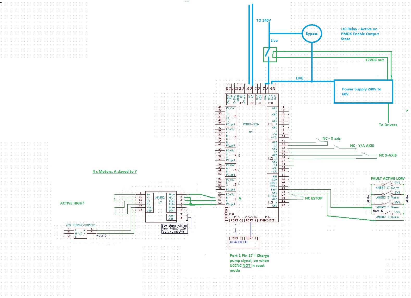

Hi guys,
I am upgrading the electronics on my G540 driven CNC/Router, and need a little assistance with interface between the AM822 error signal, and the PMDX126 error/e-stop connectors.

So - I had a look at AM822 provided picture for Open Collector and PNP signal, and it makes no sense to me, they have pulse +, Dir +, and ENA + coming from BoB, then they daisy together Pul-, Dir-, ENA-, to the ALM-, going to a controller ground, with resistors fitted where VCC = 12 or 24, but no resistors if VCC = 5 Volts. Given I am not planning on using the ENA+ signal, I would just skip pluggin in the ENA on both accounts, but Do I then Run the ALM -, and daisy chain them together for the 5 different drivers into one line, and then go to the ERR-, or fault, terminal? Is this Common Cathode connection - anything to do with Active high signal, or is that setup seperately to having a common cathode or anode?
The confusing thing is that the AM822 page has the ALM+ signal, going to the ALARM on the Controller, but also the ALM- going to a ground on the controller. SO should all the ALM+ be in series or paralell and go to the ERR+, with the ALM- link together to say pin 5 GND?
Should the PDMX 126 be setup as ( PNP SIGNAL) or Anode? for the motor connectors, as it would seem either can be done?
Confused as hell!
Nick

Thanks, but it's still not clear in my mind regarding physically hooking up the ALARM+ and _. Just looking at the ALM+/_ as a single issue.
On the PDMX126 there is a Fault-Active LOW pin amongst the e-stop pin and a few GND's. So I will setup all the AM882's to go fault Active low in the AM882 software. Then I connect all the ALM+, ALM- , ALM +ALM- together in series, from the last ALM- goto the GND pin on controller that's next to fault pin, and from Fault pin goto ALM+ for the first drive. Where is the signal coming from because the Fault pin is an INPUT active low? Does the AM882 make it's own fault signal, or does it just ground a signal that needs to already be there?
If I look at the AM882 schematic in both cases they have the PUL+signal connected to the ALM+ signal. Is this the source for the voltage? what happens between the pulses ie - can't the pulse naturally drop to zero which would trigger the ALM active low, just because the pulse is low?
If I have to connect a PUL+ to the ALM+, do I only do that before the first driver, as it is now effectively powering the series chain of all the ALM+/_'s. Can't this create an issue if Pul+ gets grounded to another driver when the other driver faults?
Then also - If I am daisy chaining the PUL-/DIR- to GND, should that be done seperately for each drive, or can I daisy chain all of them together also and then plu into any GND on the PDMX 126?
The AM882 schematic has all the PIL'DIR/ENA/ALM -, all connected together, then all going to earth - but on the PDMX I have earths in the J13 ( e-stop area ) and I also have individual PC GNDfor each of the driver setp/dir signals, so I figured that the DIR/SteP- should go together to their respective VCC GND, and the ALM- with be seriesed and then run to a GND in the Fault area ( J13 )
These are the bits I need explained. as far as using the fault pin, I could use the ERR+, and ERR-, but really have no idea on what the difference between that is, and using the Fualt pin.
Nick

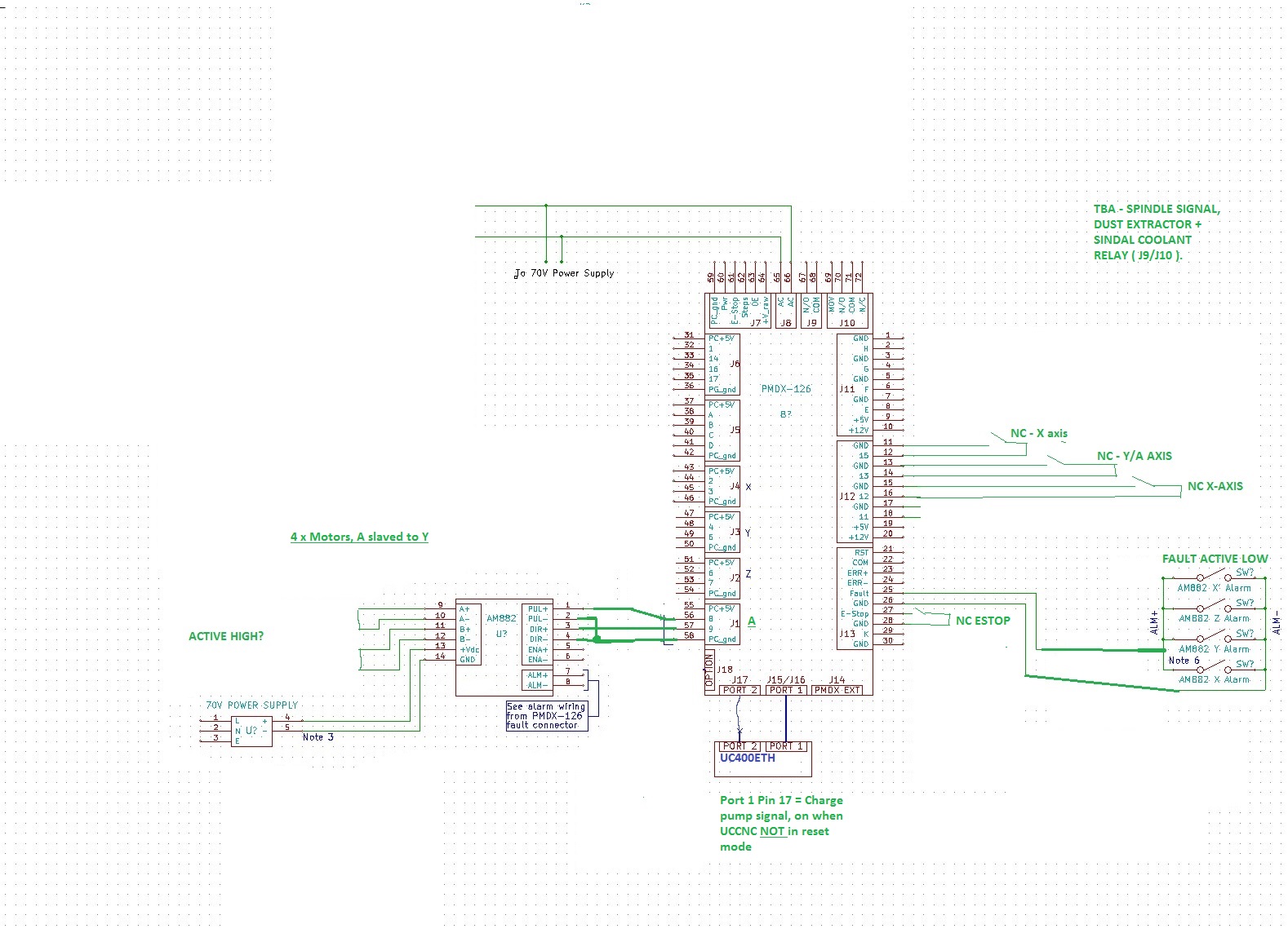

When you say "cut power" to the drives, I was going to wire the motor power supply direct to the stepper motors meaning only the step/dir inputs from the PDMX would be cut. The main stepper motor power would still be connected. Is there a problem leaving the drivers in fault mode? or are people removing the power to stepper motors also?

Think you should knock up schematic which will help you and us understand better exactly what you have in mind.
Like MC says if you don't clear the fault the PMDX will never come out of fault so you'll be stuck in a loop. This means you'll need to Kill power to the drives or use the Enable/reset option on the drives.but this may not suit your plans or the PMDX but without seeing schematic it's not so easy to see what your intending regards E-stop etc.
Re: PDMX 126 with AM822 drivers and relays.
I read in the PDMX manual, if the charge pump signal is disabled, then it will disable the PMDX-126 and all motor drivers. If the drivers are disabled, then they cannot be in fault mode right?
The UCCNC software, can be set to de-activate the charge pump signal, whenever the software is in reset - ( which occurs when passed an E-stop or Fault signal for example )
So in summary Am882 Drivers detect fault. PDMX detects the 882 fault signal and passes to UCCNC. UCCNC goes into reset, which disables charge pump. PDMX now disabled ( powered down ) as charge pump off.
Click on UCCNC reset button now powers up PDMX, which powers up motors ( fault signal effectively reset ), Continue job.
Am I missing something regarding the fault loop? or does this sound like it will work?
Attached, schematic of rough config
Attachment 21408
Attachment 21408
This is showing an invalid attachment at my end.
