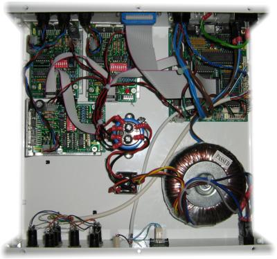

		Re: Step1 stepper drive board from Conqueror Design
		Hi Dave
just looked at Conqueror Design website
if this is what you have
Attachment 21889
going by the width of the ribbon cable that is daisy chained between the driver boards
I expect all the step and direction signals go to each driver board
the pictures resolution is not good enough to see but I expect
  each board has links to select the correct signals for that axis
    John

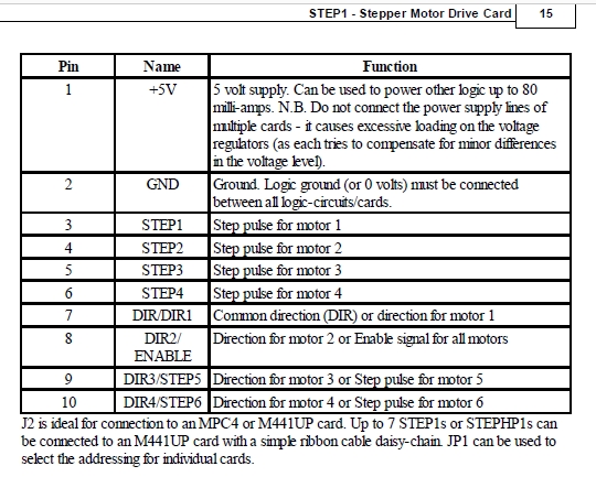

		Yeah that's what I have.  According to the information in this link under step1(R4);
http://www.eaziform.co.uk/files/CNCComps.pdf
There is only one wire which contains all the direction signals but they are selected at the board.  So if I substitute the driver then I somehow need the individual part of the direction signal for that driver
Any ideas?
David
		Hi Dave
if I have read this correctly
Attachment 21891
it looks like for up to 4 drivers
you can have separate step & direction signals to each driver
for more axis they must multiplex the direction signals on pin 7
and store it the appropriate driver board until you need to change that axis   direction
I would need to see the detailed data sheet for a stepper 1  driver board or
 study a board to trace the  direction signal path
I would expect the rest of the circuit to follow the data sheet for the stepper driver IC's used
   John
		I think I'll try wiring up the TB6600 using one of those pins as the direction and see if it works.  I remember reading a paragraph in that manual about the timing signal settings but can't find it now
		Hi Dave
going by what looks like two seperate H bridges on your  stepper drivers
I guess instead of the usual L297 + L298 chip set
your stepper drivers use a L297 & two L6203 H bridges
Attachment 21893
  John
