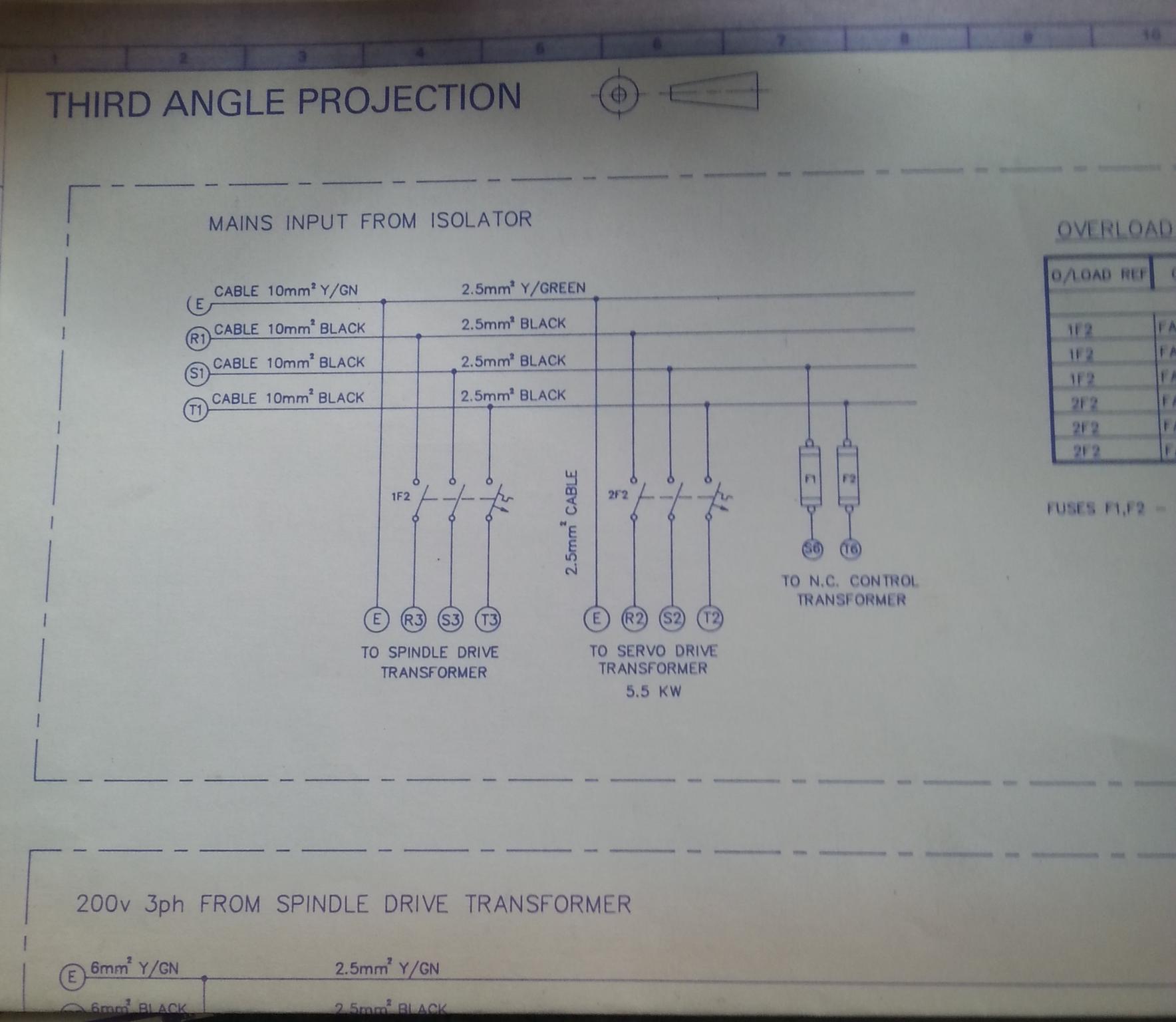

Without seeing the rest of the schematic, specifically the N.C. Control Transformer, I would suggest you disconnect the secondary output side of the transformer to determine if it's the transformer itself or something connected to the secondary side.
Then you may be able to split that up further into individual items connected to the transformer.

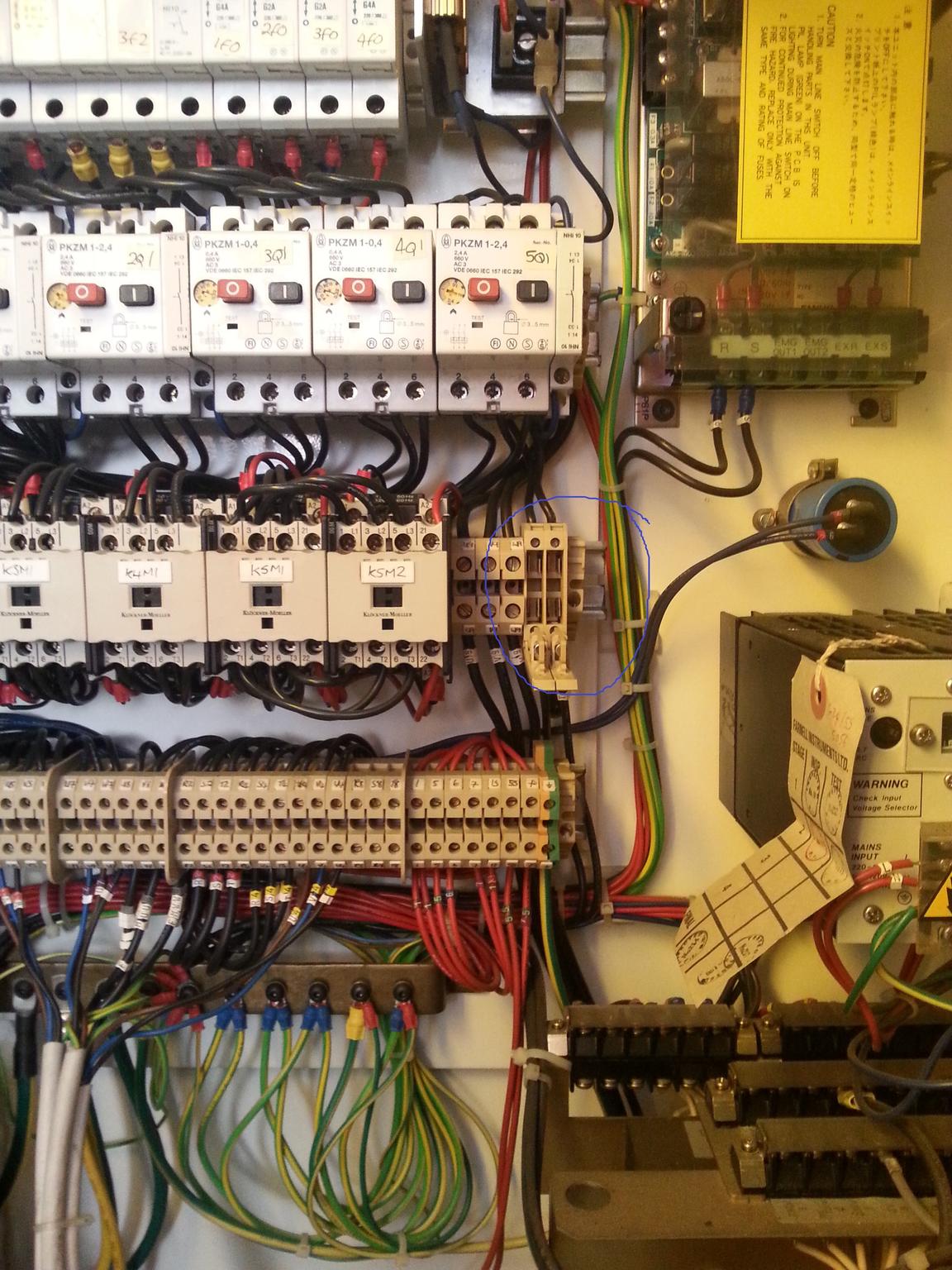

Tonight I hope to start to trace the wiring through, it just would be so much quicker with a decent schematic. The machine has sat idle for 8 weeks whilst we moved and wired the new workshop. The only change could be the a phase change on the new connection. Easy for a bridgeport, it just goes backwards, not sure what happens with the CNC 1000.

Just spent an hour going through the wiring. I found that almost every single terminal was loose and I could get 1/4 to half a turn on them. Also found connection W9 was not connected and the wire hanging loose. Replaced the S6 and T6 fuses and Yippee it works.
These connections have probably not been touched for 25 years, guess moving the machine disturbed them.
