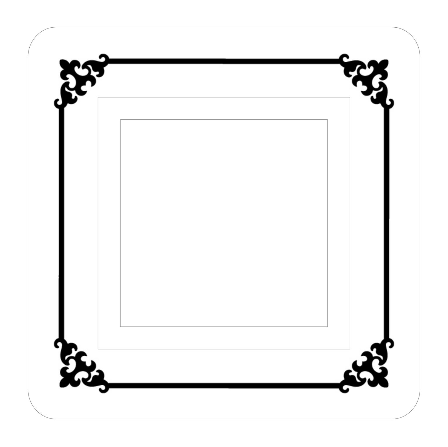

Hi Rob,
I downloaded your files, combined 'em and saved back out as a .dxf and a .pdf - sizes were a bit screwy - I take it you don't want a switch surround that's 1.5 metres across..? - Although it might make for a nice focal point for the room...
Anyway, here are the files:
https://www.dropbox.com/s/mxnewkwwev...FRAME.dxf?dl=0
https://www.dropbox.com/s/vrx4m0jlb1...FRAME.pdf?dl=0
Hope this helps!
Wal.

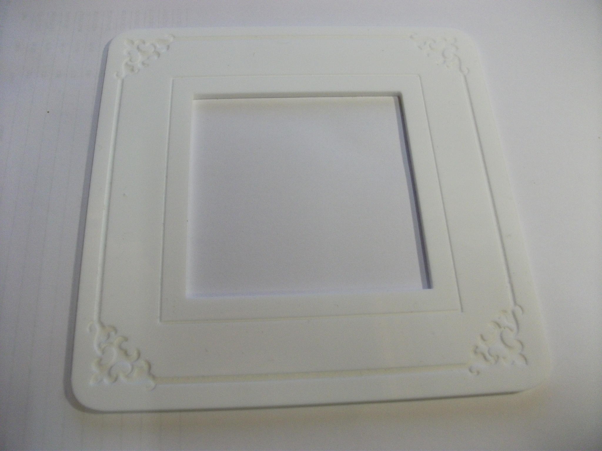

Thanks Wal, The decorative scroll was too small, but at least it was addressable with my software. I corrected the size and have created the Gcode. The trial cut in a bit of scrap ply has finished and it looks GOOD !
I will set up a piece of perspex sheet and cut it out now.
Re: Incorporating dxf file in design - help/advice needed
All cut out, now I need some bronze enamel to do the infills.Attachment 24169

Thanks again Wal, but I could do with knowing what you did exactly as I have several other designs to do the same with in the near future. I think the software I have doesn't handle these files properly as I get errors when saving them as .dwg in AutoCAD. I have also tried Inkscape with similar results.
Rob, I use Adobe Illustrator - I just opened up your files, plonked them into one and re-saved in those two formats. I wonder if the decorative scroll vectors were that big they simply went beyond the canvas in estlcam? I've never used that software so can't offer any meaningful advice beyond that..

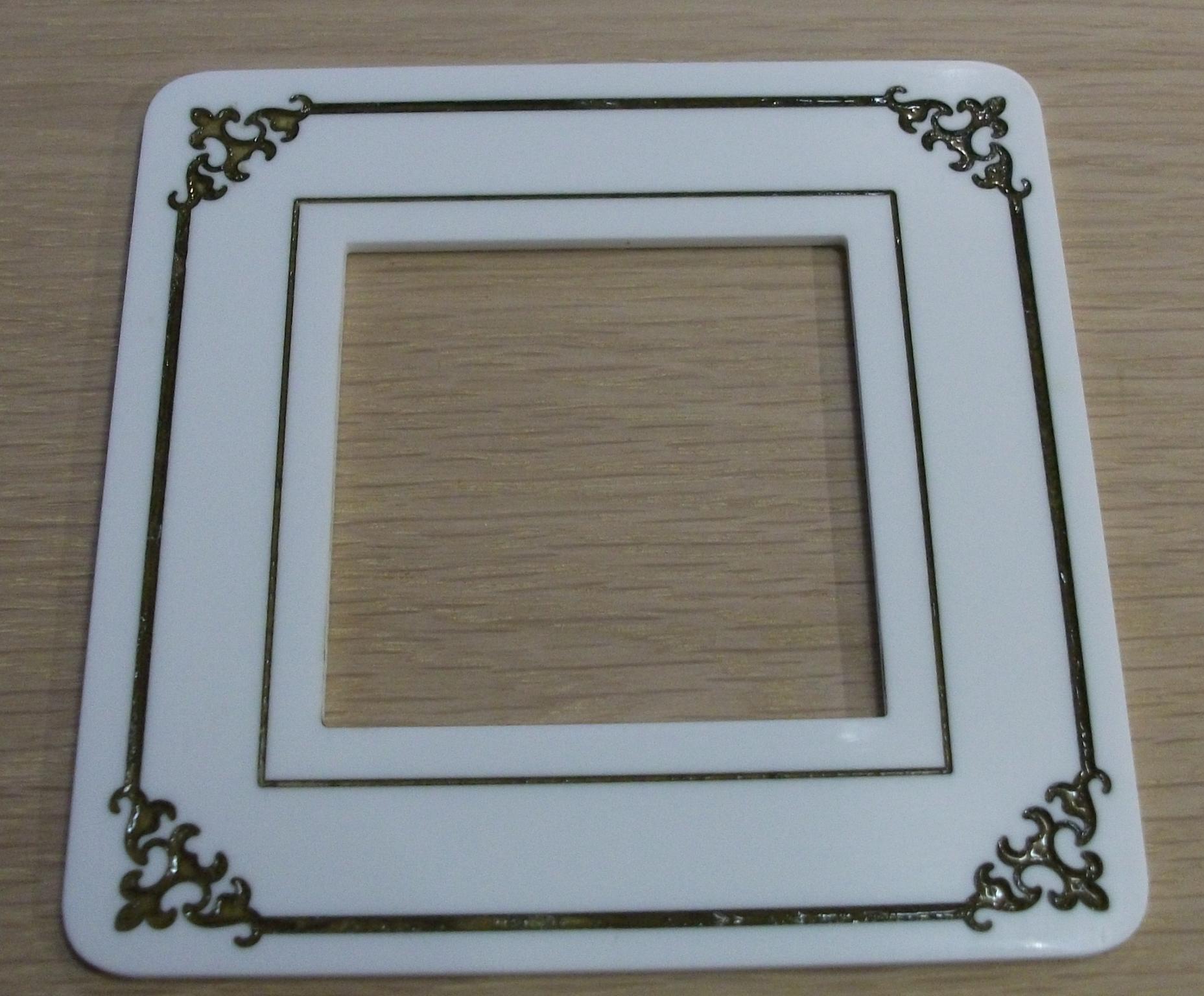

Attachment 24197
Job done !
Humbrol enamel takes an age to dry. Then I cleaned up with 1500 wet and dry and finished with 2500 to give a matt look to it.
Now I need to put it behind the switch !
