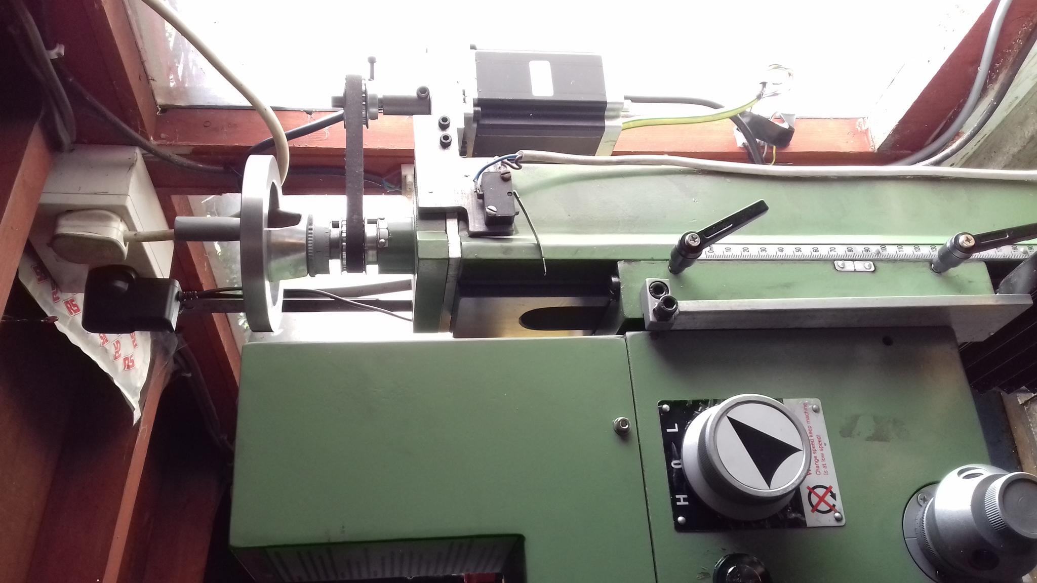

thanks for the swift reply,i was having a senior moment when i asked the question,everthing is set in mms,have checked my settings and have x 1000.67 steps,vel is at559.98 mm,acc 30,step pulse at0,y is at 1053.35 steps,vel at 349.98, acc 28 step pulse at 0,i have run the beds to their max travel and only have stalling when i put resistance on the hand wheels,however when i run a programe stalls happen between moves,result is lost positioning,so code cuts in wrong places,im useing 4nm motors on direct drive to all axis;s,am still running 2mm pitch lead screws?will change to ball screws when this fault is sorted,the electronics was bought as a kit from cnc4you .home made motor mounts and bearing blocks,will try to post pics when i find how to do it,many regards richard.

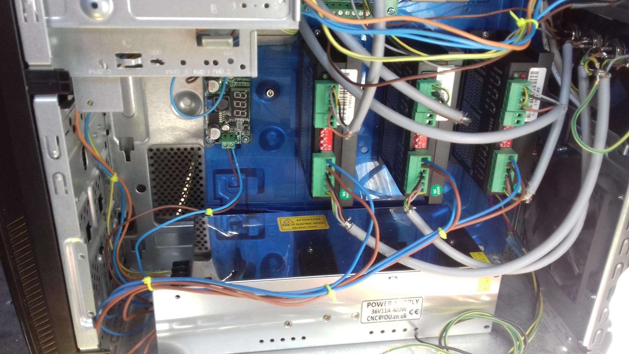

Mechanical: Decouple the motor from the screw. Can you still stall the motor with the hand-wheel?, if so, then it's not likely the axis binding and I'd move to the electrics. With the system powered (i.e. steppers energised) can you turn the hand-wheels?
Electrical: Your PSU is 36V... have you measured the actual voltage though? Then repeat with the axis stalled.
From everything you've said you've not indicated lost-steps or loss of direction control - so the BoB sounds okay, as does the integrity of the wiring from the stepper driver to the motor.
Can you describe how you've wired the stepper (which colour wires go where).
Can you post the specification of the PSU?
Can you post the type of stepper drivers that you have? (a photo would be useful)
Re: stepper motor stall?
motor is direct drive to lead screw lh side of x,hand wheel on rh, yes can stall motors with hand wheels ,cant stall motors by exerting body weight pressure against x or y,can turn hand wheels when motors energised,resistance felt then clicking from motors.psu is set at36 volts ,have checked.wiring to motors is red and blue to a+,yellow and black to a-,white and brown to b+,orange and green to b- motors are 4nm 60bygh401-03 ,drivers are cw5045 supplied cnc4you, bob is a kk01, psu is marked as 36volts 400watt 11amp,sorry cant post pics until i find out how to do it,something else to learn. regards richard.
from your description I don't see any thing wrong
do you have the stepper driver enable inputs connected ??
if you do
try running with the enable disconnected
(the enable is a negative logic input so the drive is enabled with no input !! )
if Mach 3 is a bit slow enabling the drive that could be a cause of you missing steps
what position do you have switch 4 ?
if its off , the motor current will be reduced when the motor is idle
switched on , the current remains at the 4.2A you set the stepper driver to.
and you should feel more resistance when you try to manually turn the hand wheel
John

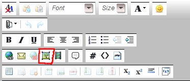

PS
if you have a JPEG photo on your desktop to add to a post
when adding a reply or editing a reply
click the symbol marked in red
Attachment 24463
on the next page click basic uploader
to add files from you computer
next page click browse
then type the JPEG file name in the box
