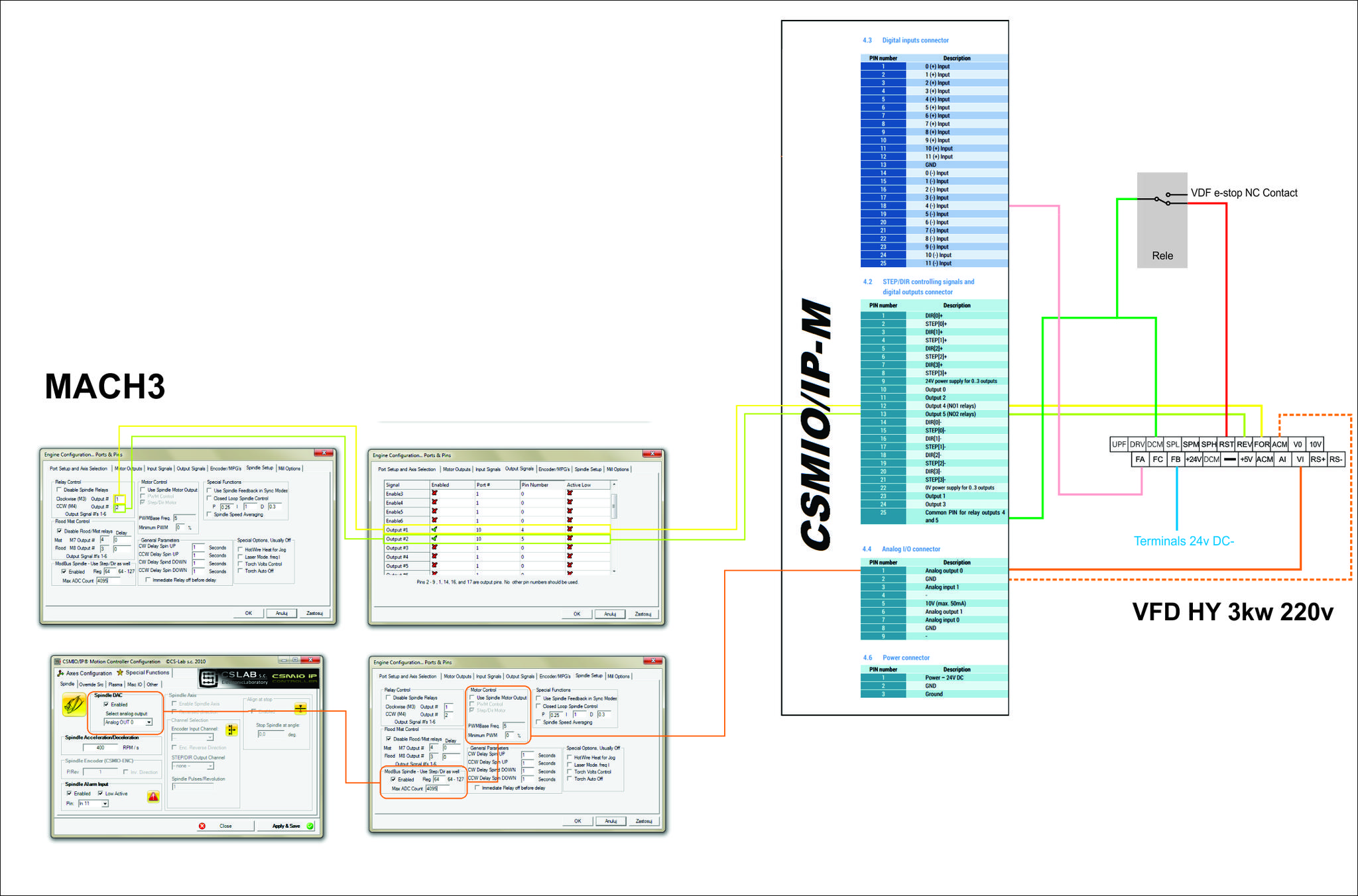

Does anyone know how to configure the Chinese VFD HY on mach3?
I have it with the controller csmio ip-m
It is all connected and configured in mach but the mill only rotates at 12000 rpm and can not change it from mach MDI

and the diagram shows how the mach3 is connected and configured
but it only rotates at 12000 rpm

You're discussing a system where the Spindle is being controlled by an analogue voltage, between 0-10V, provided via Mach3 through the CSMIO. To understand if your problem is with the Mach3 set-up, or the CSMIO, or the VFD, the easiest indicator is the analogue output from the CSMIO to the VFD.
I've read into your description that the FOW control works (so issuing an M3 command starts the spindle, at 12000RPM), but any speed command fails to change the RPM. So, if you issued "M3 S8000" in the MDI, that the spindle will operate, and the VFD will display 12000 RPM. Please correct me if I've misunderstood.
From here it is logical to measure the analogue voltage output from the CSMIO, by connecting a DC volt meter (or a DMM on a DC voltage range) across the ACM terminal on the VFD (black/negative) and the VI terminal (red/positive).
A properly configured Mach3/CSMIO would output around 10V with the "S24000" setting. It should output around 5V with the "S12000" setting, and around 2.5V with the "S6000" setting. If it does, then the problem likely lies with the VFD, and it's settings.
The reason I asked for three settings is to verify that the CSMIO/Mach3 is not saturating the output from the CSMIO (e.g. if the S24000 and S12000 both output 5V, but S6000 does give 2.5V, then it would look as though the CSMIO analogue output is limited to 5V (for whatever reason - and I don't know the CSMIO and would advise no further). Also, if the S6000 also output 5V then I would seriously look at the Mach3 / CSMIO configuration, as I would expect that the DAC on the CSMIO wasn't being driven by Mach3.
If, however, the CSMIO does output the 10V/5V/2.5V expected for S24000/S12000/S6000 then you can be reasonably sure that the CSMIO/Mach3 are correctly configured, and we can concentrate on the VFD settings.
I have briefly looked at the register settings for the VFD, that you provided, and they look at first glance to be correct. But, if the voltages out of the CSMIO into the VFD are broadly as expected at different speeds then we can spend more time looking at the VFD set-up.
One other question: You say the speed is 12000RPM. Is this a fixed, exact 120000, as indicated on the VFD? (my reason: it's unlikely that you'd get a precise analogue output of exactly 5V from the CSMIO to give the exact 12000 RPM... it might indicate that the VFD is not sourcing it's speed control from the external VI input).

I told you that I measured the tension and the ip-m csmio does not exceed 5v
I made some changes to the parameters of the VDF and it gave me some results
first change pd070 is (speed control input) set to 1 is 0-5v and in 2 I get no response, the axis does not turn
the jumper is in the VI position
and also change the following and I got this result
pd011 configured 100.00 axis rotates at 6000 rpm 1.5v
pd011 configured 200.00 axis rotates at 12000 rpm 2.3v
pd011 configured 300.00 axis rotates at 18000 rpm 3.5v
pd011 configured 400.00 axis rotates at 24000 rpm 4.8v
all these speed changes I get it by changing the parameters
in the VFD no matter what I entered in the mach tab in MDI

I'm unsure what you're talking about here. You're changing the minimum frequency (a function of RPM) from 100 - 400 (6000rpm - 24000rpm), which suggests to me that the VFD is reading a minimum demanded spindle speed, and it's driving at the values in the pd011 as a consequence. You should reset pd011 to 0 (or your required minimum) and not try to use this as a method of speed control.
BUT, what is the reference to voltage (1.5v, 2.3v, 3.5v and 4.8v)? - are these the outputs from the CMSIO analogue channel 0 with the different S6000, S12000, S18000, S24000 MDi commands?
I understand you're saying that there is no response to entering speed commands in the MDI. But are those analogue voltages (tension?) the result from the speed command at the CSMIO output / VFD VI-ACM input?
If that interpretation is correct, then there's at least some suggestion that the Mach/CSMIO is correctly configured (although the register 64 in the settings looks at odds with the CSMIO/IP-M instructions here.... https://en.cs-lab.eu/wp-content/uplo...-m-artykul.pdf which seems to indicate a register value of 80... which also suggests that the CSMIO IP-M output is expected to be between 0-10V. But I'm not familiar with the CSMIO and wouldn't comment further on this.
I would reset PD011 to 0 and PD070 to 1. Then I'd get a 1.5V cell (AA battery), disconnect the RFD VI input from the CSMIO and connect the cell with + to the VI input, and the - to the ACM input. Using a M3 command from mach3 should then give you 24000/5*1.5 = 7200 rpm (or there abouts). This would confirm the analogue input into the VFD is working as expected. Or not.

I use a CSMIO/IP-M, and it takes a little bit of work to get it set up for analogue speed output. I would like to see a measurement of the CSMIO output voltage at the terminals just to check that it is actually configured correctly. The CSMIO plugin for Mach3 has some settings that are not obvious (although if you work through the manual very carefully they are documented) and you have to get this right. You should see 0-10V coming out of the CSMIO when it is configured correctly. Quick check with a voltmeter will confirm whether the CSMIO has been set up correctly.
