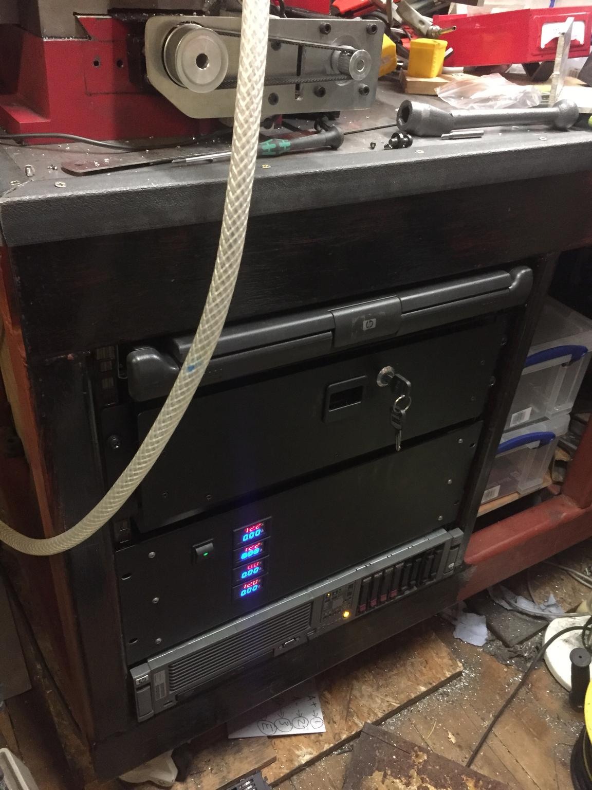

Bench was the original frame for a router I'd intended to build, but chickened out (it was going to be too large for the shed... so became a pretty handy bench). As part of that original design I'd planned around supporting 2 19" racks - using one of these to fit a HP server, the control box (PSU steppers, motion controller) and a server keyboard/monitor - for which the backlight on the monitor finally failed today...
Attachment 25777
The other 19" bay (out of shot) now simply holds my compressor (a silent 25l ex-dentist job). The central bay just holds stock material.

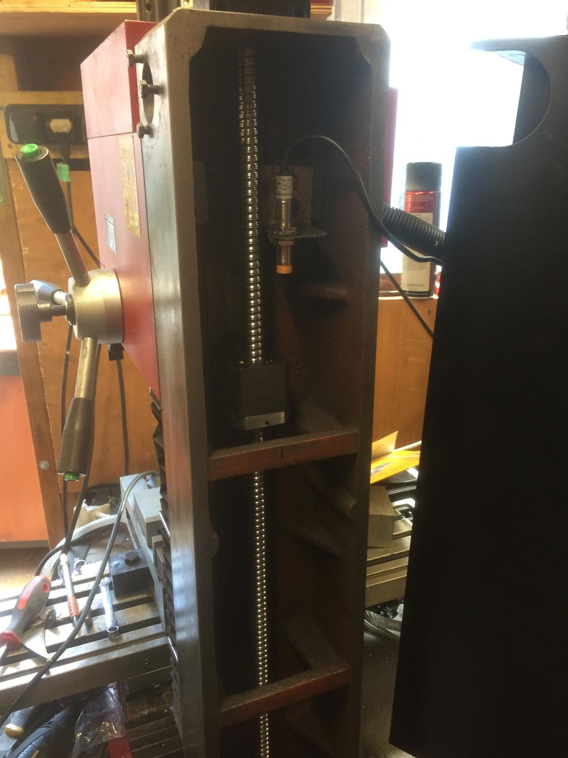

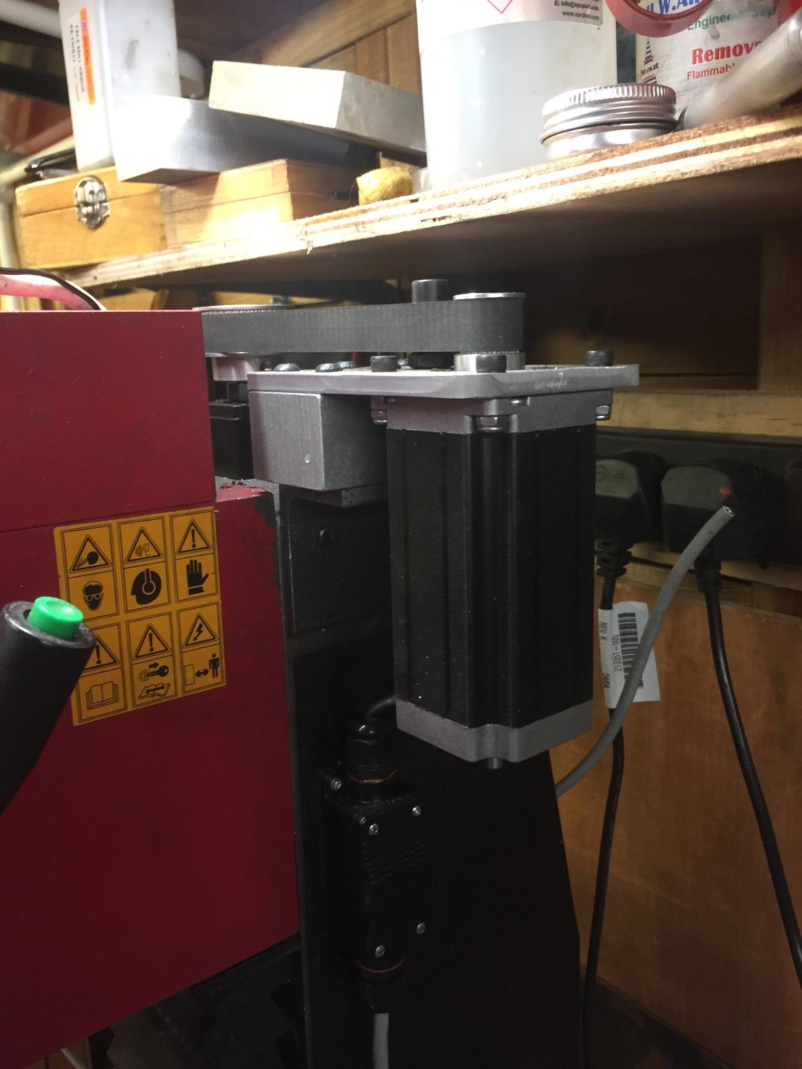

Z Axis - it's all been done before, I'm just copying others who've converted their 2.7s. Z is by far the easiest axis and the original ball nut holder takes a standard 1605 ball nut. 2:1 belt drive as a general approach to all axis.
Attachment 25780Attachment 25781

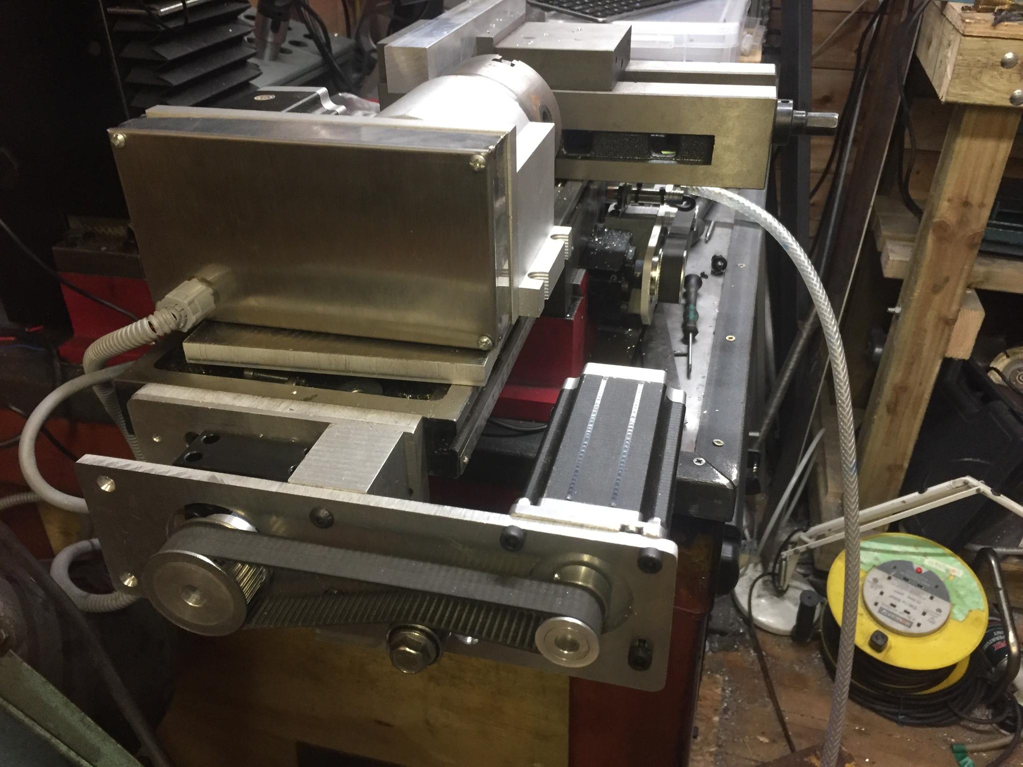

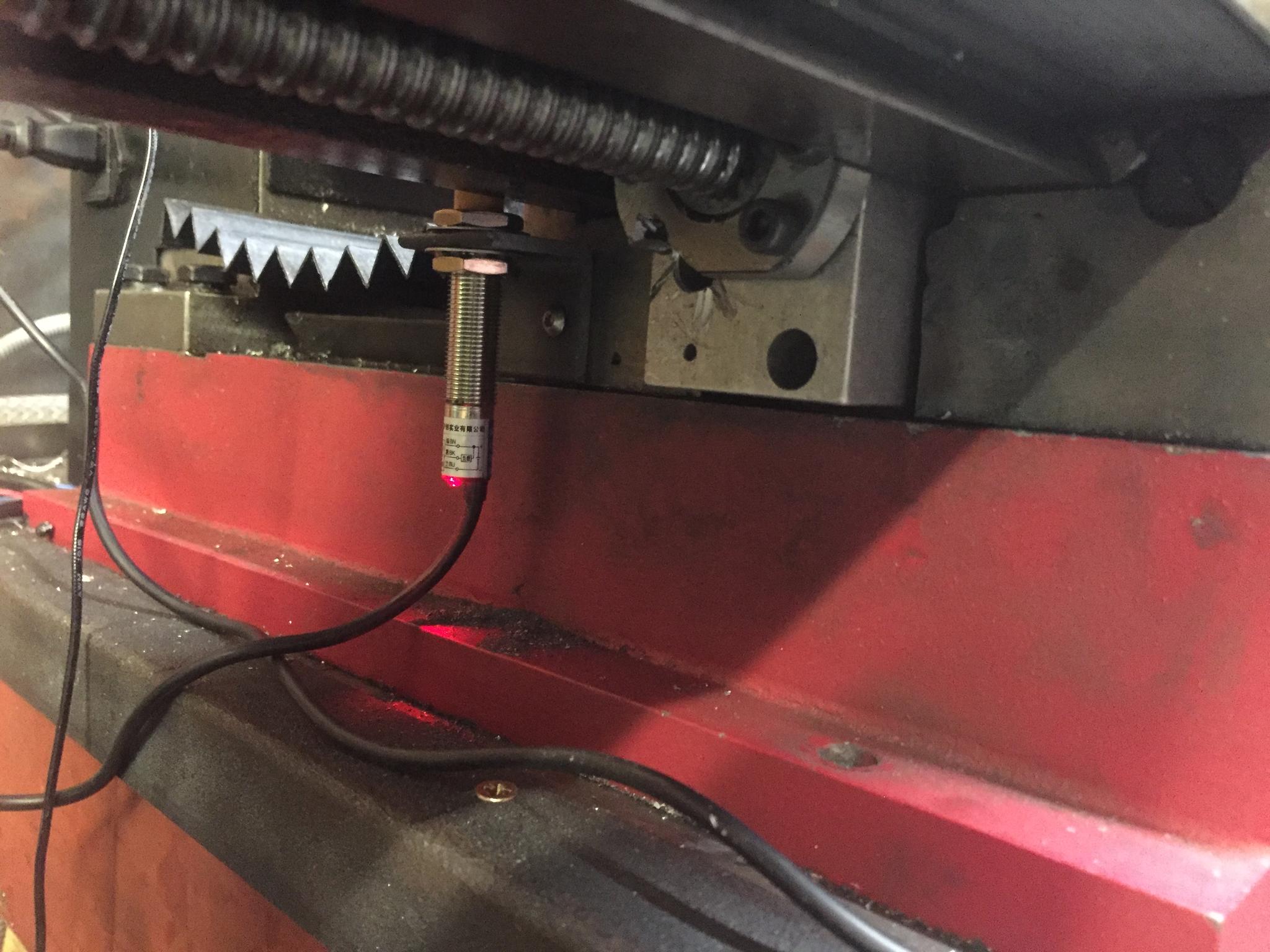

Some detail on X - ignore the hack job on the ball nut - I was trying to expose the nut holder's bolt hole in situ to unbind the screw that was slightly misaligned after I'd tightened all bolts. That was a difficult few minutes with a Dremel and none too pretty.
Attachment 25782

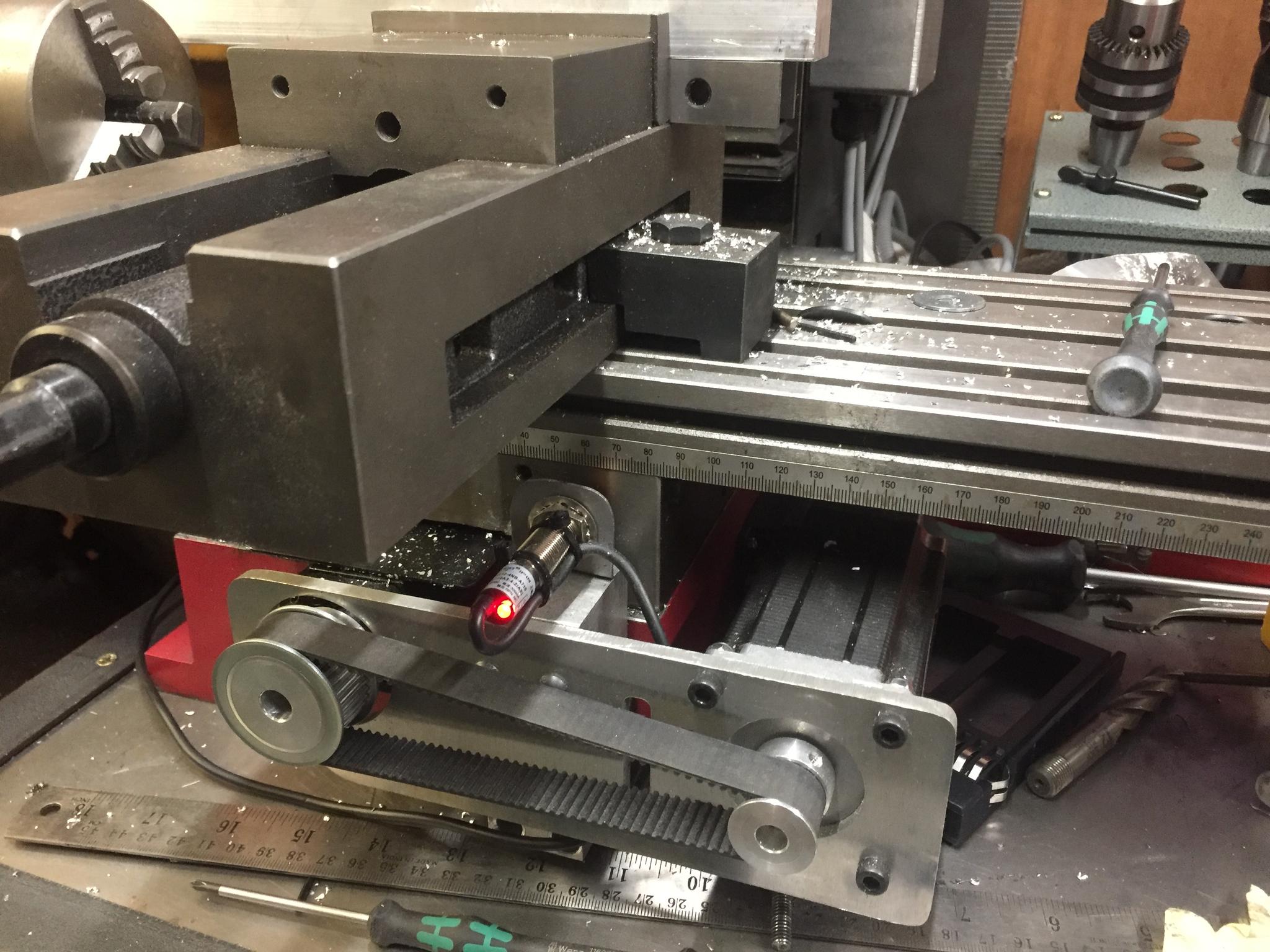

Y Axis - very much like the others. I'm not sure that I like the limit switch so exposed, so might re-do this once I regain my enthusiasm.

Both Y and Z axis the screws are unsupported, X has a phosphor-bronze bush to support the end of the screw (butchered with a band saw) mounted in the end plate. General approach was limited to hand tools or what I could fit on a Denford Starmill (150x80 table area - somewhat limits options). Oh, and everything with an option to recover the machine back to the original manual control if necessary.

I am attempting this conversion on a new SX2.7. Do / did you find any problems created by the belts creating a small amount of backlash as the motors change direction? How critical is belt tension and does the additional side loading of the motor shaft bearings created by tensioning the belts concern you?
Dennis
		Re: Sieg SX2.7 (Long Bed) CNC Conversion
		The belts each have tensioners (just a M8 or M10 in a machined slot to allow any slack to be taken up, packed with bearings to present a rolling surface to the belt). There's no discernible backlash (yes, of course there's theoretically "some" but not enough to worry me) - choice of HTD belts obviously helps to some extent.
How critical is belt tension?, don't know - took out the slack and I can measure a step on the stepper translating to linear motion.
Side loading on the motor shaft bearing?, if it's a problem I'll replace the motor, it's worked well for 18+ months with light use. The bearings are designed for radial loads so I'm not losing sleep on that one.

I have belt covers on each axis now... 3D printed was easy.
