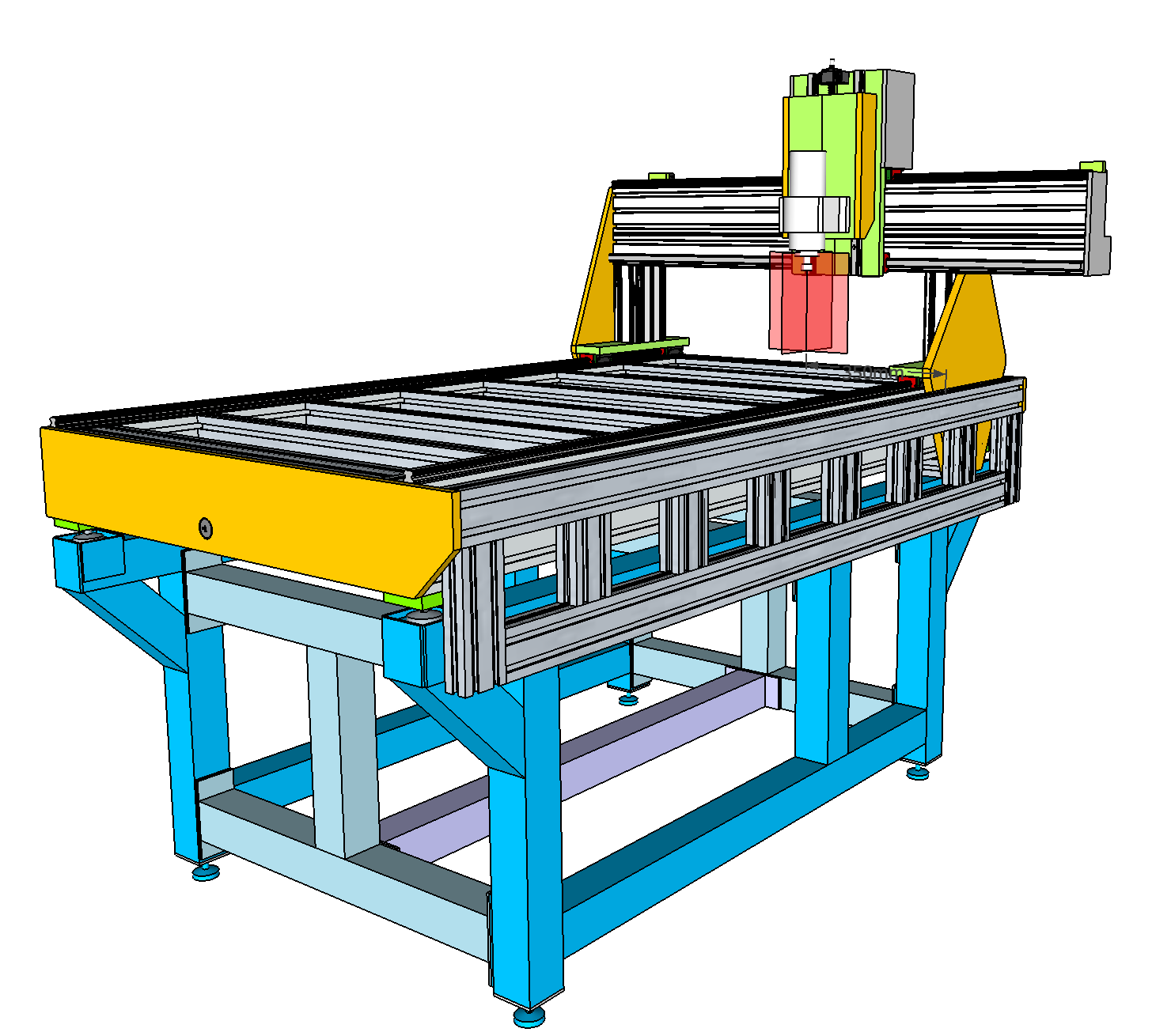

------------------------------- Update design (more detail in the discussion)
Attachment 28089
Modification from the initial design :
- Widening the table : 670mm > 800mm
- The table will finally be aluminum > (160x80 + 40x80), I keep a steel base
- Reduction of the steel profil section 100x100x5 > 80x80x5 for the base
- Base is cut in several parts

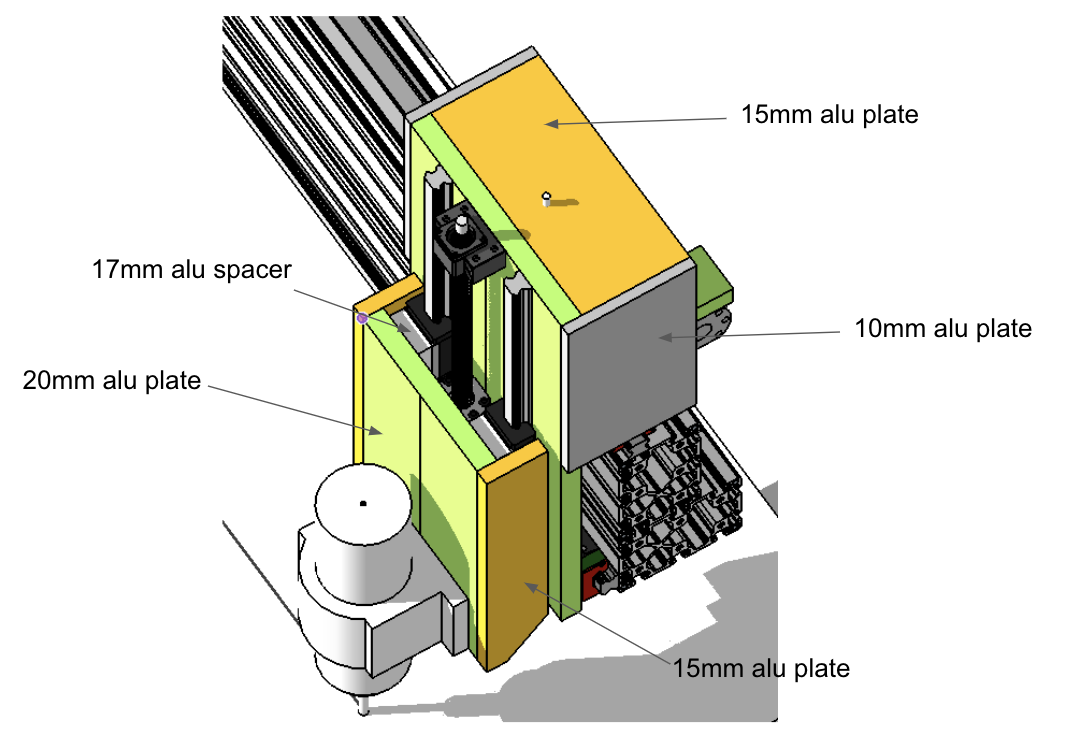

- Thickness of the gantry side plate : Aluminium 20mm -> 15mm (advice from Jazz in #5)
- HGW carriage on X and Y axis (advice from Jazz in #2)

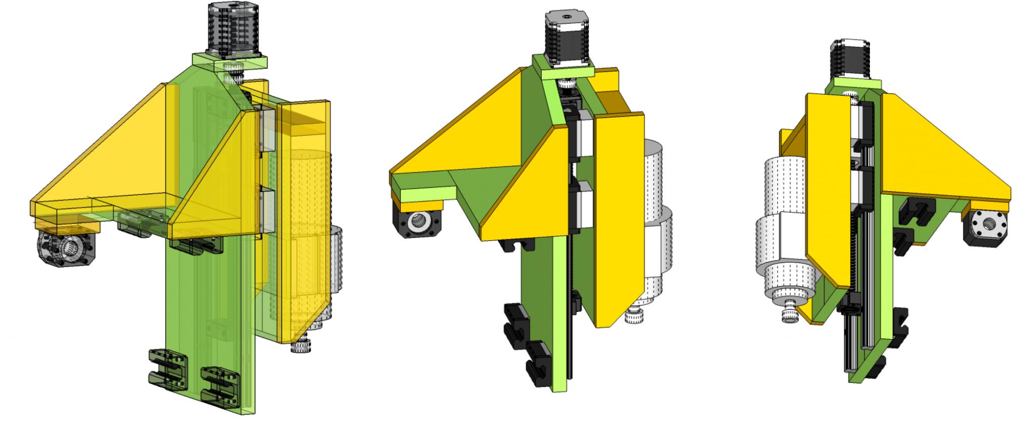

- Ribs of the Z movable part is now turn on the Z fixes plate (more clearance around the spindle)

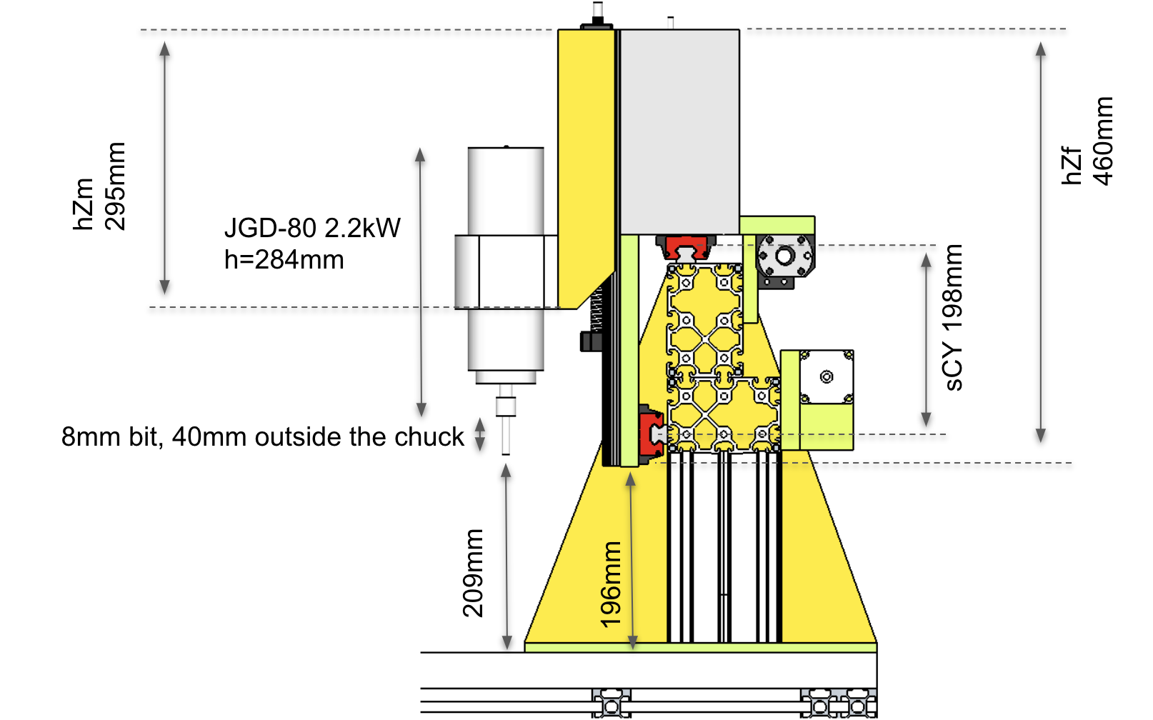

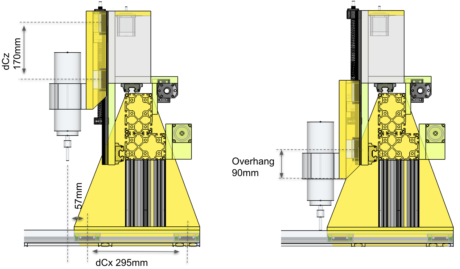

- Clearance between Z carriage 107mm > 170mm (advice from Jazz in #2)

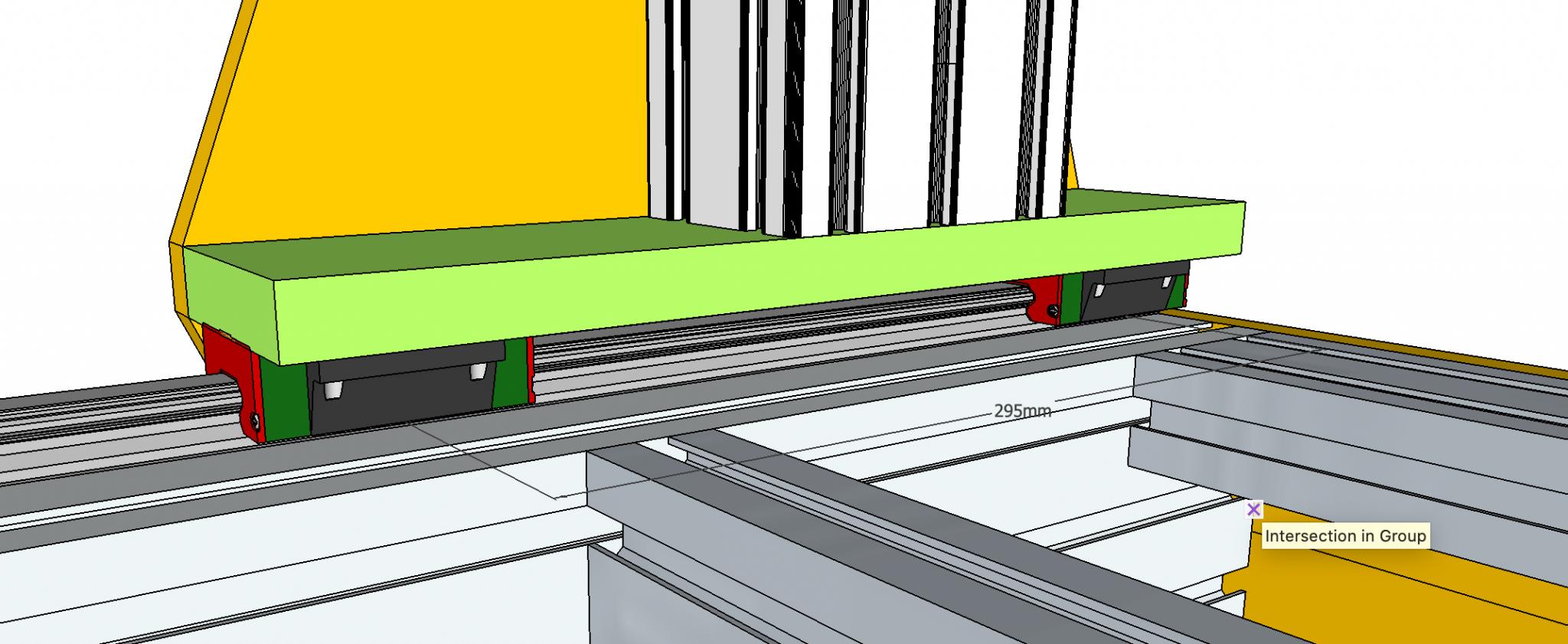

- Clearance between X carriage 245mm -> 295mm
- Height of the gantry 360mm -> 400mm
- Indirect transmission on all ball screw 2:1 or 3:1

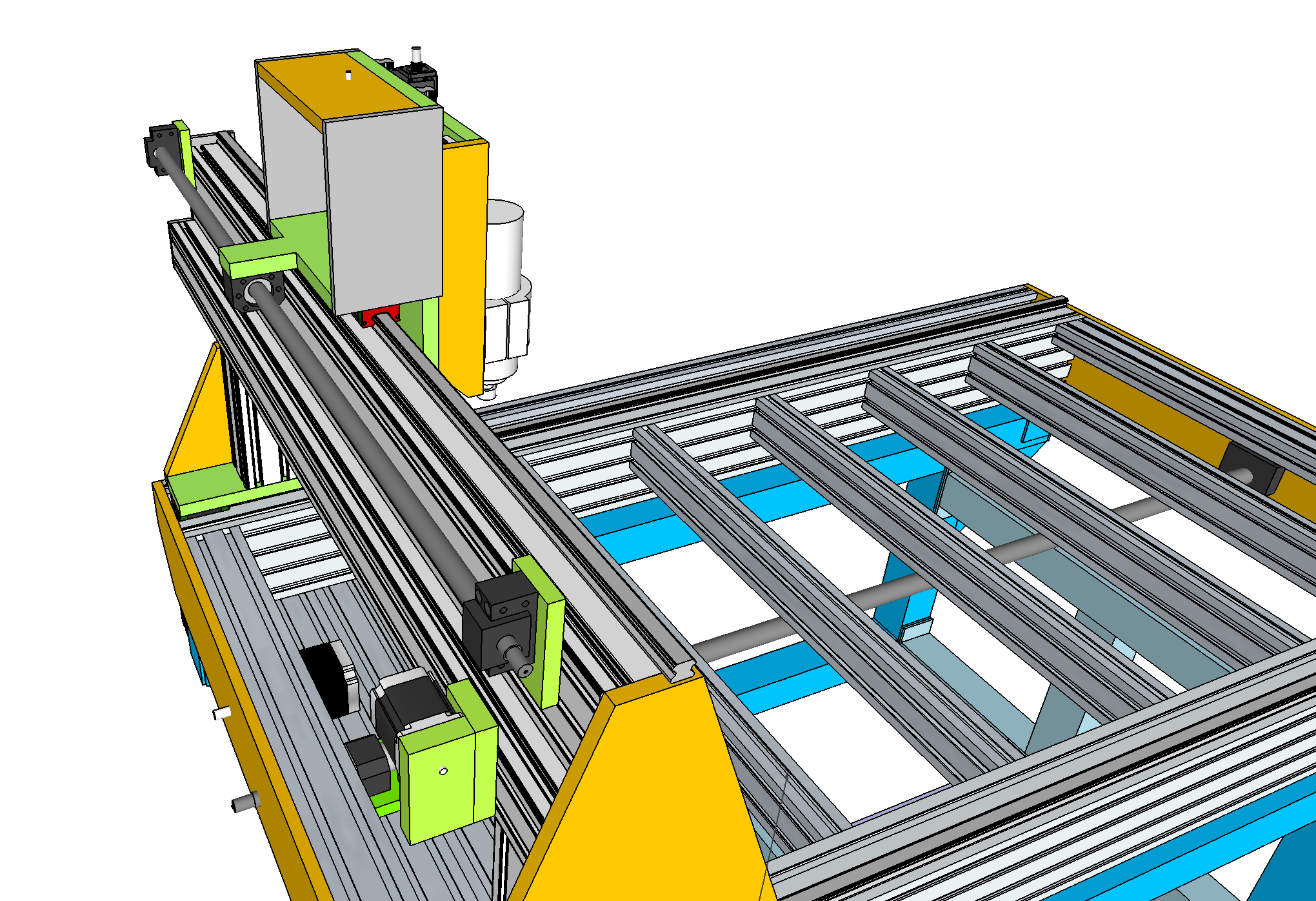

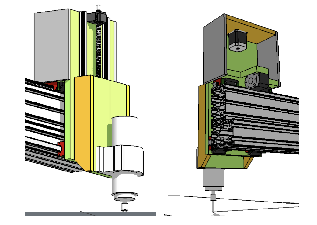

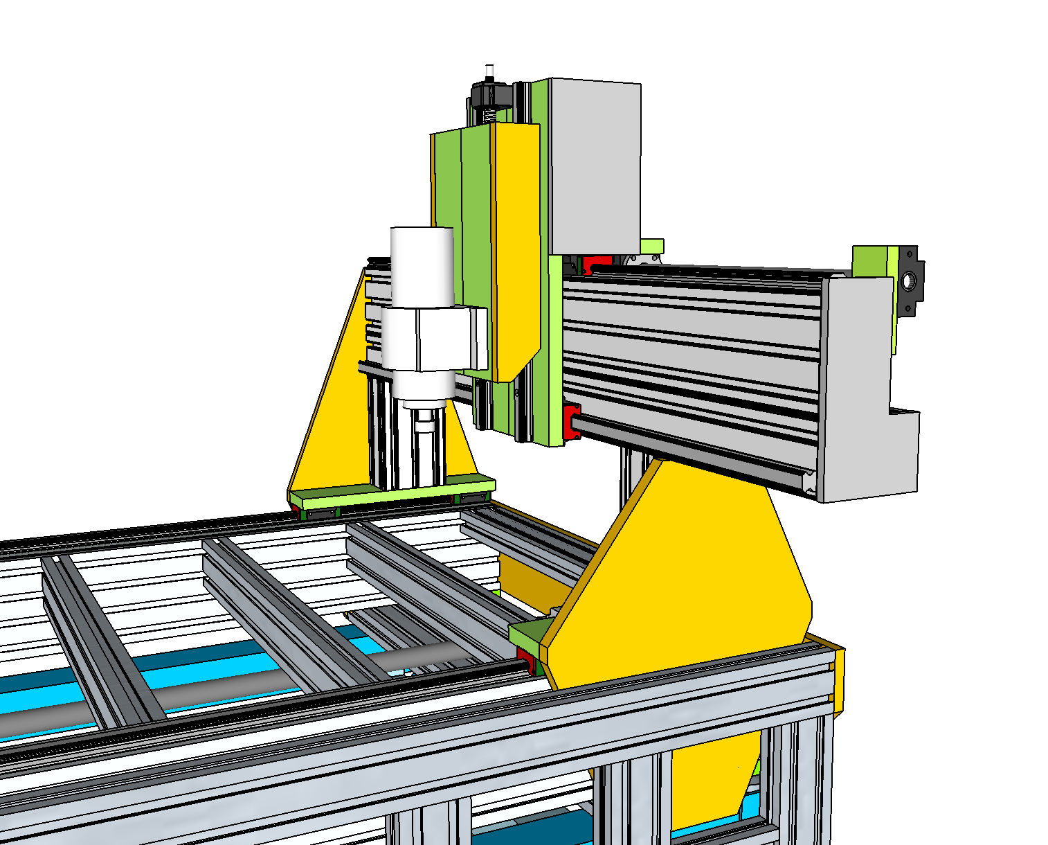

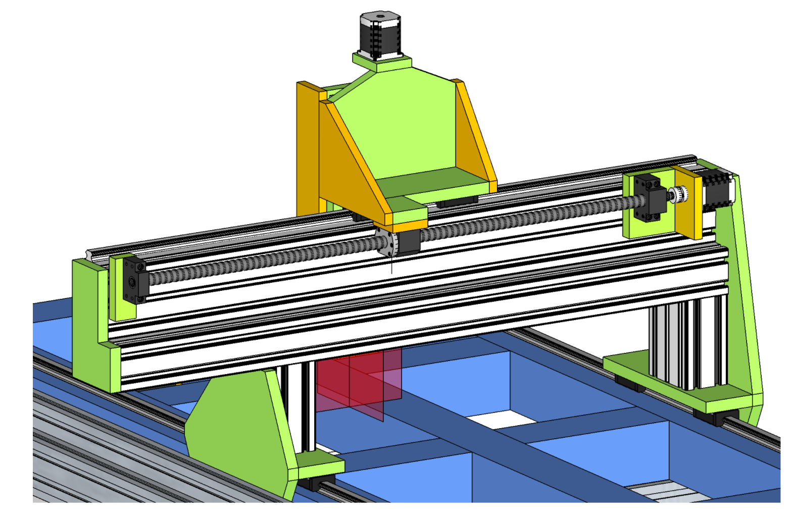

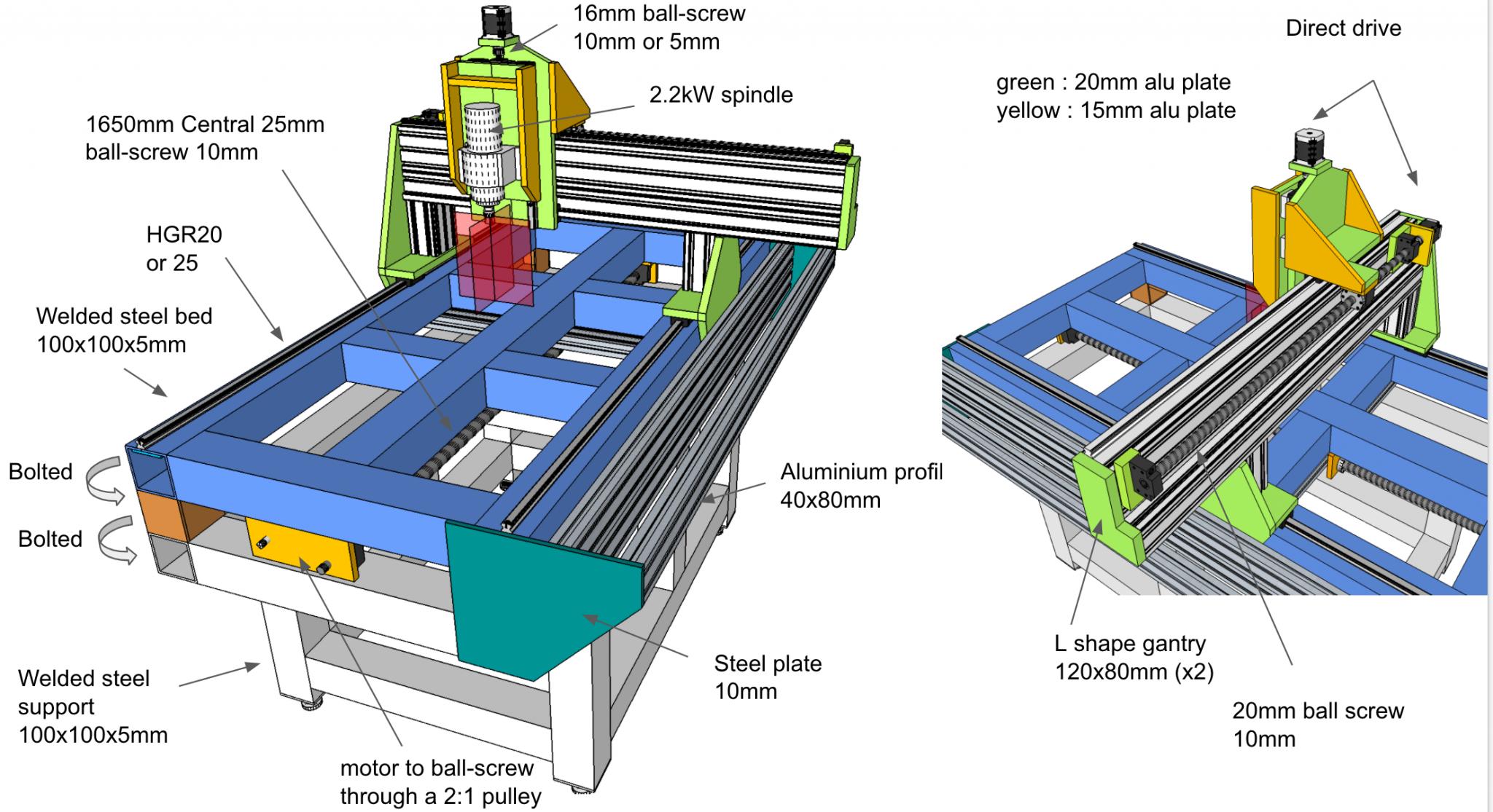

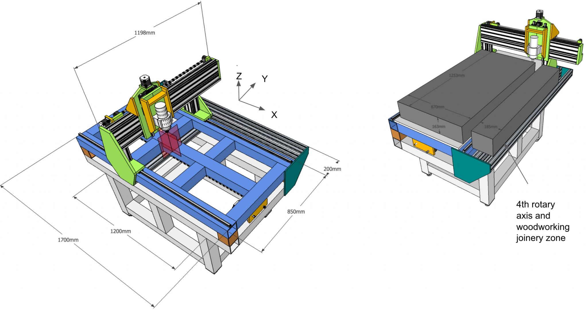

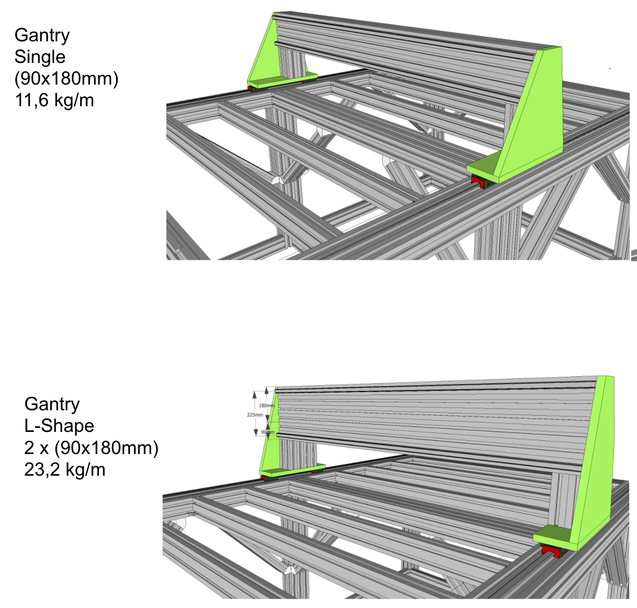

Hi Everbody,
After reading a lot and a lot of thread ! It is time to share my project ... I am a woodworker hobbyist and the machine will be 80% intended for wood panel and hardwood (occasionally aluminium if the machine could handle it). So the precision target is about 1/10 to 3/10mm and free speed likely 10m/min. The machine need to be taken to piece to go through a door and the elements could be carry without machine. I would like to use the table of the machine as workbench when it is not used for this reason I am not going on a canyon type of machine.
Here are some pictures and detail on the present version :
Attachment 28035 Attachment 28036 Attachment 28037 Attachment 28038Attachment 28039Attachment 28041Attachment 28040
Here are some of my concerns :

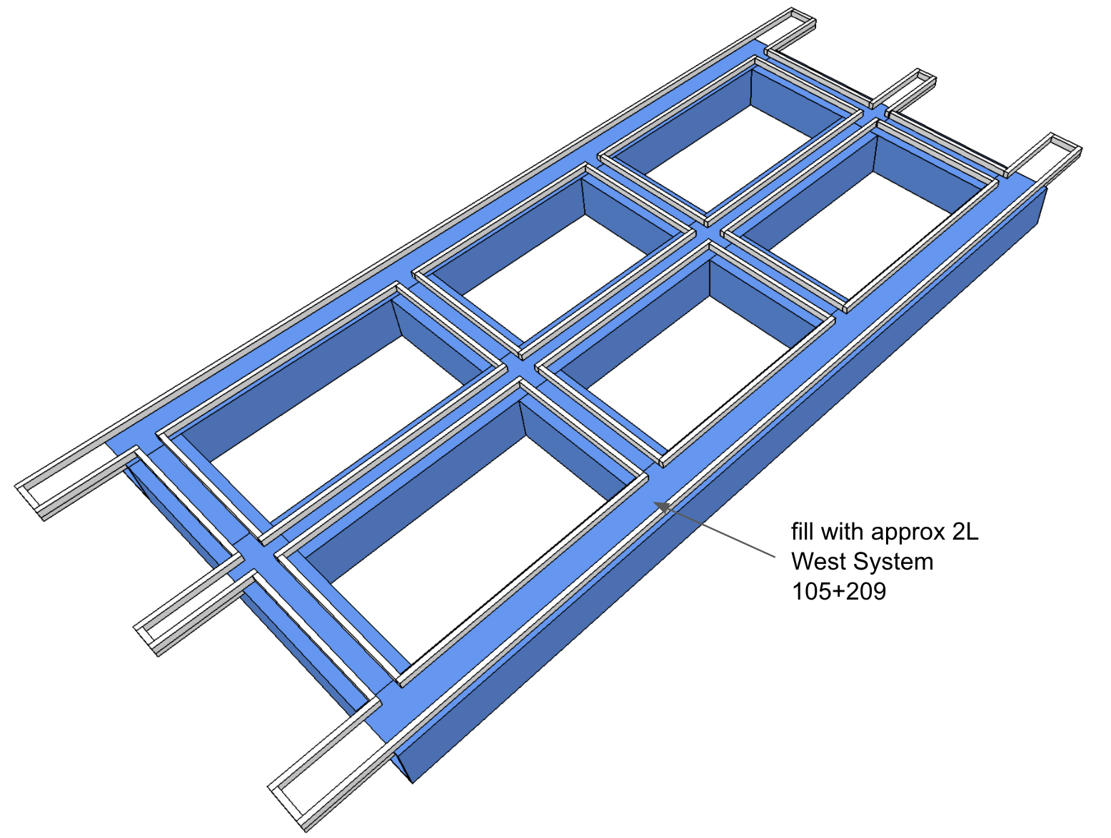

- My TIG welder is 30% at 150A so 5mm of steel is probably the thicker width it could handle so I choose 100X100X5mm thick steel profil.
- Probable need to put extra plate in the 100x100 X profil to have more steel thickness for bolting the rail ?
Bed and structure are independant part that are bolted together through a 100x100 cube spacing. I am not used to weld sutch structure but I thing that the distortion is not really an issue the support and will be corrected by West System resin epoxy for the bed. What you opinion on that point, do you recommend to cut the structure in smallest part and use bolt ? - I am planning to use WestSystem resin to set my X axis on the same plane and the bed at the same time, need approx 2L (see pitcture). In France I don’t find small West System pack than 5kg 105 + 1.4kg 109 (270euros).
- What are the essential measurement tools i think i will place an order soon. (I already bought a rule of 1m class 0)
- Some doubts on the ball screw diameters : 25 or 32mm ball screw 10mm pitch for the X, 20mm or 25mm ball screw 10mm pitch for the Y and 16mm ball screw 5mm pitch for the Z
- HGH20 or HGH25 on the X (or HGW)
- Could I have racking issue with an only central ball screw ?
- General opinion on the design and if the machine I correctly balanced ? Weakness point ?
Thanks for comments
Re: Gustave Build : Woodworking router
Hello Gustave and Welcome,
I've got a few suggestions that might help you.
#1 Don't waste money and time epoxying the whole bed it's not required, Just do the rails. You will 99.9% of the time have a spoil board on the machine which you will surface flat and parallel. So all you need is a baseboard that is flat, uniform in thickness, and stable ie: Not MDF.
If you are using Tig welder then distortion from heat will be much lower than Mig and you can control movement better. Take your time and move around so heat is spread around the frame.

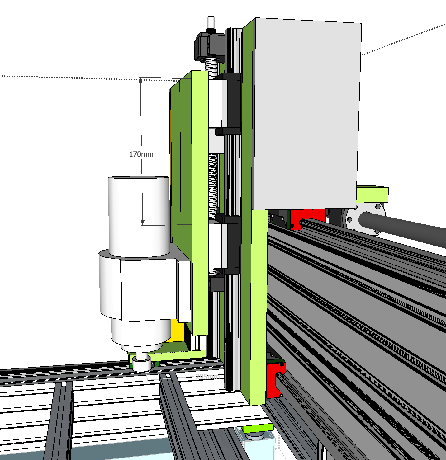

#2 Use HGW on X & Y as they provide more stability. I would even use them on the Z-axis but I realize you are trying to keep the width to a minimum. 20mm rails will be fine on all axis.
( you mentioned HGR as though it was a bearing, HGR is the rail, HGH and HGW are bearing types.)

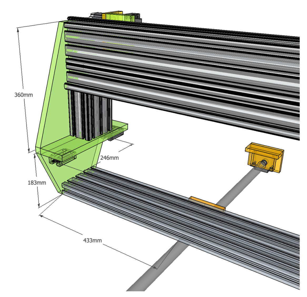

#3 The Z-axis bearings are spaced a little too close together and I would spread them out a little to improve stability. Even if this meant increasing the rail and rear plate length.
#4 Go with 25mm ball Screws for the long axis but use 25mm pitch not 10mm with a 2:1 ratio. This will half the screw speed and reduce any chance of whip. With the ratio, It will give the equivalent of 12.5mm pitch so a little higher feed rate but much lower screw speed.
20mm Screw with 20mm pitch with 2:1 for the Gantry axis. I know you have drawn it directly coupled but I would change that to belt drive for a few reasons.
It allows for the ratio to half the screw speed and it lowers resonance greatly which helps the stepper motors run much smoother. It also helps with servo's for similar reasons too but not to the same degree.
You didn't mention the motors your using, but if Servo's with 3000 Rpm then you may want to use a 3:1 ratio.
#5 Use Fixed BK bearings on Both ends of the Long screw as they offer a little more stiffness.
#6 You won't have any issues with racking at this width with this design unless you want to take very heavy cuts at the outer edges and even then it won't stall the machine, at worst you get a little deflection which doesn't really matter when roughing or hogging out material.
#7 Lastly, Buy a good large Square. This will help you set up the Gantry and Z-axis. My preference is a Granite triangle.
Don't stress over trying to achieve 0.001 precision for a wood router because it's just wasted as the material will move more than that. So what I'm saying is don't be paying Big money for precision instruments that you will never take full advantage of.
Hope this helps and good luck.

Hello Dean, thank you for this detailed and fast reply :adoration:
#1 In France the smaller 209 hardener I could find is 1.45kg … any advice for another product that I could find in smaller quantity in france ?
150a for 5mm thick it is enough ?

#3 I will spread the Z carriage, the actual distance is 107mm. Could you give me a recommendation ?

#6 The clearance between the X carriage is 250mm, is it enough ?

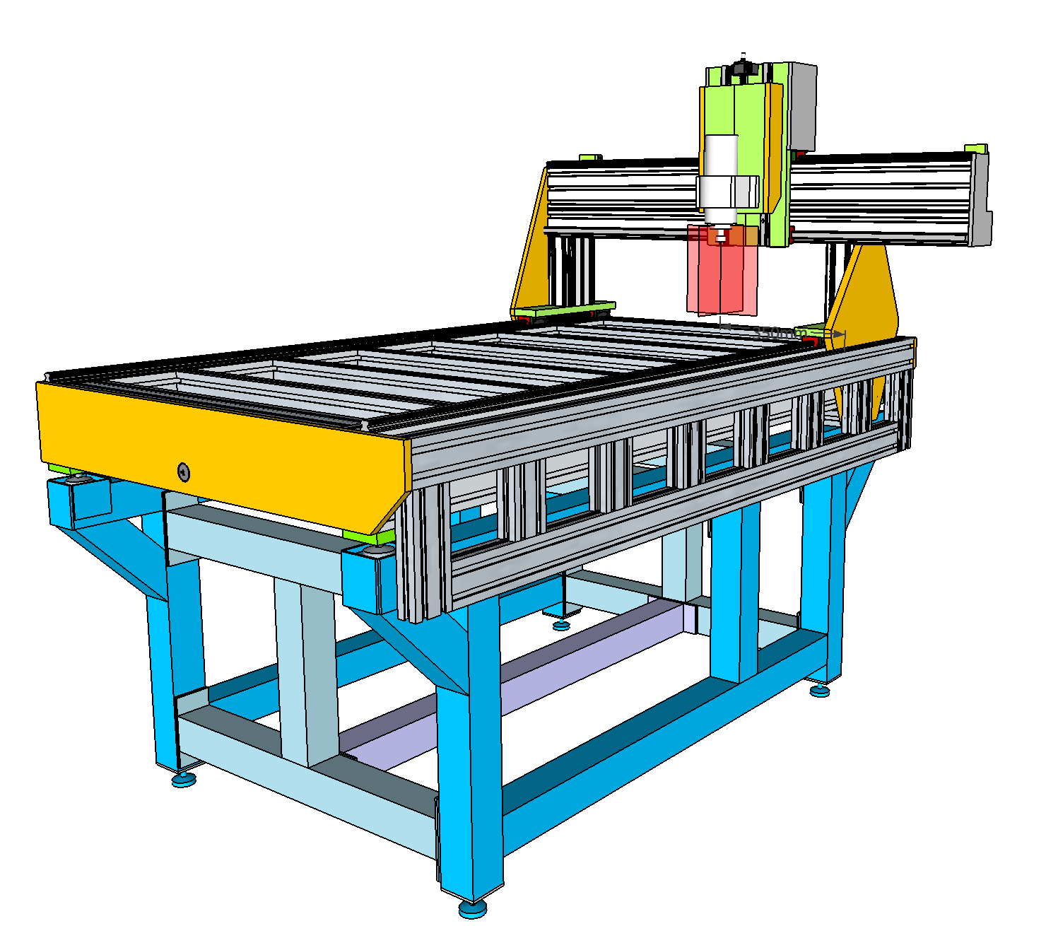

I have to change the design, the 100x100x5 base is more than 170kg (white parts on the skecth). I need to cut in several parts that to make the transport possible. I am thinking on where to cut and how assemble...
I am also thinking on making the two side plate of the gantry in steel instead of 20mm aluminium to limit the cost. Have you an opinion on that ? What the minimal thickness to be equivalent to 20mm alu ?

Gustave
Best regards
I wouldn't go less than 10mm in steel thou in theory 6mm would do the job as it's only for the cross brace but it's the resonance why I would use 10mm, unless you braced it up with a few Vertical strips.
To be honest I would use 15mm aluminum plate not 20mm for that part. Again could even get away with a 10mm aluminum plate but I wouldn't for resonance reasons.

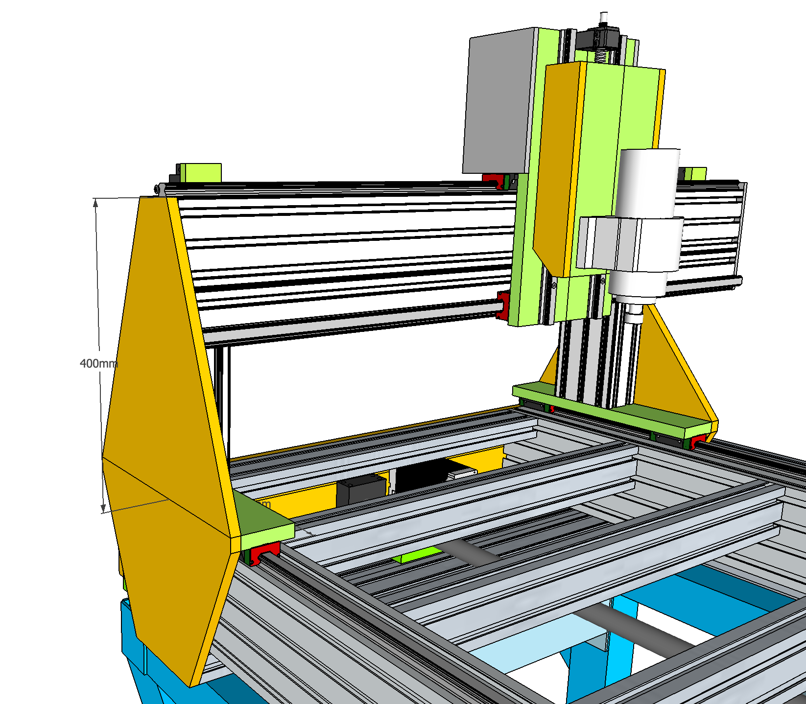

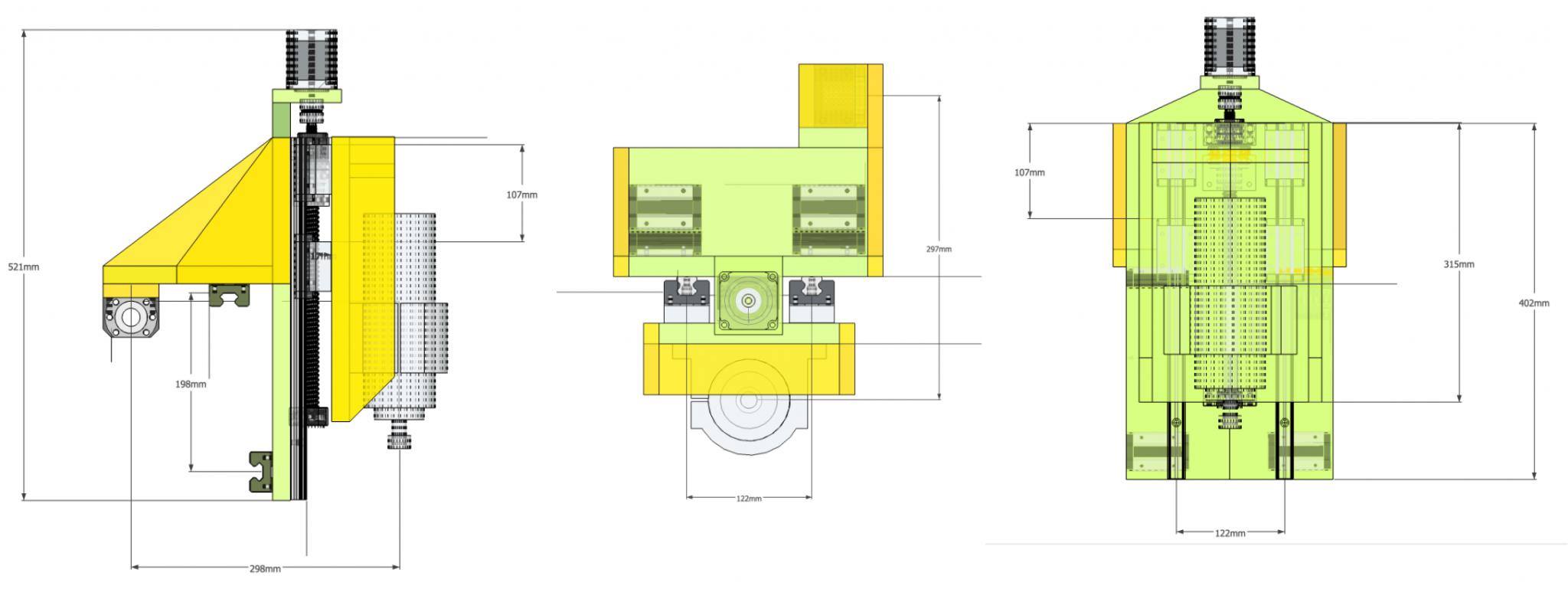

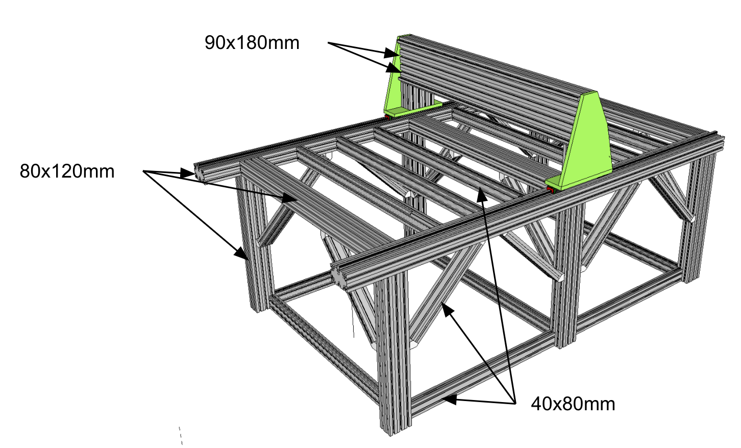

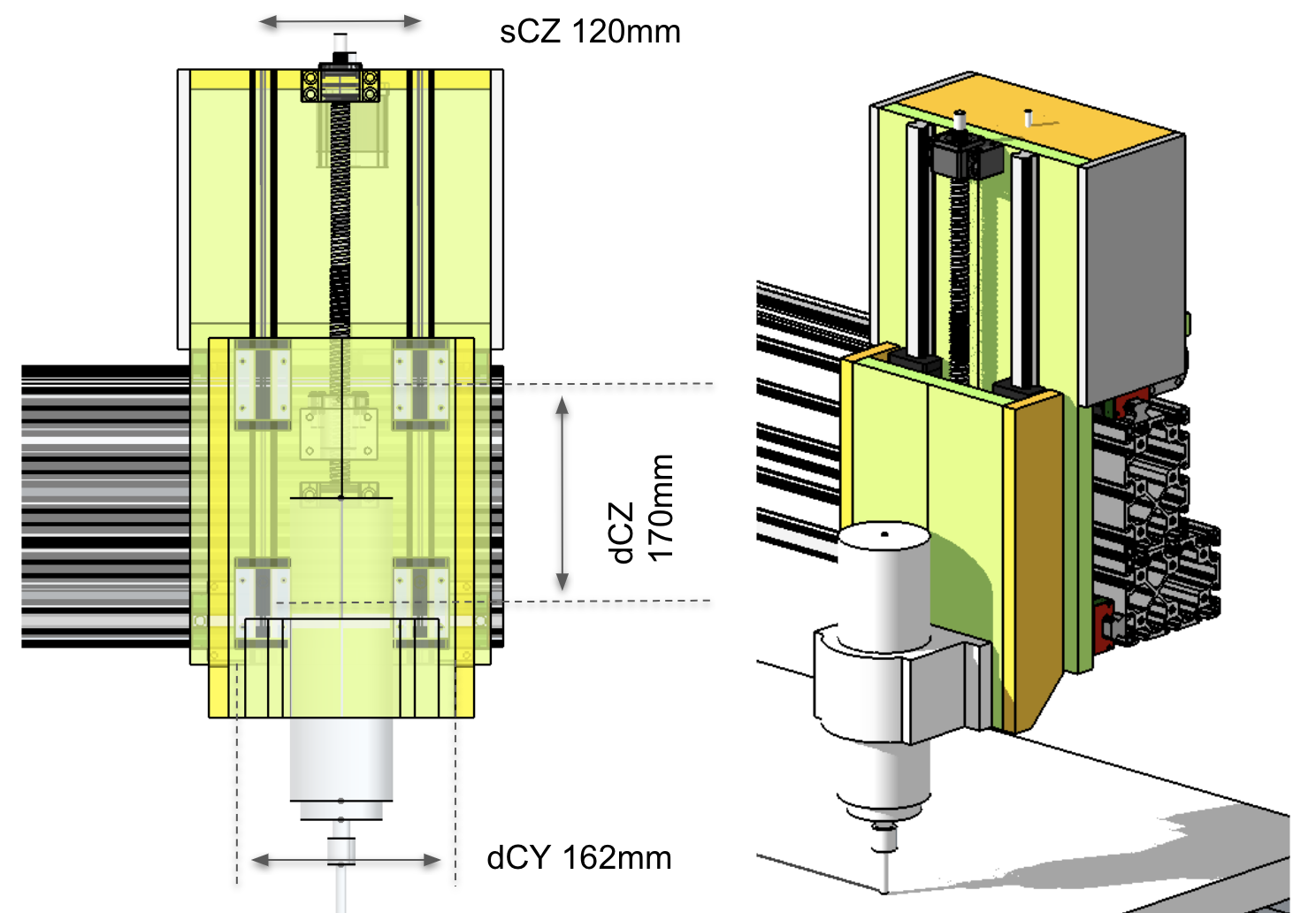

Here are some update on the design :
1+ 670mm width of the table -> 800mm
2+ steel bed -> 160x80 + 40x80 aluminium profil (270e for WS 105+207 is the price of the 80x160 alu profil…)
3+ the machine is placed on the steel base
4+ 100x100x5 -> 80x80x5 for the base
5+ base is cut in several parts
6+ thickness of the gantry side plate : Aluminium 20mm -> 15mm
7+ HGW carriage on X and Y axis
8+ side of the Z movable part is now turn on the Z fixes plate (more clearance around the spindle)
9+ clearance between Z carriage 107mm -> 170mm
10+ clearance between X carriage 245mm -> 295mm
11+ height of the gantry 360mm -> 400mm
12+ indirect transmission on all ball screw 2:1 or 3:1
Attachment 28079 Attachment 28080 Attachment 28081 Attachment 28082Attachment 28083 Attachment 28084
Questions :
#1: 25mm pitch ballscrew are very expensive (only french supplier or TBI) Fred don't have so for the moment I keep 10mm pitch. I can go on 32mm to increase max rpm of the Ballscrew (not so expensive upgrade) ?
#2: what do you think of the following servos motors sizing 400w for the Z with brake, 400W for Y and 750W for X ?
#3: recommandation for "low cost" and CSMIO IP-S well documented or easy wire servos driver
#4: central ball screw is still relevant with the slight increase of the width ?
#1 Have you asked Fred about 2525 balls crews because I've had them from him and he's advertising them on his site.?
#2 Those sizes will be fine.
#3 Wiring is no different for any servo, they all pretty much wired the same way. The servo tuning is most important but unfortunately Low cost and simple auto-tuning drives don't really go hand in hand. If you want easy tuning then you need drives which autotune and these tend to cost more. Look For Delta B series drives which are supposed to be good auto-tuning drives.
Why do you want Servos.?
#4 No, now with 800mm you have gone into 2 ball screw territory. The single screw will work but you will have to reduce the DOC/Feed at the outer edges.

#4 Even if I have increase X carriage space up to 300mm ? I love the idea that ball screw is protected under the table. I my workshop often carry long wood piece that could hurt the ball screw if I wrongdoing ... Do you have some photos of you double ball screw integration, you keep them under the table, do you conserve the under table Y bar, you use one motor per ballscrew or use pulley system ?... Sorry, I have so much question !
Extra length carriage would help but you are still on the edge. You can still have the screws under the table, my design you copied from uses twin screws. Either connected with belts or twin motors, I've done both. However, there are some things I'm not prepared to disclose so sorry no pictures.!!
