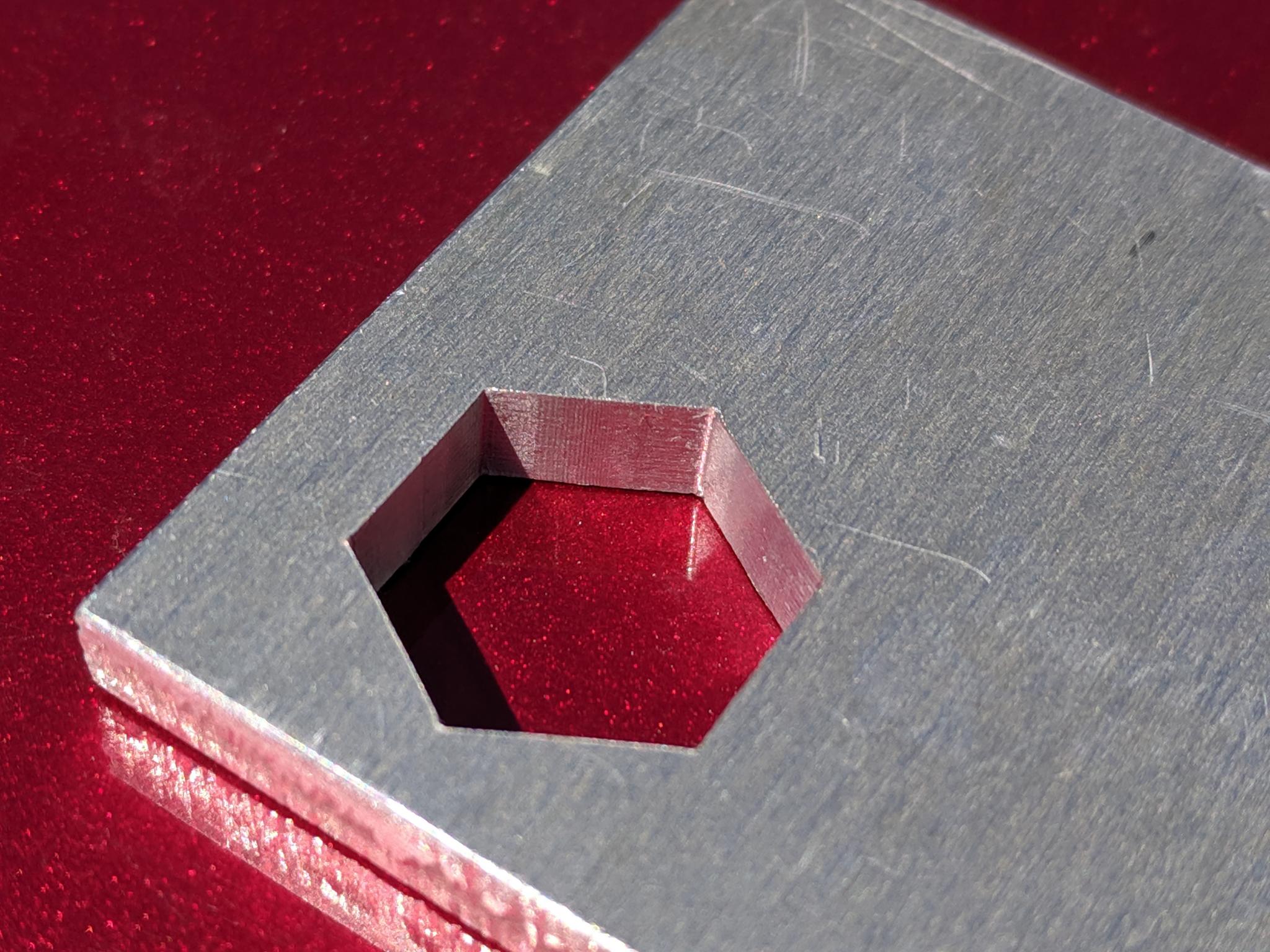

I was bored during the lock down and my mind started wandering.. I had a spindle encoder on my little mill and was wondering if I could gear the x/y axis to cut a polygon. One of the developers of linuxcnc did something similar on his lathe as a proof of concept.
So - it began...
https://www.youtube.com/watch?v=c9tWtEG1Exc
after figuring out my 144 count encoder wasn't nearly high enough resolution to do a decent job I upgraded to a 20,000 count per rev enocoder
Attachment 28063
Then putting it all together..
https://www.youtube.com/watch?v=PtD9w6lp8n8
