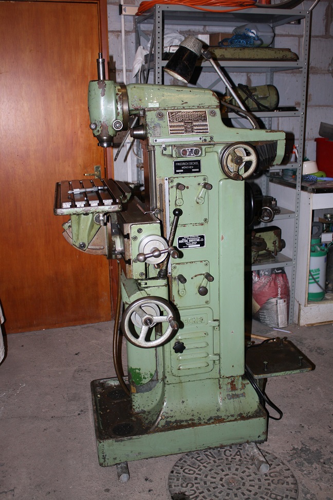

I did have a look at converting my old Deckel FP1 toolroom mill but It did not seem an easy candidate and I felt it would have been tantamount to butchering a vintage vehicle .

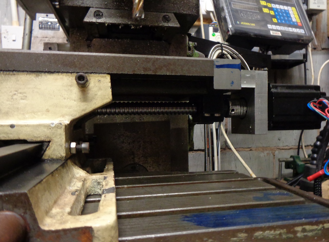

Attachment 28290

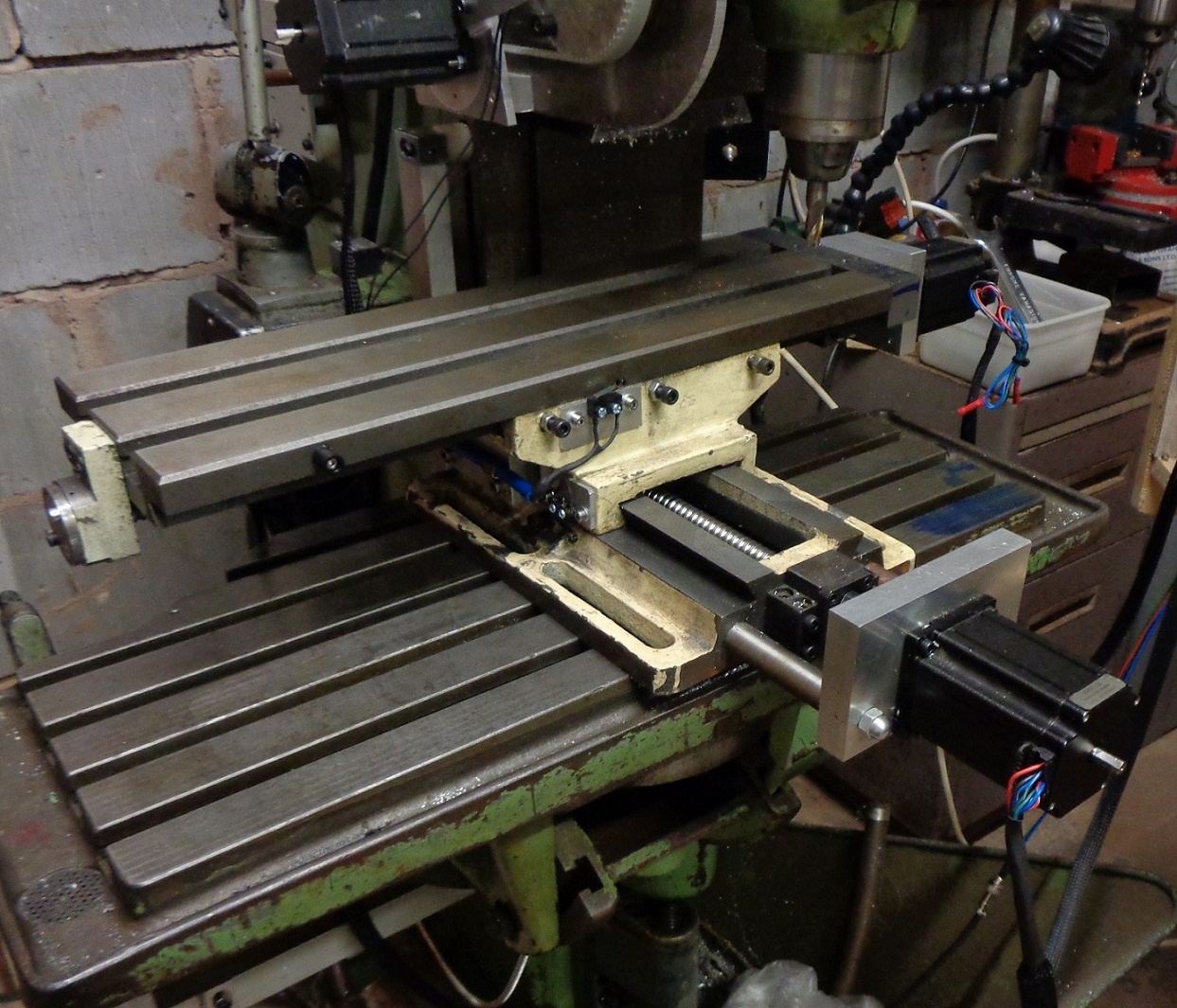

I explored lots of other options and came to the conclusion that one real possibility was to plant an X/Y table onto the machines own universal table .
This compound table from Axminster tools looked like a pretty good candidate . https://www.axminstertools.com/axmin...d-table-400385 It was reasonably priced (for a tight northern pocket ) and if things did not work out then not too much was wasted. Things got even better though because I found one on Ebay which was new, albeit with some transit damage, and I won it for the princely sum of £40 with a small carriage charge . When I planted it on the table of my mill it fitted easily with still about 200 mm of headroom , (and all the machines own feeds, and traverses still untouched and available if needed)
Attachment 28291 this Chinese compound table fitted easily with ample headroom to spare
The idea of a Compound CNC table as a removable “accessory “ was appealing as it was light enough to lift off the table and put aside, on the same trolley as my PC and wheel it away into the corner.

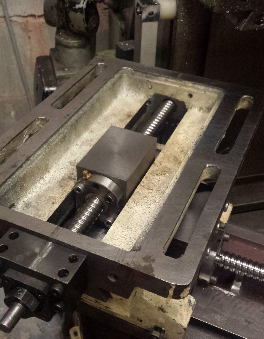

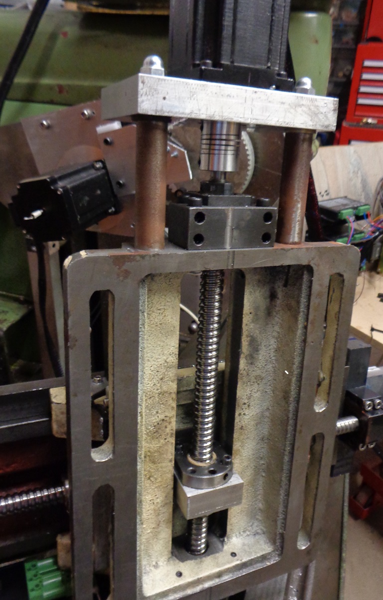

I dismantled the table and put aside the old leadscrews, which I have to say were pretty awful.
I was not really concerned , as by this time I had already decided to replace with ball screws anyway. I settled on a set like these. https://www.ebay.co.uk/itm/Ball-Scre...D09nBYWd-BzNAQ It was a risk but the british prices were so much higher and my guess was that UK suppliers were probably buying from here anyway. And even if they were not of the highest quality they would still be a massive improvement on my rough old table. I also knew it was likely that I would need to shorten them so I did not want to take risks with expensive kit. Delivery only took a couple of weeks and in the meantime I had work to do on the table castings.

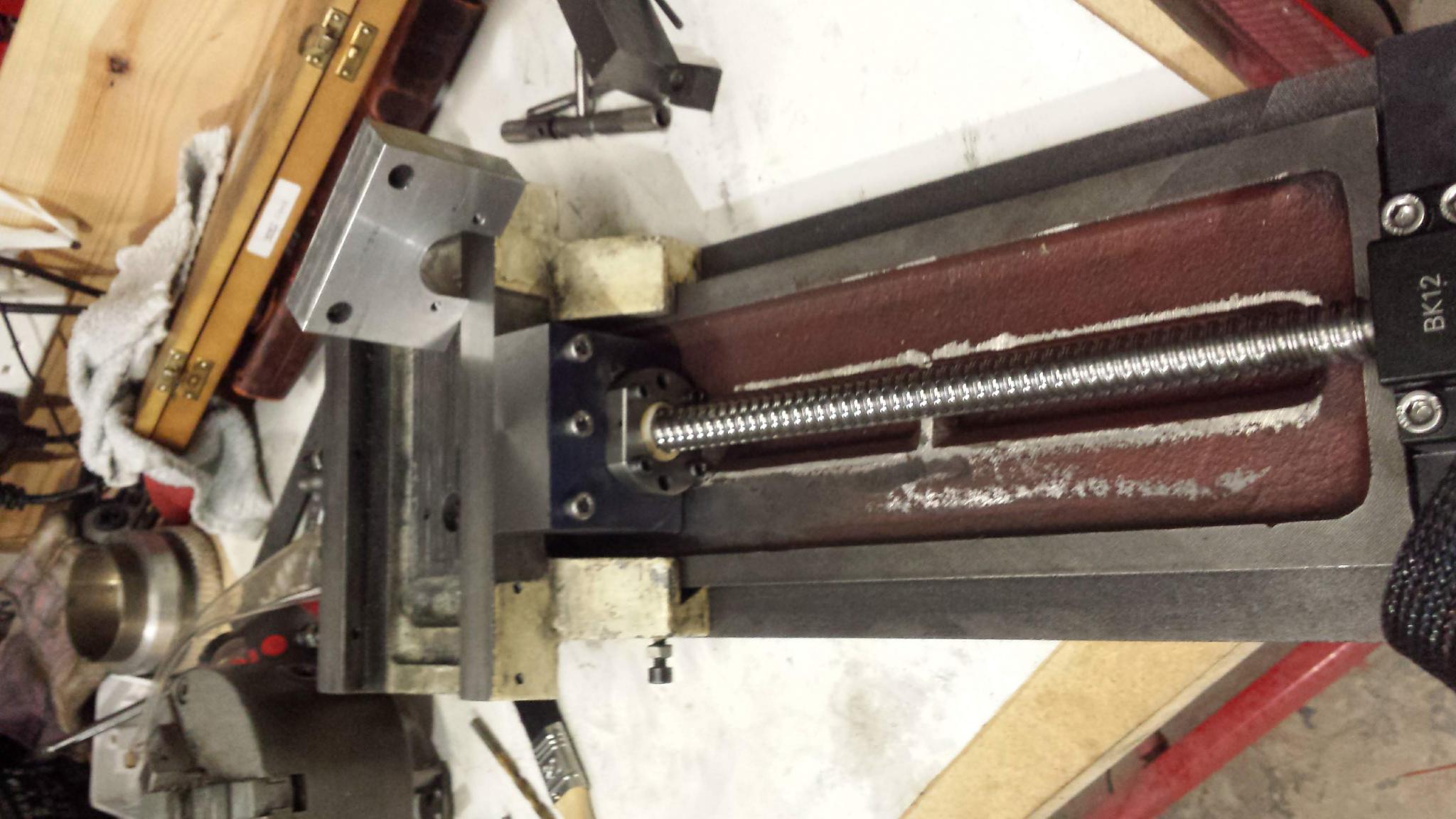

Attachment 28300 This ballnut mounting plate was easily fitted to the face of the saddle
From what I could see the dovetail slides were reasonably parallel to the front and back edges of the table, albeit that the machining was typical far eastern standard, but it would do for the agricultural job I was planning . With the table inverted on my mill and clocked to the back dovetail slide, the front and back edges of the table (and the other dovetail) were all parallel within a couple of thou. My thinking was that even if they weren’t true then as long as I could tighten the gibs to take out excessive slap, then it would do for me. I was pleasantly surprised though.
I did however run a big end mill over the end faces to ensure squareness with the slides and to give decent square seat for the eventual fit of end bearings.
I went on to do similar with the cross slide and base . I left milling of the seats for bearings until I had all the kit in hand in order to formulate a plan for mountings here. I ordered the remainder of my kit, bearings fixed and floating, flex couplings , motors and drivers, along wth PSU and breakout board, from Zapp automation.
With hindsight it might have been cheaper to buy the ballscrews , bearings, couplings etc as a set .
It may depend on the sizes , and whatever deals are going at the time https://www.ebay.co.uk/itm/Antibackl...harwYhBTXLHl6g

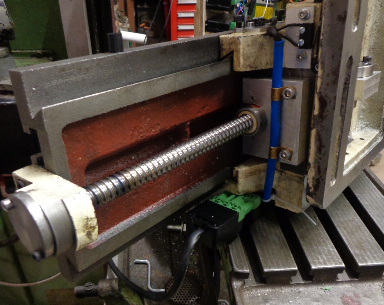

The arrangement of the ball screws and bearings turned out to be very simple and very much in a similar style to the original screws and mounts , and I was even able to recycle the old bracket on the table end . My first attempt at mounting the x motor did not take into account the endfloat in the motor due to spring thrust washers. When first powered up with a cordless drill there was significant back and forward shift. Plan b involved a steel block mounted to the end of the table to give a seat for a fixed bearing and also to give a fixing for the motor mounting brackets.
Attachment 28301
Please remember that this was always going to an agricultural exercise, a first attempt which might then lead me on to something more sophisticated , so the design is in keeping with that . I was however quite pleased with it when I eventually got it running and wonder how it compares with the typical new Chinese budget machines.

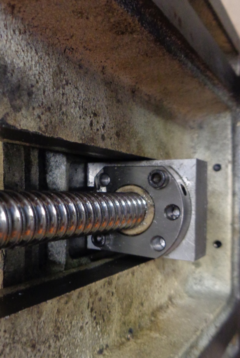

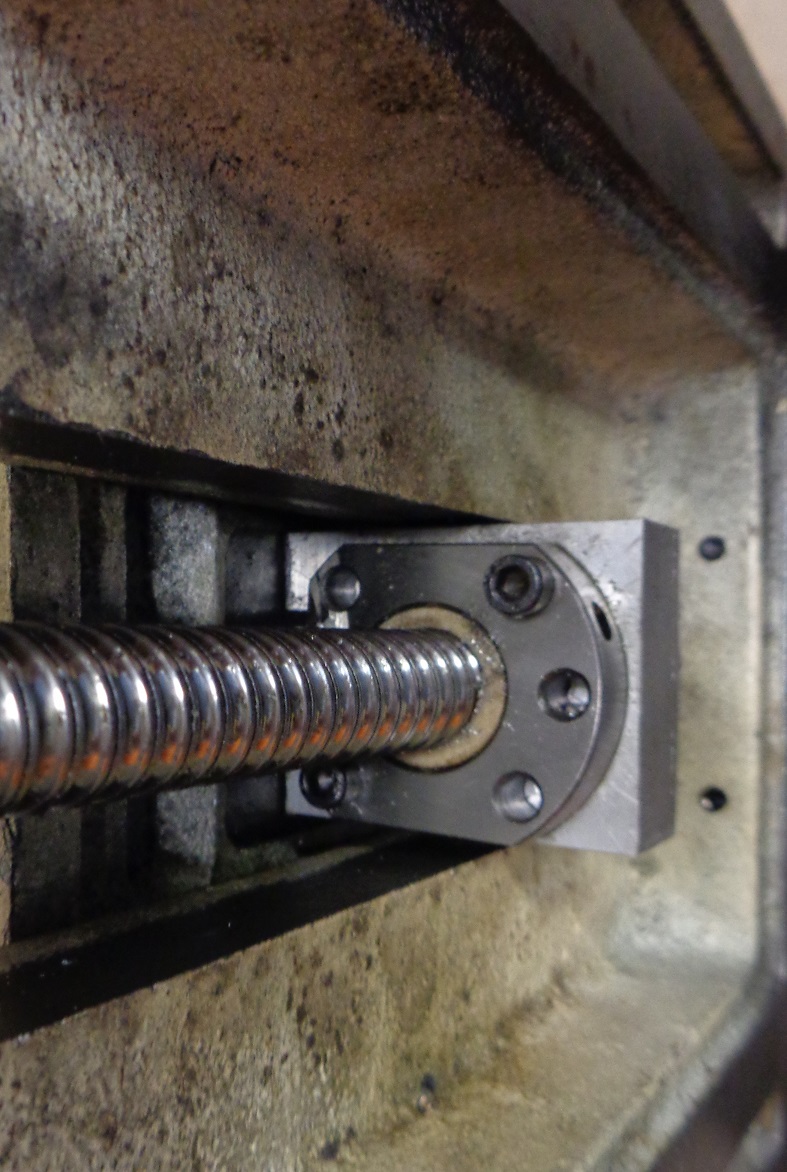

When all the gear was in hand I went on to start fitting the leadscrews complete with bearings and ballnut mountings . These were to be simple billets of aluminium bored to take the cylindrical part of the nut then milled out to form a u shape allowing for relatively easy replacement if this became necessary. They were drilled and tapped for the ball nut fixings and drilled for fixings to the respective parts of the table . I had machine a seat on one face of the saddle, parallel to the dovetails to mount the X nut, and a pad underneath the saddle to fix the Y nut.
Both of these seemed to mount simply enough where the old feed nuts had been .
Attachment 28385
These performed fine initially, and I was able to machine a few components with simple G Code routines which I had written myself. I went on to fit the homing switches, rebuilt the control panel and went on to add a few enhancements including a new breakout board to give me spindle start/ stop and speed control, and had a satisfying hour or two of play as I watched a milling cutter routing a pocket , but during that work it became clear that my aluminium brackets were not really up to the task.
Attachment 28386

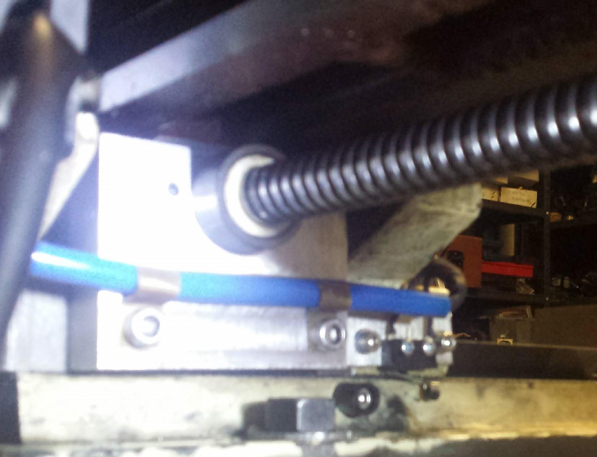

The X bracket seemed not too bad but there was significant backlash in the Y motion due to two factors. One being that the nut was not a great fit in its bore so was relying on its fixing flange alone. The second was that the “feet “of the U bracket which bolted onto the underside of the saddle were just too small for reasonable bearing of the bracket on its mating face, and would not really accommodate decent sized fixing bolts . It was also clear that Aluminium being soft and quite plastic was not really the best material for this job. So back to the drawing board !
Now as I have said before there were no calculations in this process. I went for the old principle of “give it plenty” and ordered a pair of cast iron blocks sawn from 70mm Meehanite bar. Then I set out to machine a new pair of ball nut housings which effectively would be as big as the table could accommodate .
6 Attachment(s)
Re: Compound table conversion of an old Deckel mill
So onwards and upwards as they say.
Material procured and I set off to turn rough cast blocks into some nice rectangular pieces . When I say “turn” I was being literal because the milling machine was tied up , and its high speed head would have been making sparks fly at 2000rpm, so my Colchester Bantam lathe was pressed into service to reduce the blocks to size and to bore good fitting locations for the ball nuts.
In addition I needed to skim a larger seat for the “Y” nut so the toy Seig SX2 mill came into play too. I have to say that as a toy milling machine it made a pretty reasonable job, and in particular I found it was superb as a drilling machine when I came to drill and tap for the fixing bolts .
The “X” nut block was a simple replacement, marked off and drilled using the old Alloy block as a template and jig. It barely cleared the underside of the table when fed from end to end , but by dressing a few high spots and lumps with the grinder, it then traversed freely. I may just take a light skim off the underside with the toy mill to ensure that nothing catches
The “y” nut mounting was quite a lot more fiddly though, as I had to bore it fairly precisely in order to avoid shimming underneath it to align it with the ballscrew and nut . Nevertheless, and maybe more by good luck than good management , the nut slid quite easily into its bore with the block tight down onto its seat . Four M6 cap screws secured it firmly to the saddle and I intend to fit a couple of dowels for additional rigidity.
So with the new blocks fitted this
Attachment 28420
Becomes this
Attachment 28395
And this
Attachment 28394
becomes this
Attachment 28398
All reassembled and now seems good and tight, so will now reinstate the homing switches , (I bought some more substantial ones from RS) adjust the settings in Mach 3, and give it a cutting test.

So it is now working again after a few hicupps and alterations to settings.
Not sure if any others will be tempted towards a similar project. Albeit it is an economic route to a CNC function if you already have a decent sized milling machine to begin with.
I like the idea because (as I said above) it saves interfering with the mechanics and drives of an existing machine, and in particular where modifications might detract from the value of an older and possibly much sought after machine.
I can easily unplug my table and set it aside if I want to use the machine as a manual mill. Or I can even do a manual manual job with the CNC compound in place, using the Deckel mill’s own feeds and traverses, although I do recognise that rigidity will be a problem for larger jobs.
I always wondered, if I converted my machine to CNC then what would I do if I needed to do some simple conventional milling, but no problem here.
