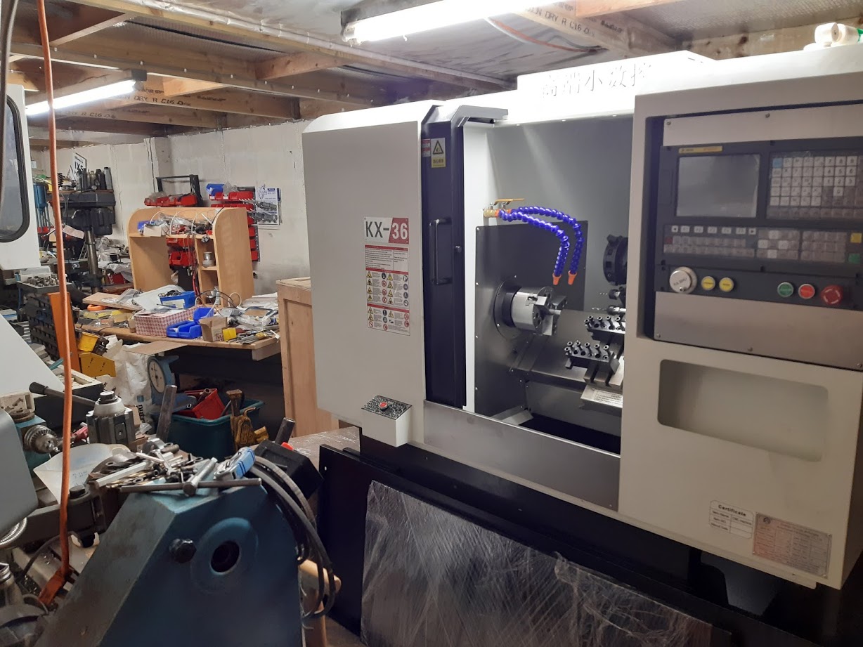

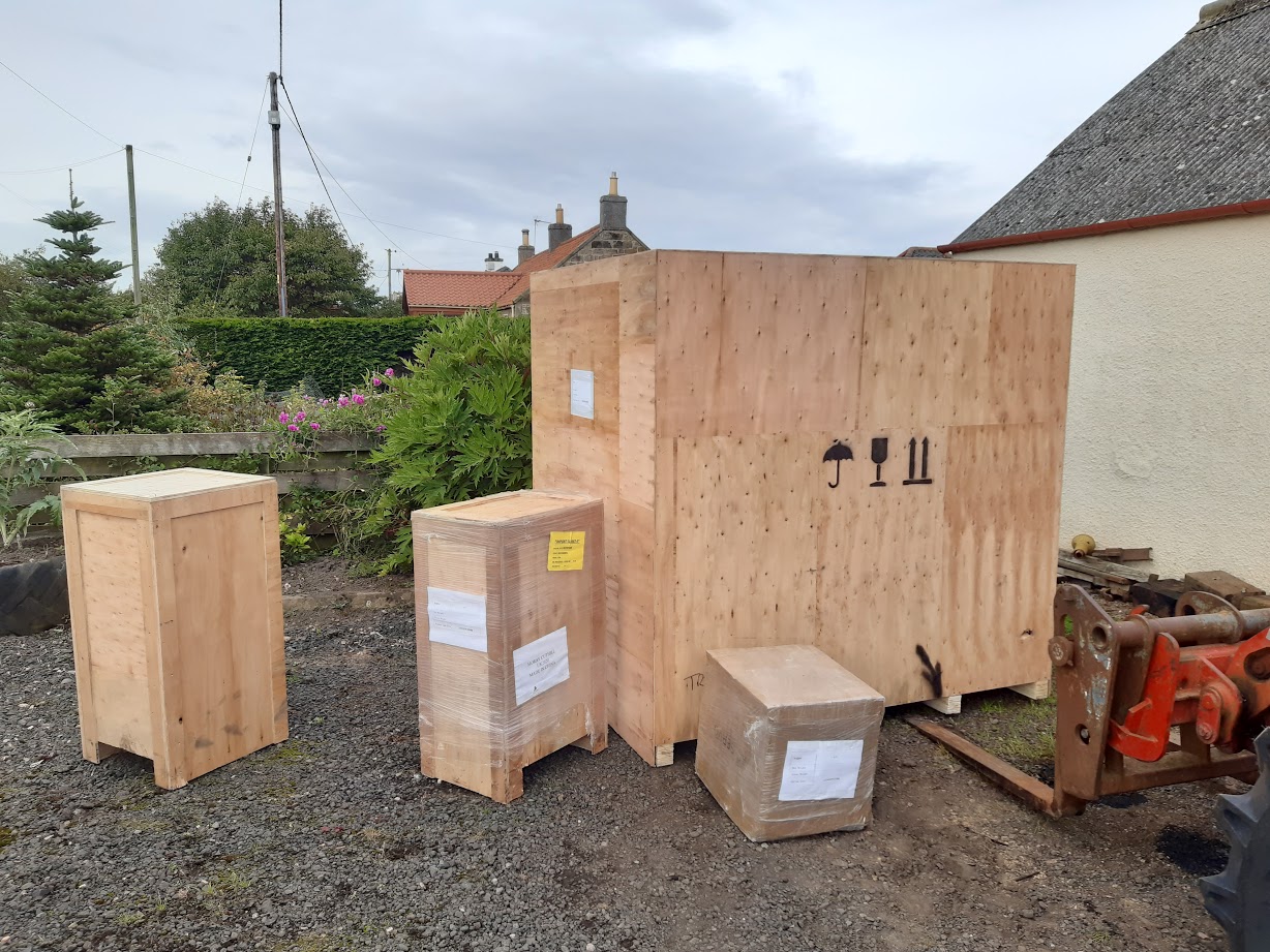

The result of that, is this collection got delivered this morning -
Attachment 28829
They should have been delivered yesterday, however there were other shipments within the same container that customs decided to target, so the whole container got held for over a day, before the shipping company were allowed to unload the non-targeted shipments.
The machine is now in the workshop. It's still not in it's final spot, as I need to workout how much room the bar feeder needs, which is going to depict the final placement, and the main bar feeder tube is still in it's crate.

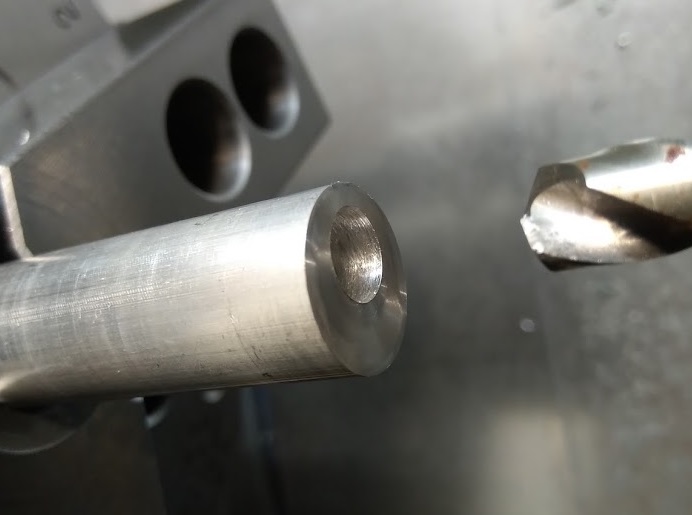

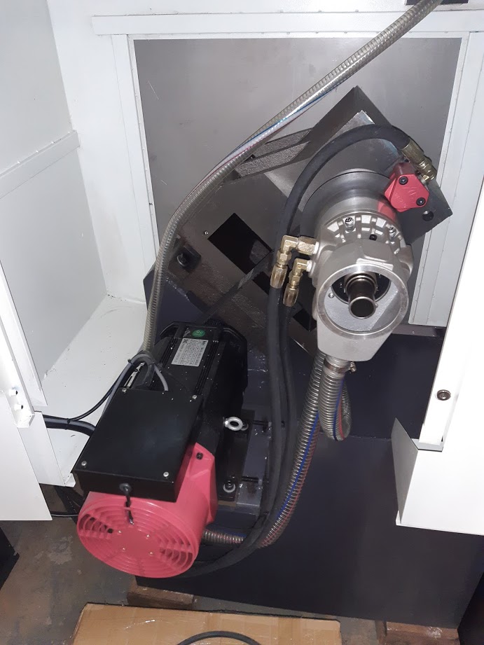

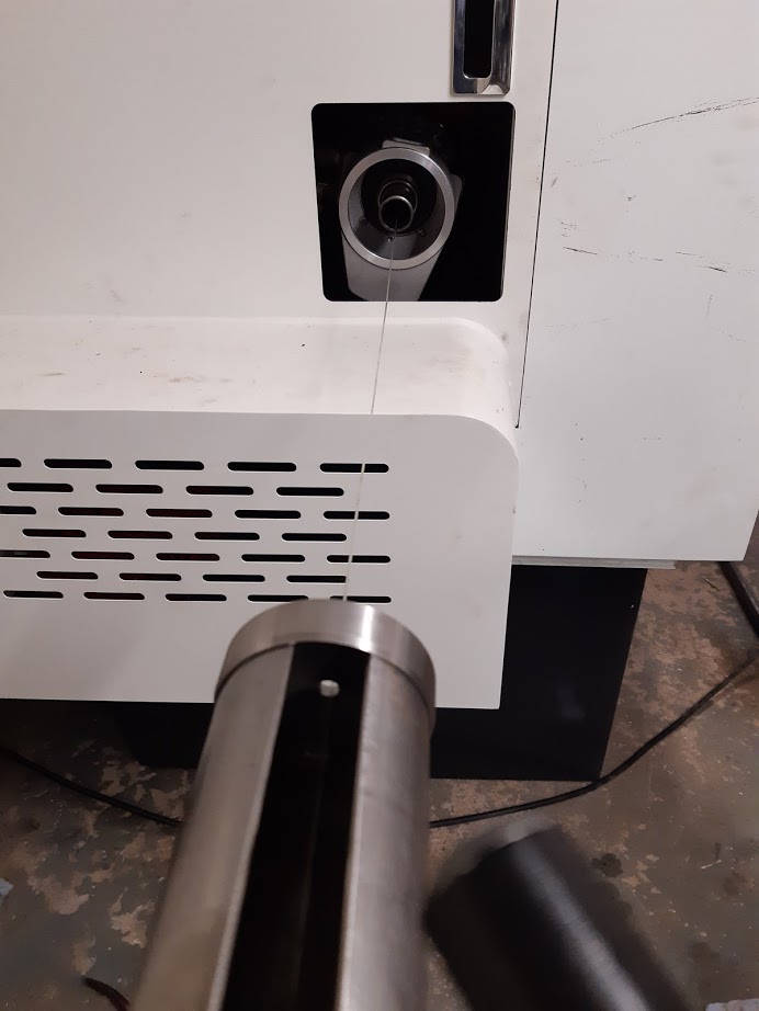

However, I did put a plug on it, and it powers up.

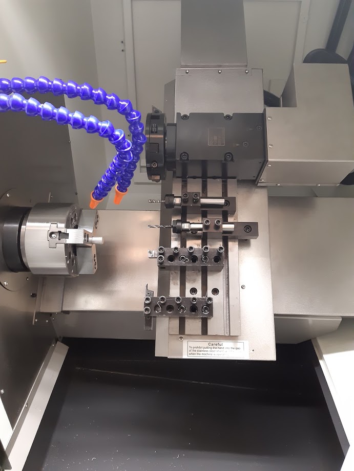

Attachment 28830Attachment 28831Attachment 28832Attachment 28833Attachment 28834
Key specs are -
36mm spindle through hole.
5.5kw servo spindle with brake on spindle.
Taiwanese hydraulic chuck.
Live tooling fitted with Polygonal turning head, which also has an ER collet in the centre.
700mm X travel
230mm Y travel
Single bar feeder.

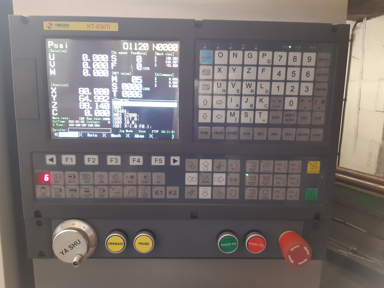

A few things that stand out, is the pre-sales support from the supplier was brilliant. Any questions I had were answered. I was going to opt for the GSK control, but the manual supplied for the company's own panel was pretty good. Some of the translation isn't great, but it's entirely understandable, with the exception of some of the more complex geometry feed options.
After production the machine was programmed to make my sample part, and a video sent of the machine in operation.
I'm out riding bicycles tomorrow, so it's probably going to be Sunday before I get it moved in to it's final spot, and get it making parts.
For now, I'm off to read the manual to try and figure out how you home the thing...
