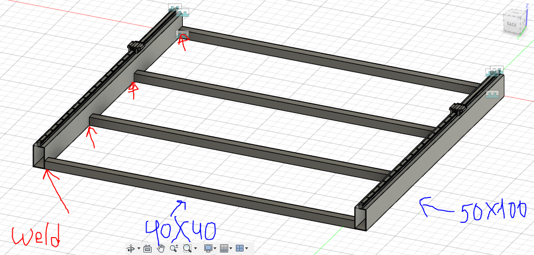

Im currently designing moving gantry CNC mill, the design will be a poor mans version of this:
Attachment 29134
The Design :
The main use for the machine will be plywood/mdf, with some occasional aluminium milling .
The table will be made of 40*40 box section profile with 1.5mm wall, partialy welded and partialy bolted (so i could move it later)
For the frame - ontop of the table I plan to use 100*50 RHS steel profile with 3.2mm wall - (two beams under the linear rails) in between them i will be welding 40*40 box section supports for the spoil board. also the two beams with bolts to the table.
for the rails i plan to use 20mm HGR linear bearing
I tryed to use the calculator that"CNC router" made in the pined topic in this forum, as far i understand the results the tool deflection should be less then 2.5micrometers
http://www.mycncuk.com/threads/2023-...ign-principles

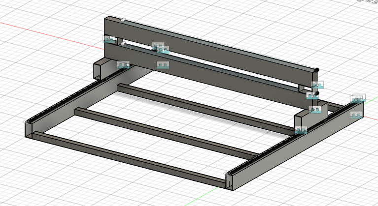

For the gantry i plan to use 300mm 50*100 RHS on witch the catridges are mounted and those pieces will be welded to the Y axis beam made of 2 beams length of 1500mm and 100*50 RHS
and here the deflection (bend and twist) should be less then 50 micrometer
so as far as i understand the calculations give 4 time the precision i try to achive
The questions:
1. To get the X axis flat and coplanar between the two beams i have seen lots of methods but as i sayed this is a poor mans build - i dont have access to precision grinding machines and using a dial - i dont have reference flat surface... so what other methods can i use?
2. The X Frame will be welded to get more stiffness - although the steel can get twisted - how can i plan my design to compencate for that later?
Edit:
i have added some screenshots:
Attachment 29135
Attachment 29136
the red arrows shows where the frame will be welded and the steel dimentions, i intend to use 2 types of profiles: 50*100mm with wall 3.2mm and 40*40 with wall 1.5mm

I am a bit reluctant to comment on your design, if you had read any of the build logs you should be aware that Rolled H section is a bad choice. Did you read AVOR ?
better option is to fabricate a beam from 50x50. or get your hand in your pocket and buy some heavy duty ally profile. Dean uses this on some of his big builds,steel is cheaper.
Draw your creation in CAD and you might get better feedback.
Good Luck

One option for leveling is to use low viscosity, slow setting epoxy (such as West Systems 105 resin and 209 slow hardener) on top of the beams. Search the build logs and you'll find several designs that discuss how best to do this.

i think i wasnt that clear about my design - so i sketched something to explain it alittle better (in the meantime im working on somthing more detailed)
any way i will not be using no i beams or H sections but regular rectangular hollow section steel tubes dimentions of 100*50*3.2 and 40*40*1.5
for the epoxy method i have seen some builders use that method - but are there any other methods?

Think I've told you this in another thread but those tube thickness's are not a good choice, esp the 1.5mm.
Regards methods of leveling then if you don't have any way to check the rail plane then you'll be better using the epoxy method as it gives the best accuracy for a large machine without needing a reference surface.
However, If this is your first machine build then I suggest you exercise caution and research much more than you have already. Many people think it can't be anymore difficult to build a large machine as it would be a small machine but in practise this isn't the case. Every little error is magnified and if you haven't learnt the gotcha's on a small machine then they will bite you hard on a larger machine, many first time builders fail when they try to build large.

I assume by 50 you actually mean 5 mm (wall thickness)?
The calculator is correct for ideal conditions, perfect joints, and does not include vibration. So it is just a guide and great for comparing relative performance but real deflection will be a bit higher due to factors not included in the calculations.

I was the guy who wrote up the "AVOR" design as mentioned earlier - which has proven to do a decent job for me even if it looks like a disaster area.
However, one of the main things I would change if I were doing it again (and I don't have plans to do that anytime soon) is to go up from 3mm wall thickness steel box to 5mm. When cutting harder materials especially there is a certain amount of resonance/vibration that you can feel as a buzz through the whole machine. May not be needed for strenght but just simple mass. There's a reason why commercial milling machines are made of cast iron - yes, rigidity is one reason but simple vibration damping is another.
I can only think that 1.5mm is going to ring like a bell!
