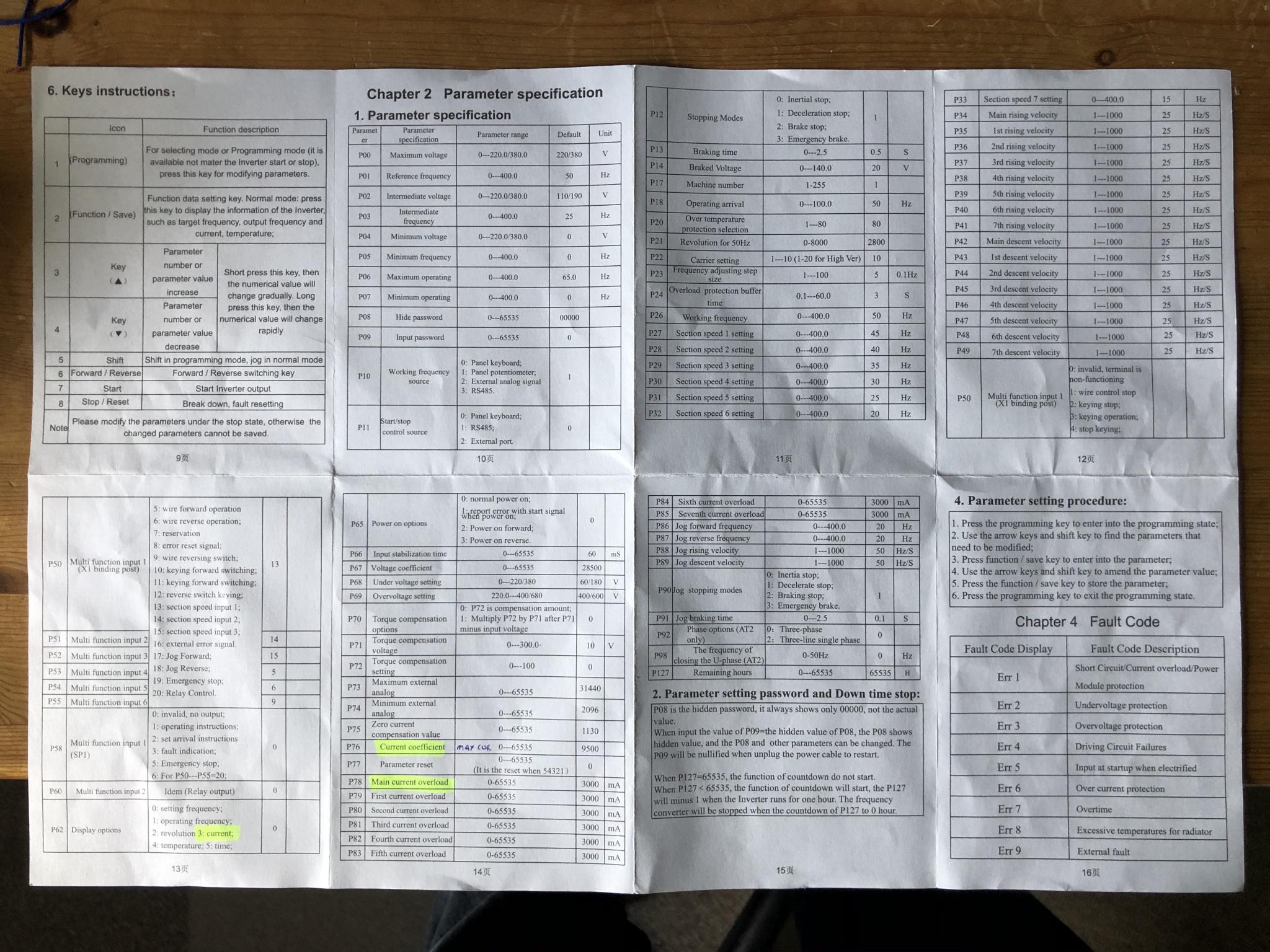

Attachment 29718Hi Everybody.
My first post since joining this forum, here goes.....
Im just setting out building my first CNC router table. All was going well until I decided to fit it out with a water cooled spindle & VFD. Watching the pennies I opted for an Ebay 1.5Kw Water Cooled Spindle and an unbranded XSY-AT1 VFD, both have reasonable reviews!
Firstly:
On powering up the VFD i get two codes displayed. 19103 then 13001 if anybody could tell me what they mean I would be very grateful as I can not find any information on this.
Secondly:
What seems to be the age old questions, the VFD settings. Has anybody got the same configuration(below) as mine and are willing to share their settings?
The motor is 220V / 400Hz / 1.5Kw
https://www.ebay.co.uk/itm/CNC-1-5KW...V/180730060933
The VFD is XSY-AT1 / 1.5Kw max current 8A.
https://www.ebay.co.uk/itm/AC-220V-1...K/183948451717
I've attached a photo of the parameter sheet as the code numbers seem to be different depending on which brand VFD it is.
The codes I have changed are
P01 Reference frequency - 400
P03 intermediate frequency - 200
P06 Maximum Operating - 400
P07 minimum operating - 0
P21 revolution for 50Hz - 3000
P26 working frequency - 400
P78 main current overload - 6000
The motor runs with the above setting but when I started to increase the speed there was a small wisp of smoke from connector plug or thereabouts. I stopped the motor, and after a check with an ohmmeter reckon I saved any damage.
Any advice most welcome on my setting much appreciated as I'm starting to disappear up my own tailpipe with this.
Many thanks in advance.
Nick

Re: VFD startup codes. What VFD settings for a newbie
This is not the exact same driver, but has some similar features and may be of some help.
I have it in PDF format and don't know how to attach it here so I added it to my dropbox
https://www.dropbox.com/s/zl6cdfbe7n...-220v.pdf?dl=0
Different motor but this video I made a while back might help a bit
https://www.youtube.com/watch?v=JrIEI-4Iupo&t=2323s
