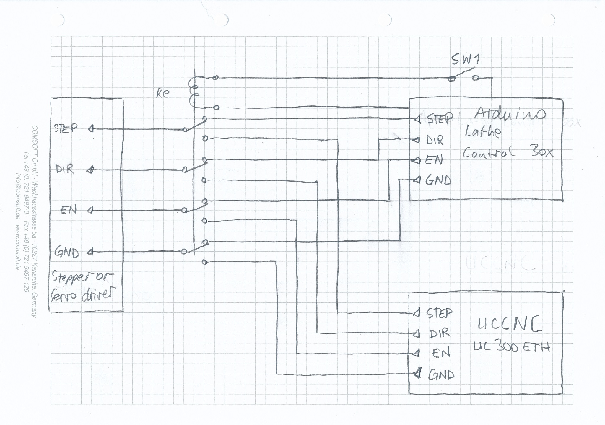

		Skip one driver and switch the control signals step, dir, enable and gnd. This is what I am doing on my DIY lathe / 4th axis combo. I would not switch the stepper wires. Beware that if you have some interference then you might get some extra steps, so you must be careful with the wiring.
		Re: Run a stepper from 2 DM542 drive
		The only safe way is to switch the step/dir signals, you will 99% blow the drive if you swap the motor wires when the drive is powered up.
