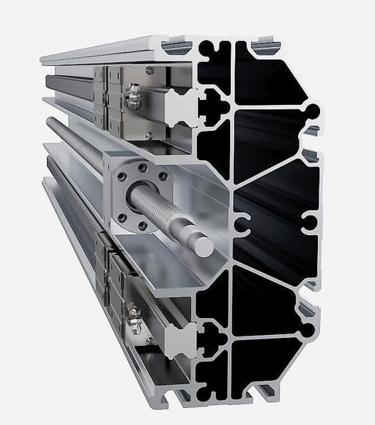

Cheers Boyan, that looks neat.
Re: Aluminum gantry Profile
Along the same lines as the C Beam profile you can buy from various places, have to have a closer look at that profile when I get time lol
martin54
the C beam is something else, for cheaper builds, does not accommodate properly square linear rails or ball screw, its more for ultra low cost builds or better suited for printers.
