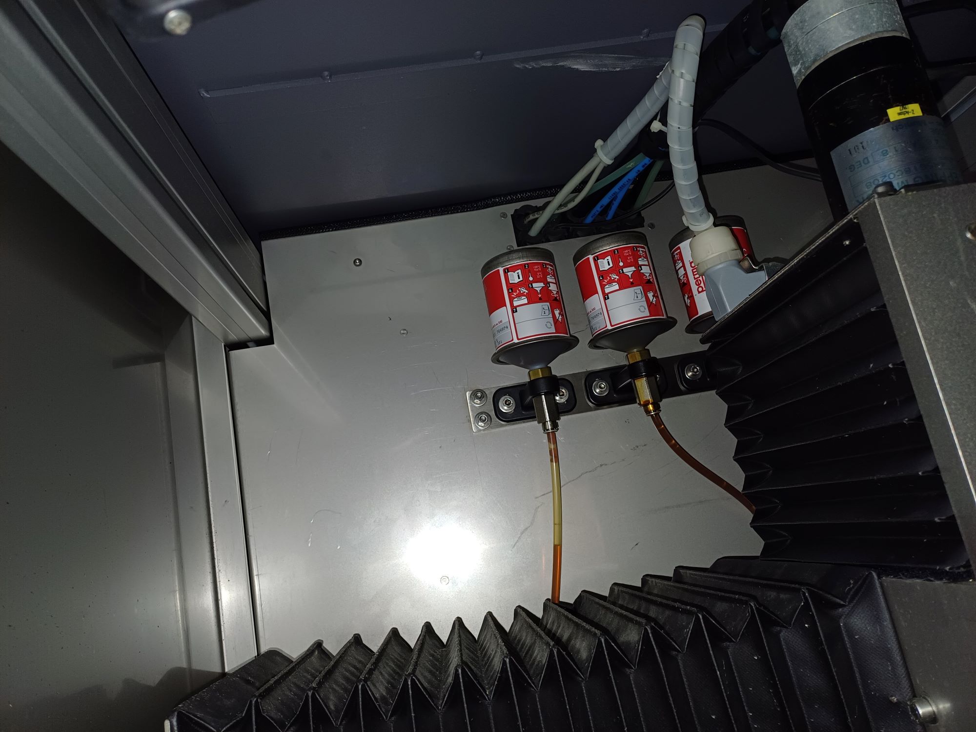

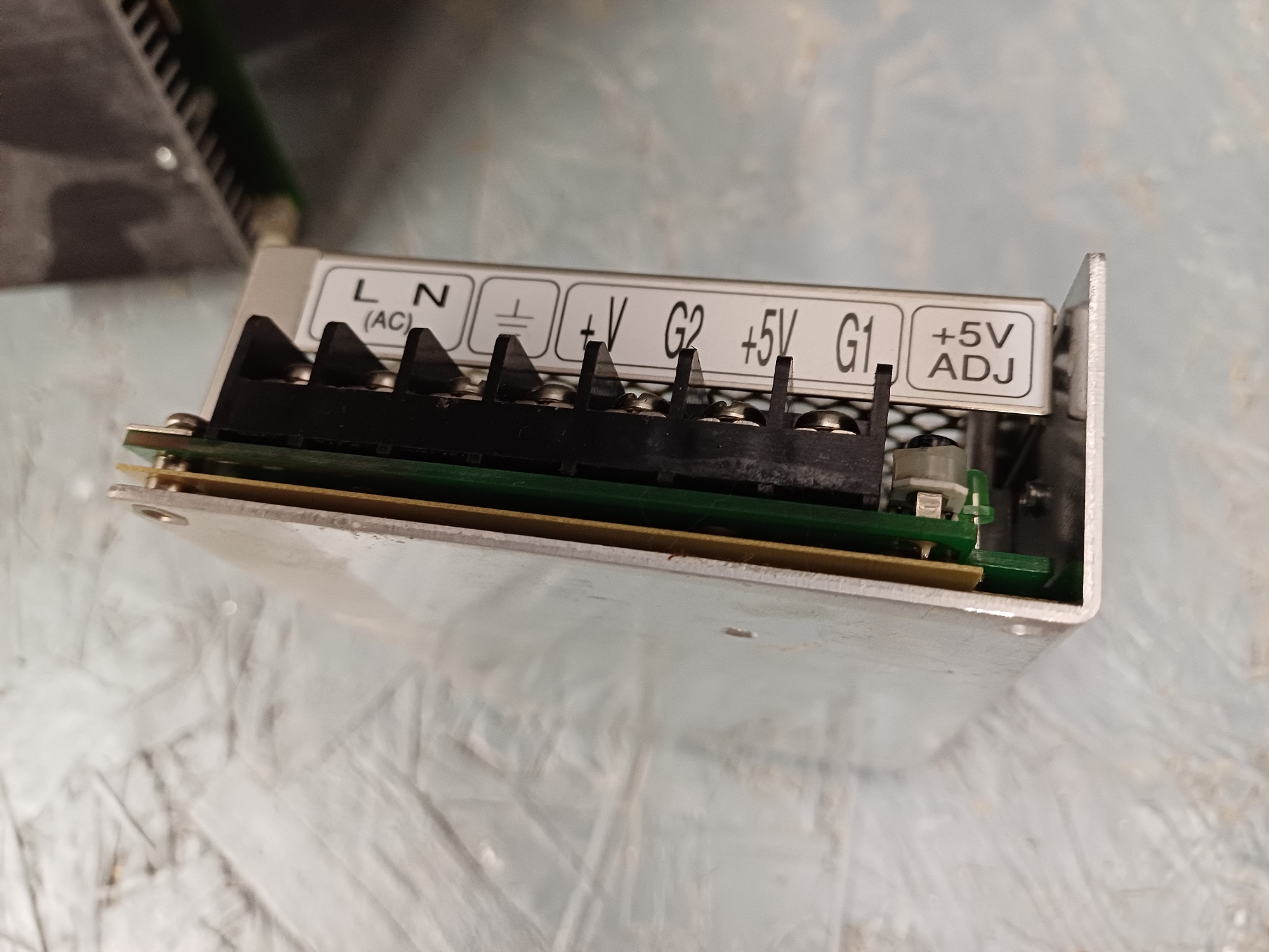

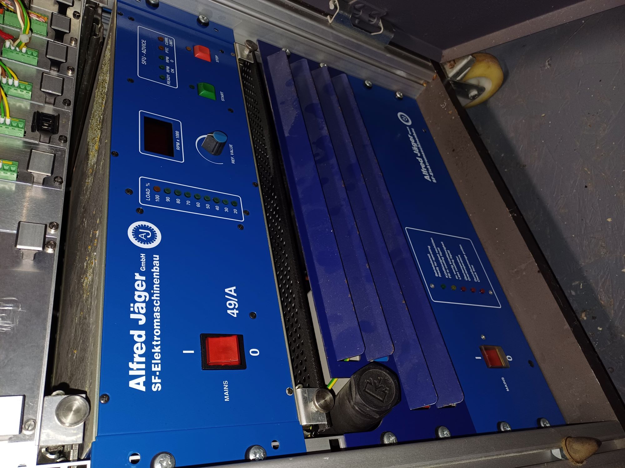

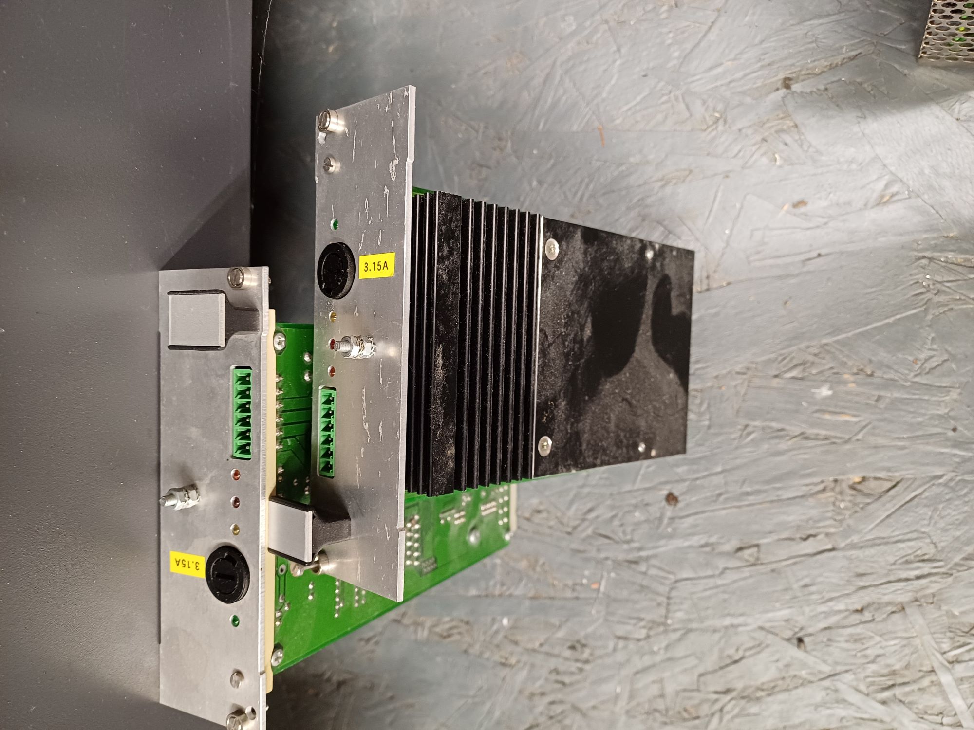

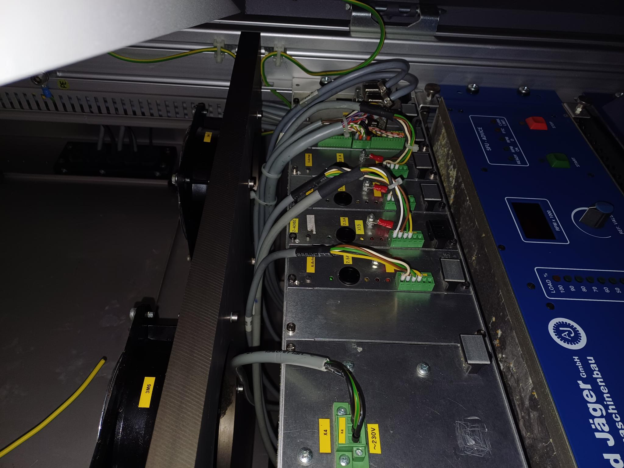

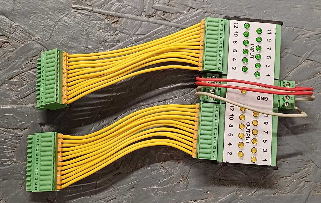

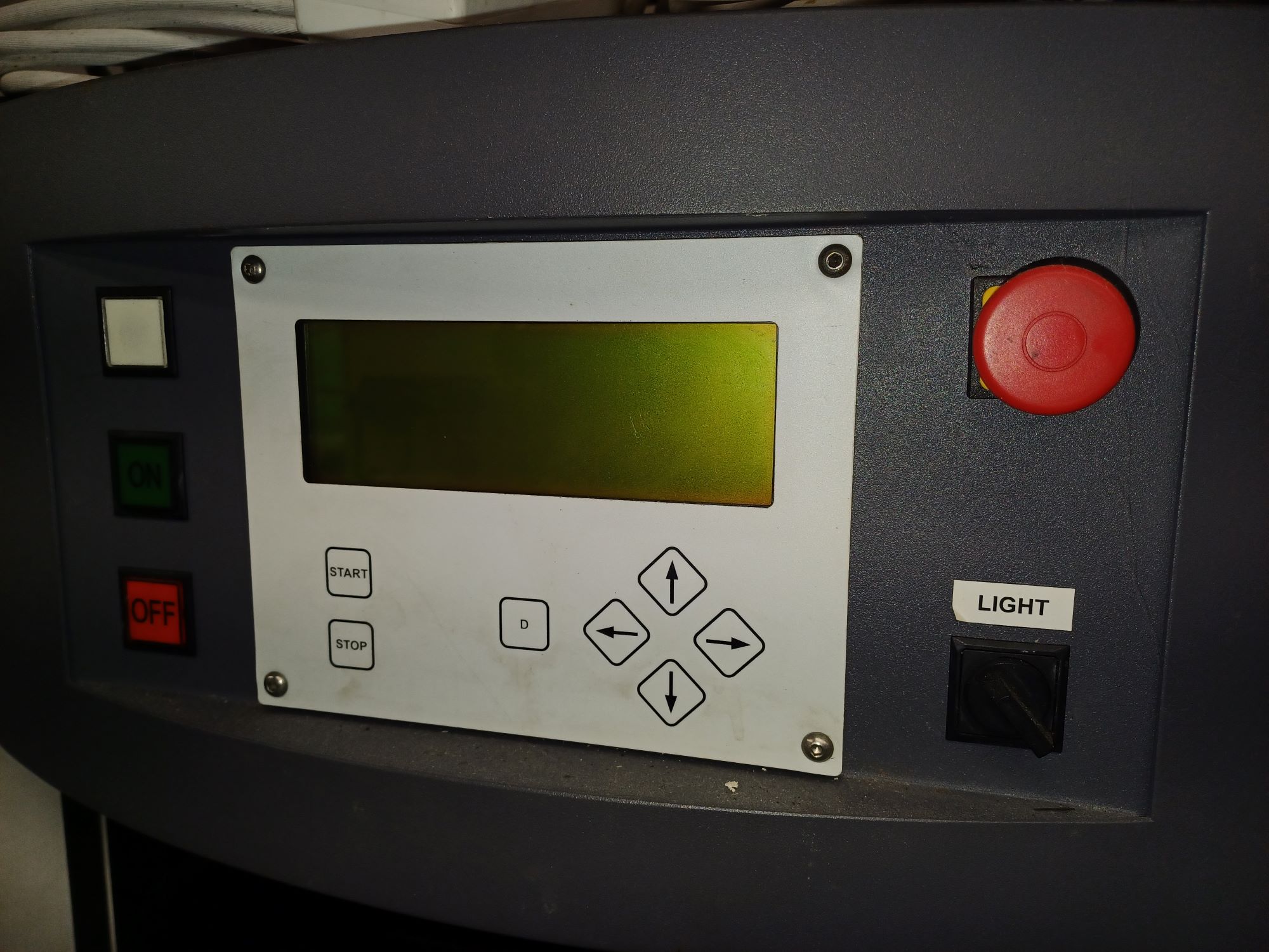

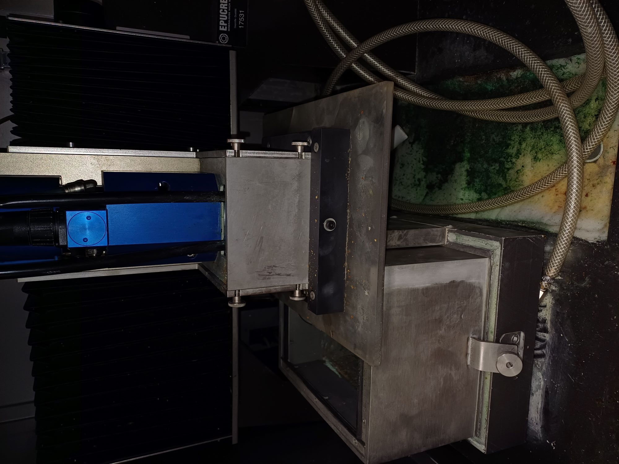

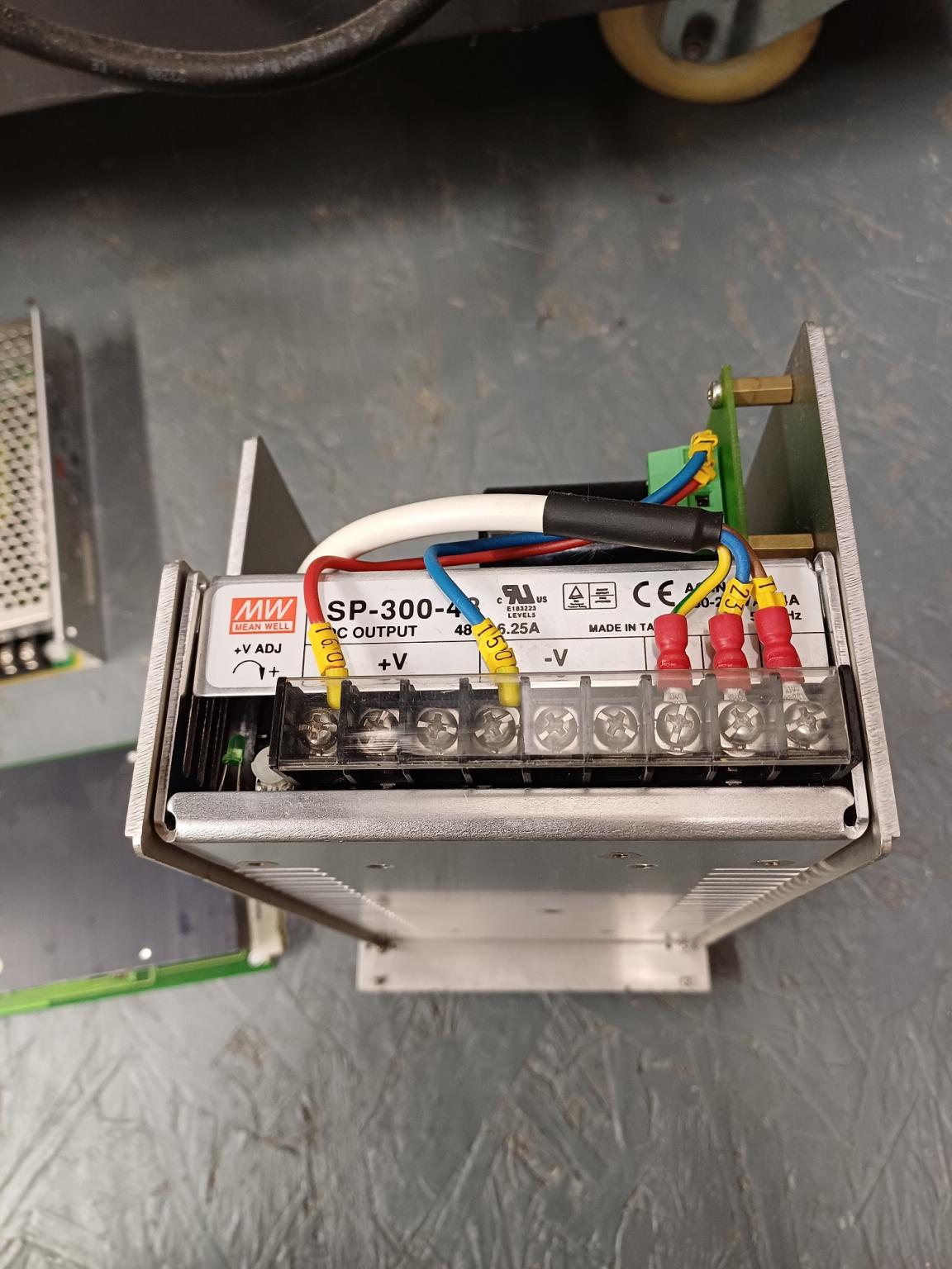

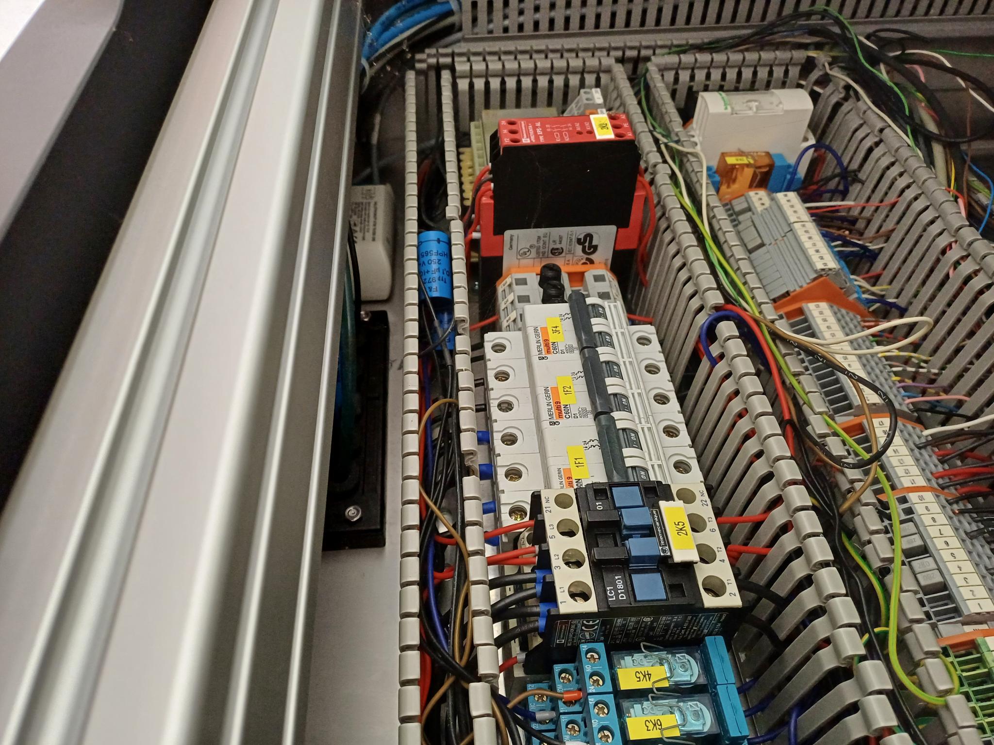

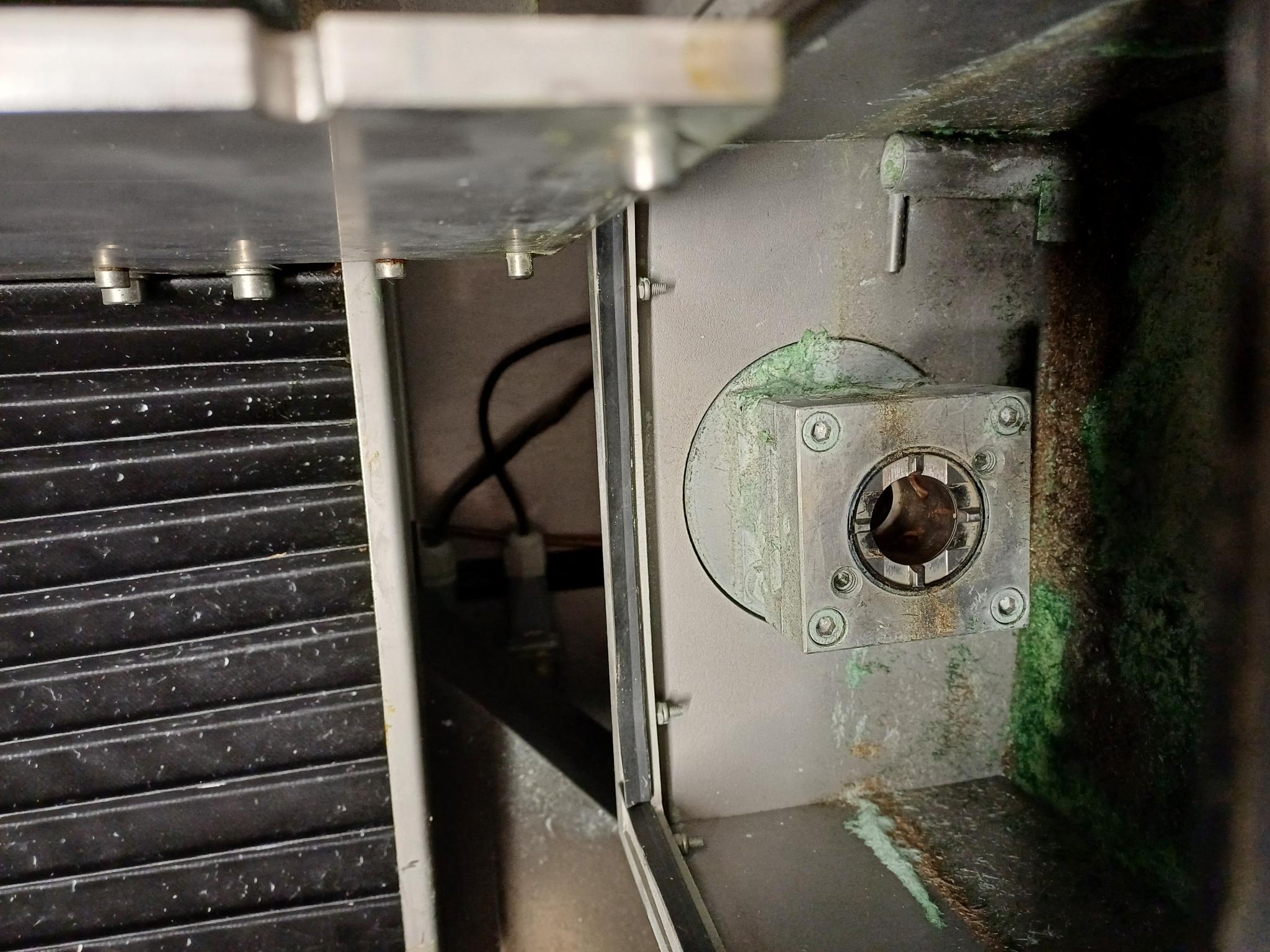

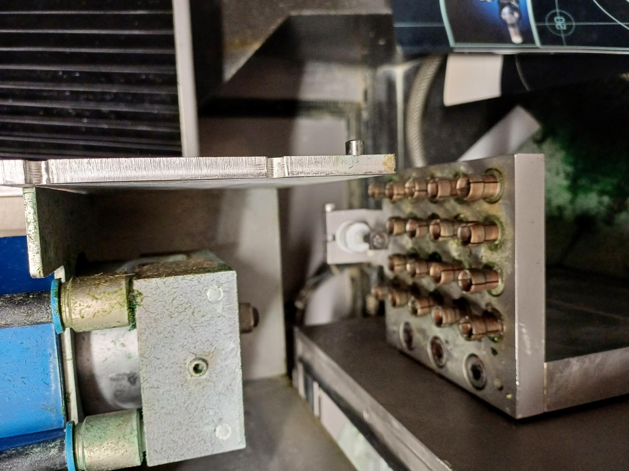

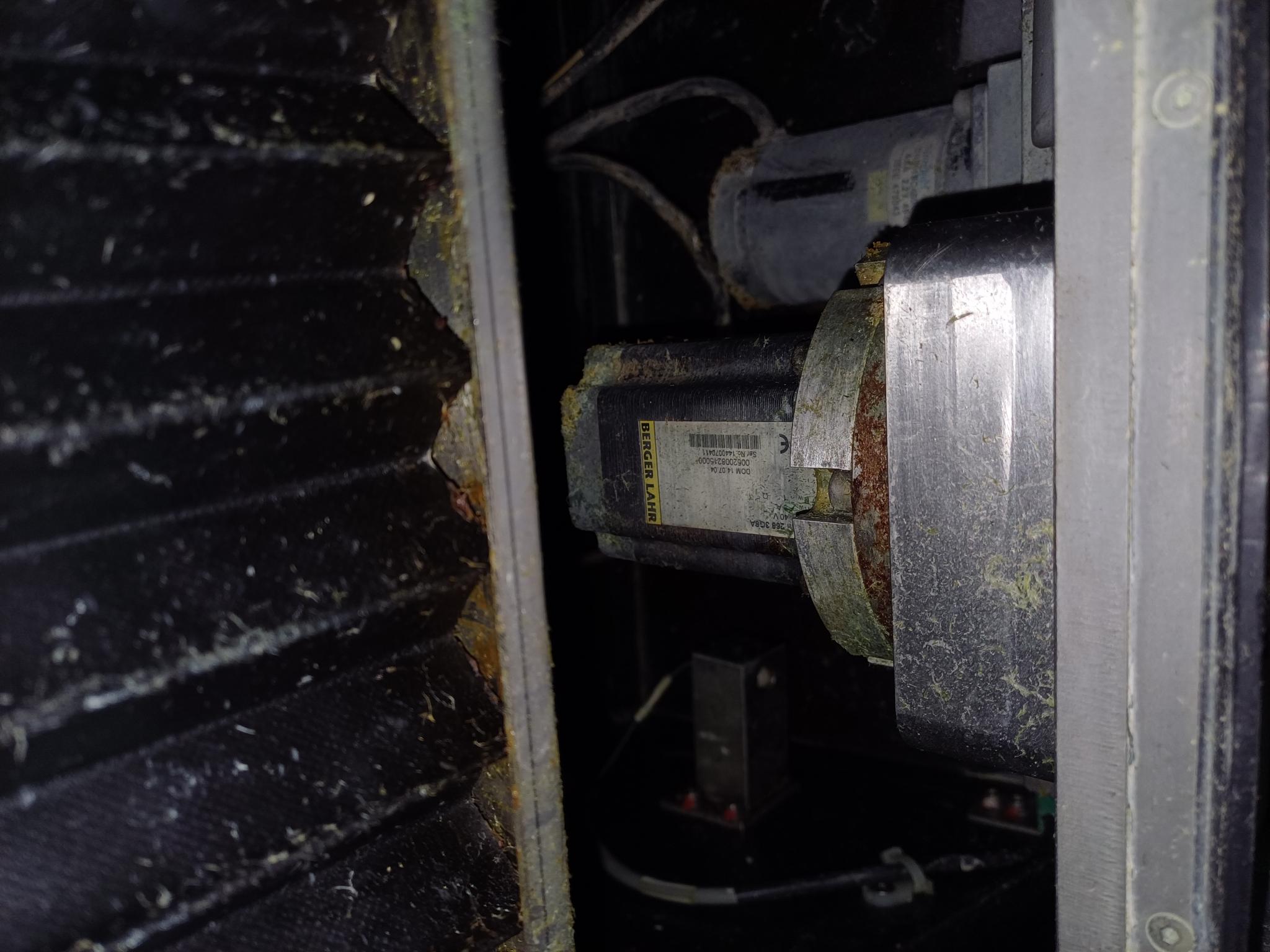

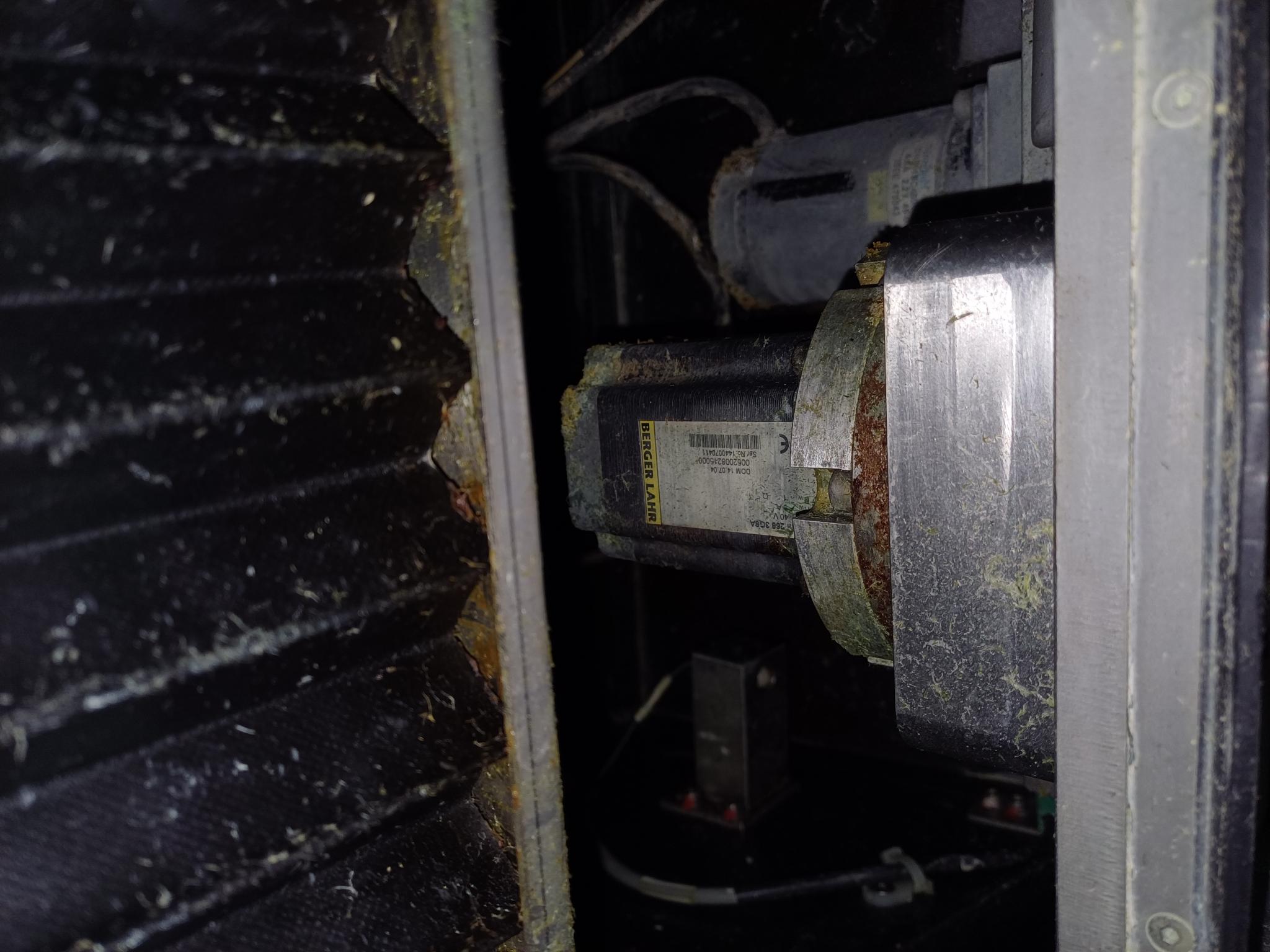

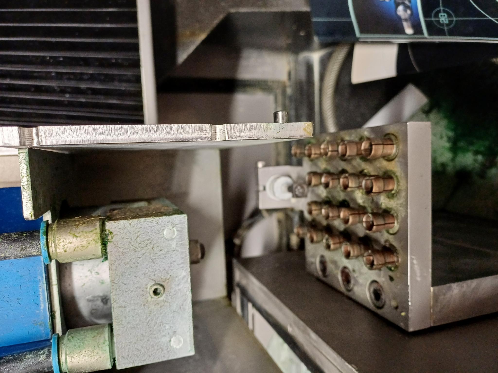

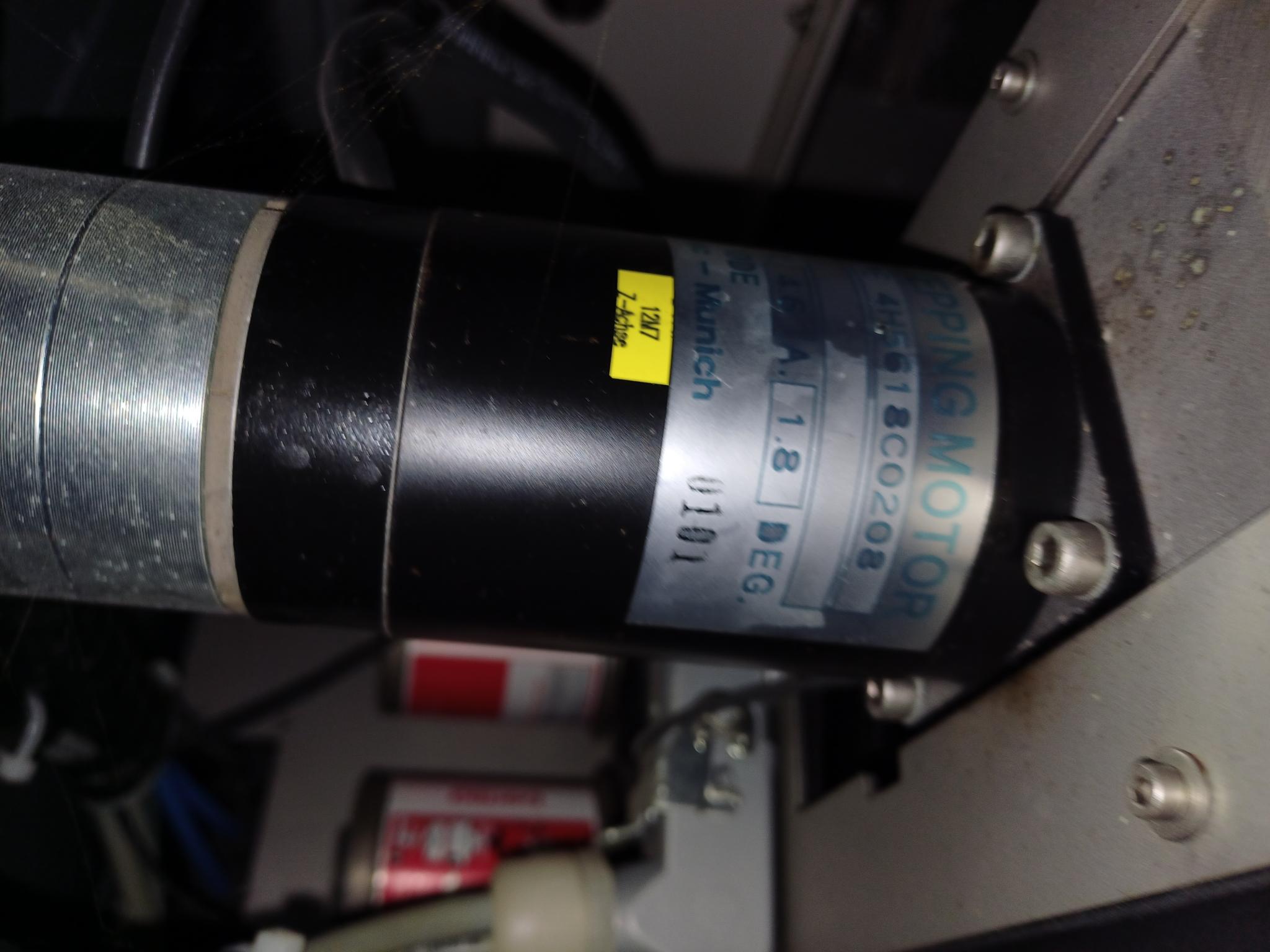

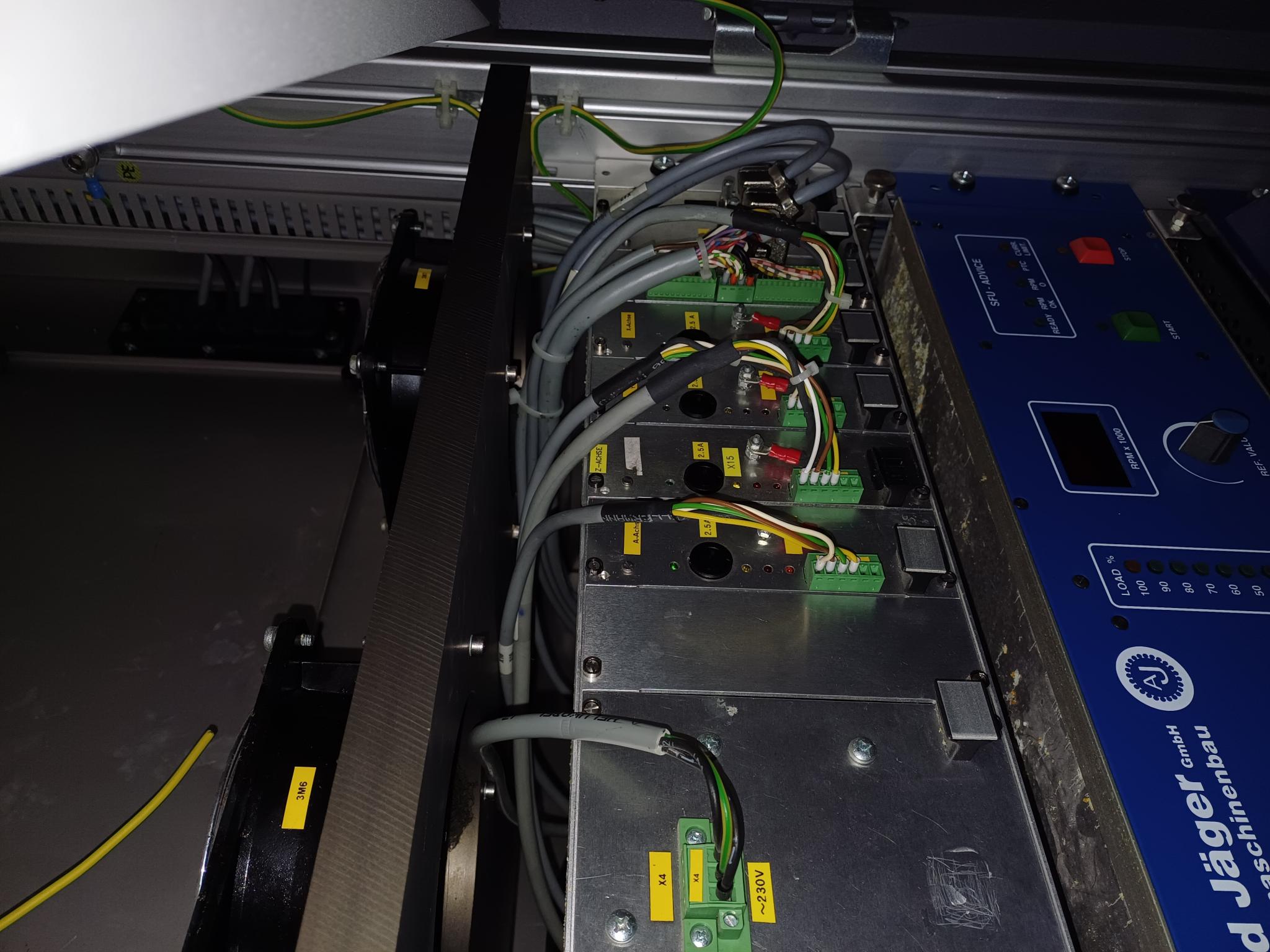

15 Attachment(s)
Re: Granite framed dental milling machines
I have attached below some additional pictures which may be of help. They show the tool plate adjacent to the machining area, as well as drives, spindle control, Y and A motor location, the spares and so on.
I hope this helps.
D
Attachment 32503
Attachment 32504
Attachment 32505
Attachment 32506
Attachment 32507
Attachment 32508
Attachment 32509
Attachment 32510
Attachment 32511
Attachment 32512
Attachment 32513
Attachment 32514
Attachment 32515
Attachment 32516
