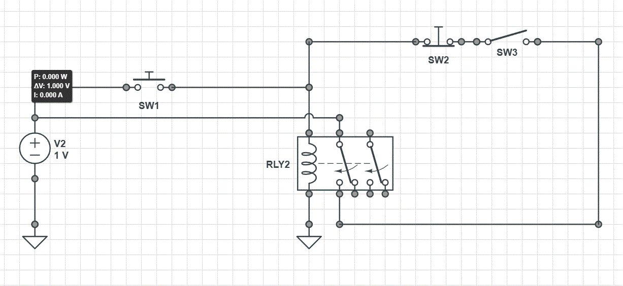

On the smaller machines I've built controls for, I have the E-stop 12/24vdc loop powering whatever relays/contactors I need for the various power supplies, with that 12/24vdc also going to an input on the controller.
The E-stop loop can combine various other switches. Some include limit switches (there's arguments for and against this!), driver error signals (again another argument, as you can just take them to the controller to be handled), any overtemp sensors, but if you have the controller inputs available, then you can wire those direct to the controller for easier fault finding.

I've not got any wiring diagrams to hand, but here's a quick one I've thrown together.
Attachment 32700
I generally use DIN rail mounted 'ice cube' relays for this.
SW1 is an enable button, when pressed it energises the relay.
Then the loop through the relay contact and SW2/3 (whatever you want in the E-Stop loop) then provides power back to the relay coil to keep it enabled until either power is removed completely, or the E-stop loop is broken.
(And I've just realised that I should probably have drawn the diagram with the enable button feeding into the opposite side of the other switches, so that the relay can't be enabled if there is an active E-stop)
You can then use the other relay contact to power whatever you want powered. Either directly if the load is small enough, or to power further relay/contactors.
