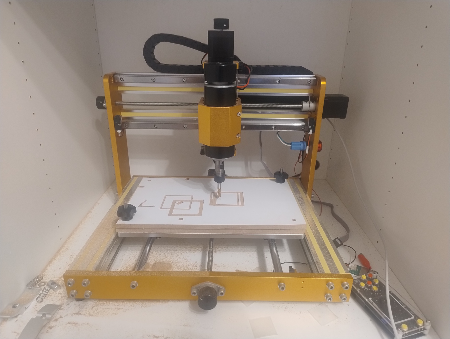

Thank you for checking this out. I managed to flip the controls and it looks OK IMO. I will give it a test today and see if it really is right. I've only done a few test cuts as you can see from the picture. Baby steps... :)

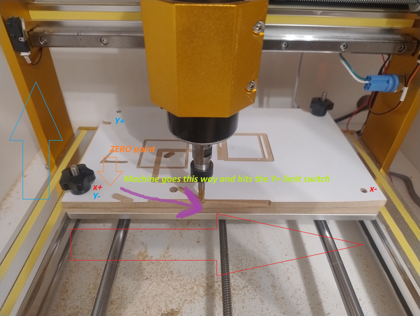

I have an entry-level license for Deskrpoto, so that's my CAM software. For G-code I am using UGS. I fixed the directions, but the image is flipped and instead of down left as a zero point, machine starts on the uper left corner an does the image upside down if I am facing it. Also, zero point on the suface doesn't work for me. I need to figure these parameters out.

If your controller is using GRBL, then there are settings in GRBL to reverse the directions of travel - its simply a question of typing a value into the settings - There is a lot of information online how to do this. Try this: https://github-wiki-see.page/m/gnea/...-Configuration.
Note you can set many parameters in GRBL - taake care, ,and check what you are doing.

Yes it is using GRBL, thank you for the link, but I don't think that's the problem. The machine jogs correctly with $3=5. I came to the conclusion it's my CAM software that uses a different coordinate system. I need to correct the settings there. Machine is fine in my humble opinion.
