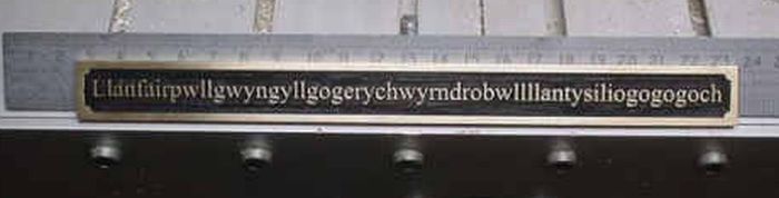

How does the Vectric software cope with engraving ? I only need simple name plates.
Do you have any experience of this ?
Many thanks Nick.
Re: O.k. So whats the best software set for a small cnc mill ?
Nick,
This was done in V Carve
Attachment 2274
Sorry about the poor camera phone pic.
