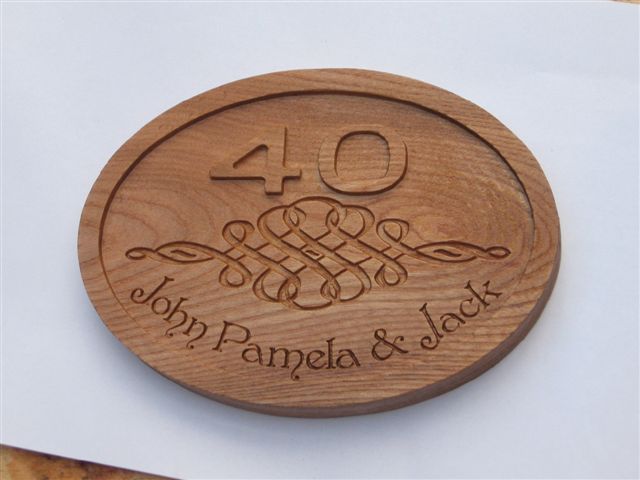

Attachment 2389hi
cut this sign tonight with my router , wood is elm pocket was roughed with a 8mm mill end finished with a 3mm mill end, engraving done with a 30 deg engraving bit , v carve pro software . took me over a year to build this router but its been worth it
