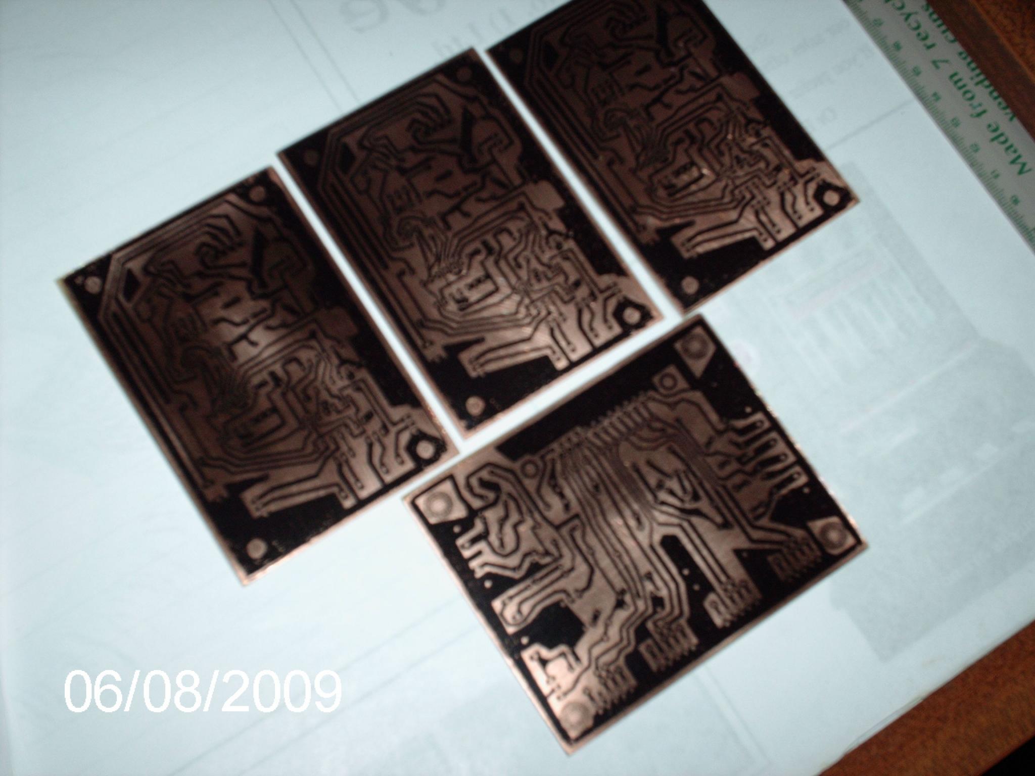

I have been experimenting with toner transfer to make my boards and have found cheap inkjet photo paper in my local £1 shop that as worked nicely,found that if i used 4"x6" paper stuck to a A4 sheet it was the ideal size for my boards.Haven't got a laserjet so went to local library to get them copied - explained what I was doing and they were most helpful.Used washing up liquid to clean board,put a spot on the board and rub in with finger then wash off under tap then dry with paper towel,making sure not to touch with hands.Tried using iron but didn't work too well so I fed them through a laminator about 10-12 times and this worked great (was only single sided board so not too thick)let them stand for 5 min then soak for 20 min and the paper just peeled away.Used a scotchbrite pad for initial cleaning and for removing ink after etching,tried acetone but too messy.
Attachment 1601these are some of my early attempts before etching,all now populated and working!
Hope this might be of help to anyone deciding to do their own boards.
