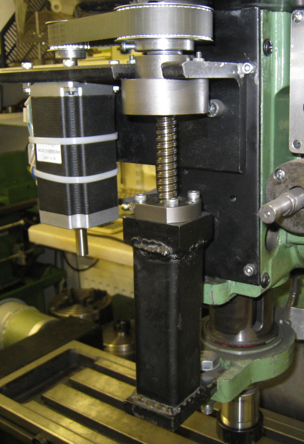

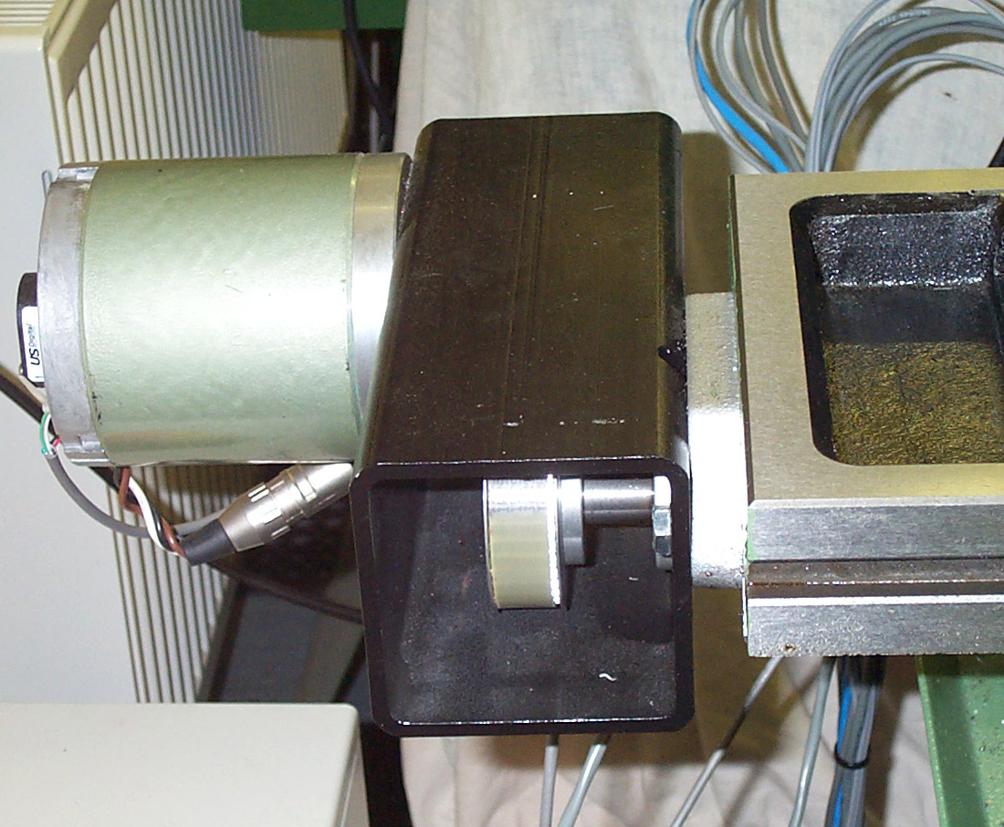

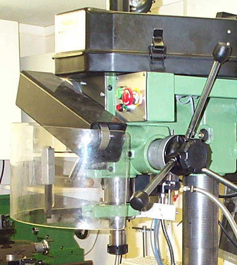

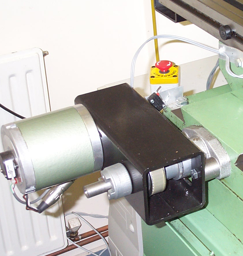

Servos fitted to all three axis in 2004 with original drive screws, changed to ball screws in 2007 and also changed the Z axis to a stepper motor and fixing position as shown in photo.
