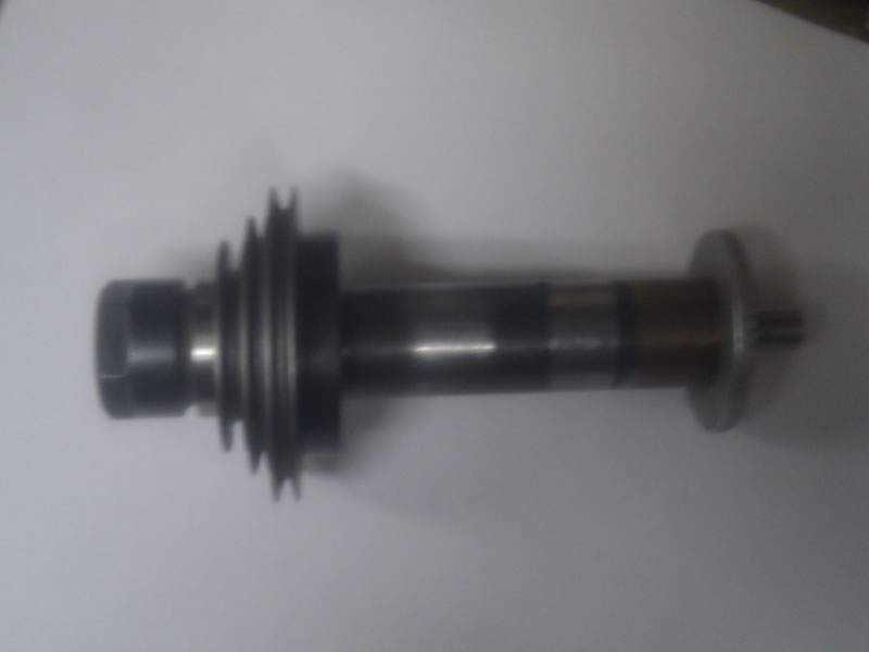

So you want a cutting spindle basically.
Have you thought about a round belt drive as used on the old engravers
Tony at lathes.co.uk supplies the belts made to measure
Something like this in the attached poor quality picture
Attachment 3388
Very quiet and can run all day this is from a Taylor Hobson i was going to mount it on my mill for engraving, but i might get a water cooled spindle instead, it will be clamped in the middle part
