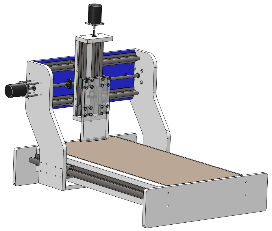

Right now I consider going for TR12x3 single start just to be sure. I'm in the planning stage of a simple DIY cnc, so I'm not locked to start 2 in any way. I'll attach an image just to give you an idea, the xyz axis rails are 800mm x 500mm x 300mm, and hopefully I can cut some wood and plastics with it.
Attachment 3444
