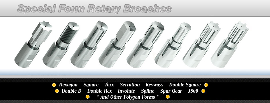

With Rotary Broaching it is possible to broach such forms as:
- Hexagon
- Square
- Torx
- Serration
- Keyways
- Double Square
- Double D
- Double Hex
- Involute
- Spline
- Spur Gear
- J500
- And Other Polygon Forms
