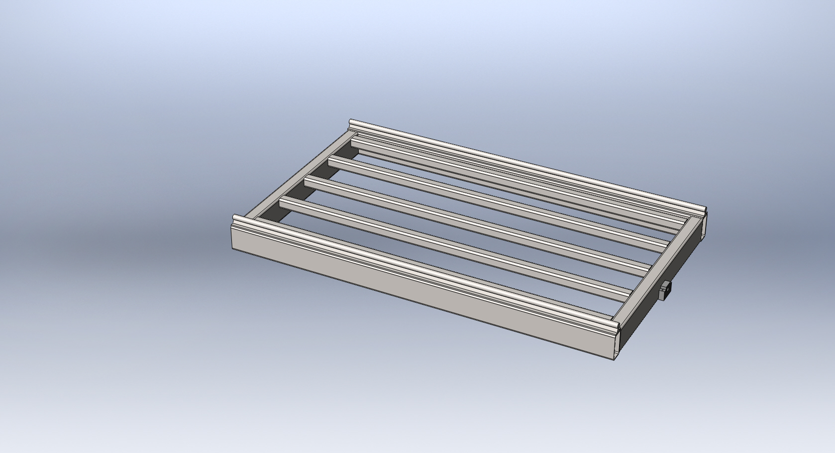

Attachment 4357
X Rails are 1500mm 20dia supported. Y is 800mm 16dia supported. Z is 300mm 16dia supported.

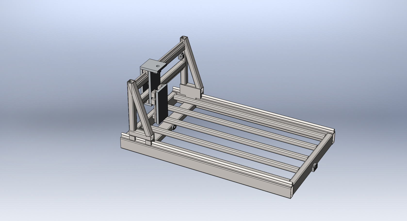

Attachment 4359
Outer section is 100x50 Steel Box. Bed supports are 40x40. 20mm x 5mm pitch ballscrew will be in the center of the frame.

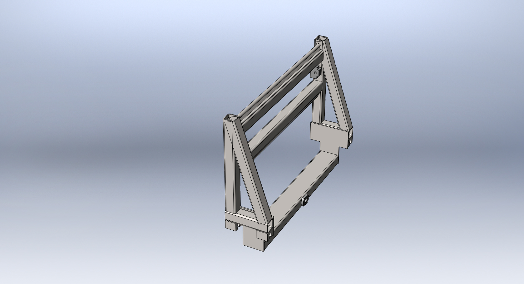

Attachment 4360
Gantry is 50x50 Steel box. The strut at the bottom with the ballnut is some more of the 100x50. 16mm x 5mm pitch Y Ballscrew will run between the 2 horizontal 50x50 Y Rail supports.

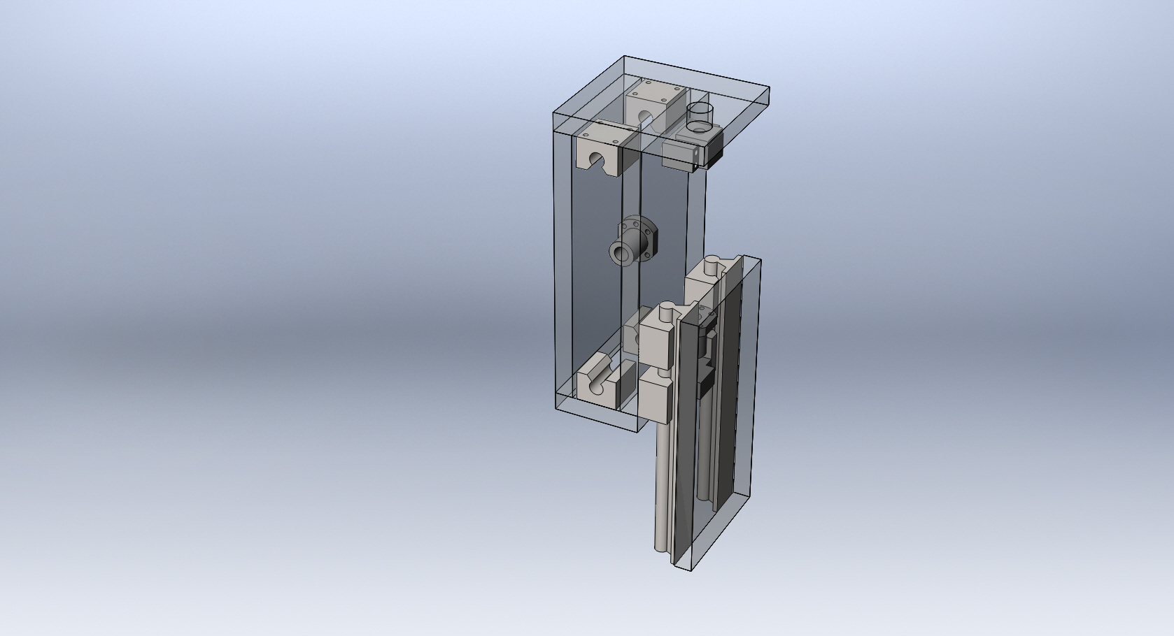

Attachment 4358
Z Assembly is 300 x 150 x 20mm Ali plate with a 16mm x 5mm pitch Z Ballscrew. Approx 190mm Z travel.

I am not sure if my steppers will be up to the task of moving the heavy gantry around, I would really like to be able to take some pretty fast and aggresive cuts on wood and acrylic, I'm thinking quick direction changes in the X direction might be a problem?
Will I have problems with the X and Y leadscrews whiping?
I'm using the same steppers for my machine which is bigger so probably heavier and they work fine. I used 10mm pitch, which helps as 1/4 the K.E. in the screw and on the X-axis rotated the ballnuts which helps even more...If you want high feedrates then get 10mm pitch screws and ideally timing belt/pulleys not direct drive to get the optimal ratio. I'm running the motors on 75V which is necessary to get high enough torque at high speed.
Stickio
Depends how fast is 'pretty fast'! Y will be fine. If you use 10mm pitch screws then the RPM of the screw is of course halved, so you can go twice as fast before whipping.
X is 1500mm with angular contact on one end and single bearing on the other, 5mm pitch:
(approximately)
16mm diameter critical speed is 5000mm/min
20mm diameter 6000mm/min
25mm diameter 7700mm/min
Double those if you use 10mm pitch. Those feedrates are achievable with the 3nm motors .. I got much more.
On that size machine I would *definately* go for two screws on the X-axis to prevent racking especially as you want to take 'agressive cuts'.
Your Z axis linear bearing blocks look too close together for that travel.

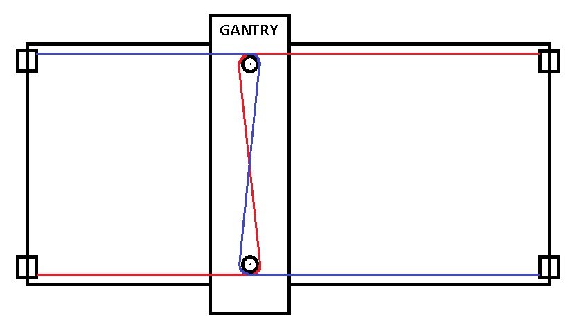

If you don't want go spend a lot on another stepper/driver (fair enough) then why not link the two ballscrews with a pulley on each and a timing belt. Ideally 3 or 4 pulleys with the motor in between so that belt stretch is even... easer than the cable method I think.

For those who have not seen it before here is the pully system I was talking about.
Attachment 4367

I reckon the pulley diagram you posted wouldn't work very well because the acute angle between the crossing wires is very small. Too tired to calculate it properly now, but I'm pretty sure you'd want the same sort of thing but with one pulley on each corner of the frame, like on a drawing board ruler...

I dont think you would have any problems with racking if you have a single drive on the x axis. Your gantry is identical to mine and I get no problems even on aggressive cuts.
I dont see any advantage of a 10mm pitch on the z screw. x and y speed are important but how often do you need to plunge into the workpiece at high speed? With a 5mm pitch you will not need a brake (or a spanner).
It looks good to me, but then I'm biased :)

Z Assembly is going to be changed a bit to reduce flex, I will be increasing the distance between the bearings and extending the front plate holding the router. The stepper and ball screw will also be mounted there (I will post up a new drawing soon).
