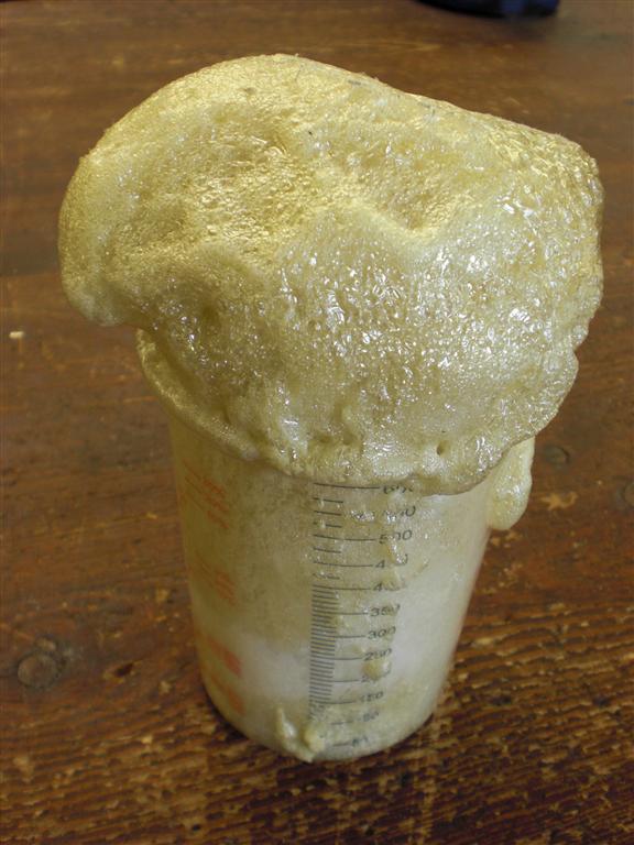

I was going to suggest that. Two part polyurethane foam is good as you can just make a box the right size, work out the mass to mix to get the right density and fill it up. You do have to be quick, otherwise this happens:
Attachment 4541
You can get it in decent quantities here:
http://www.ecfibreglasssupplies.co.u...hane-foam.aspx
I keep meaning to get some myself for prototyping.
