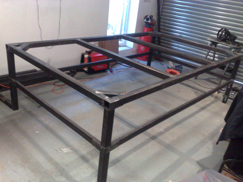

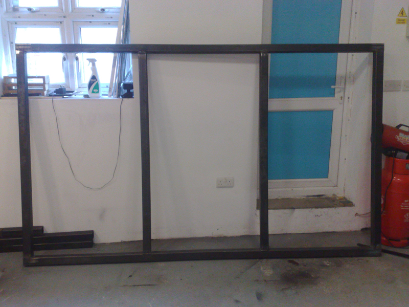

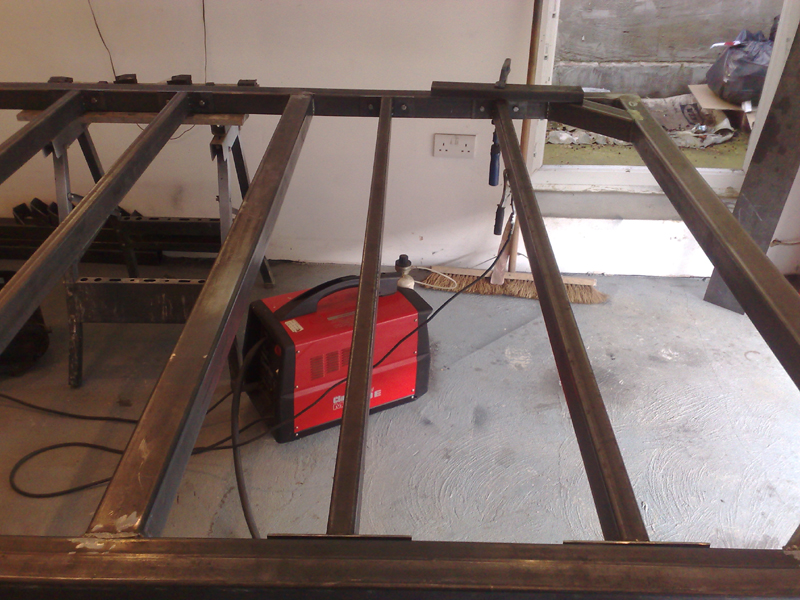

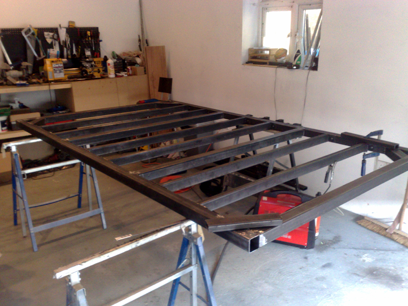

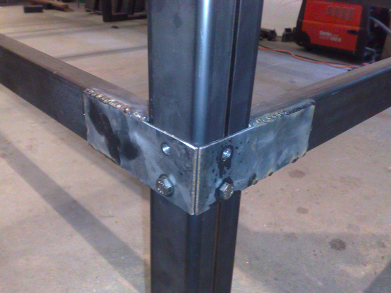

I've got another thread regarding my attempts at building my router but it's not much of a log so I thought I'd start a new thread.
Old thread: http://www.mycncuk.com/forums/showth...where-to-start
I need my machine to cut complete sheets of 8 x 4 so the actual size of the machine has grown into a bit of a beasty..it's now ended up at 9' x 5.5' which will pretty much fill up my shed.
I've got the bed completed and I'm now 90% of the way to completing the legs and base section.
I need to add base plates to all the legs and make a couple of cross sections to join the longest supports and stop them from flexing.
I'm hoping to get them done by the weekend them move it all into the shed.
No laughing please at my welding skills :lol:
